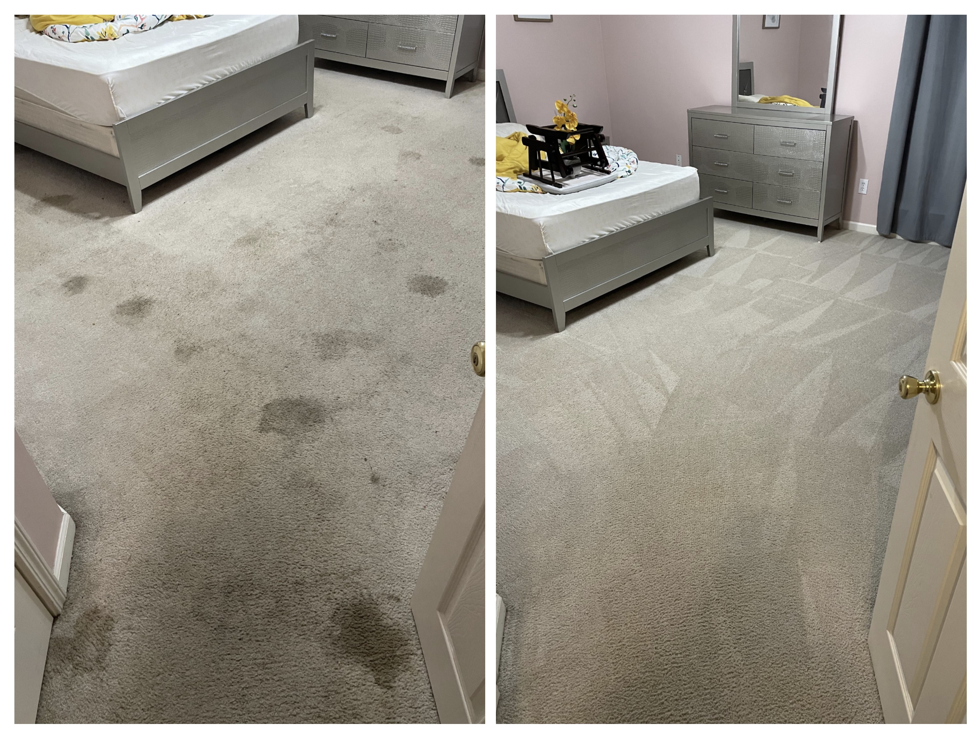

Well … the story is that it’s a rental that we cleaned 18 months ago and this lady moved in at that time. Brady did the job and told me it was trashed. He had to RV it and P-Sor it …. It was horrible.
Anyway, the lady thinks it’s old soil coming back … 18 months later.

Nice before and after Marty good job.

How I figure it out was when I first went into the room with the customer I said “oh man… what kind of dog do you have”? She said “I don’t have a dog.” “This all came back after the last guy cleaned it.
I think it wicked back shortly after you had it cleaned and she just tolerated the spots for 18months

1st Larry great observation on the dresser. Yes kinda creepy.
2nd Marty did Brady or yourself use a black lite to confirm and deny the clients ignorance ?
3rd -No biggie you did a superb job , let the slob pay thru the nose next time also...
4th -definitely pet stains ,next visit look at him tell him look Doofus ,I been doing this for decades now smile as you tip me !
