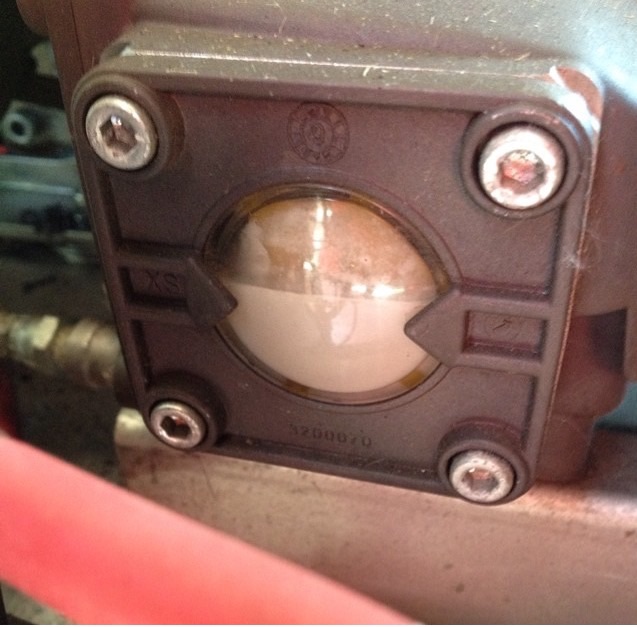

Did it look like this?

While I am no rocket scientist, I don't think that looks good.

Oil is stinking cheap. Change it twice, now, and after 30 minutes running.
If you leave the water in it for any length of time you get that milky emulsion that won't drain completely the first change.
