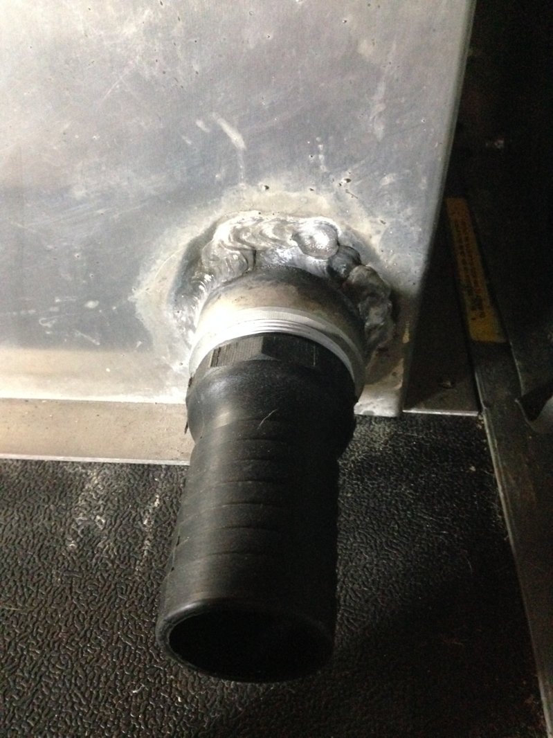

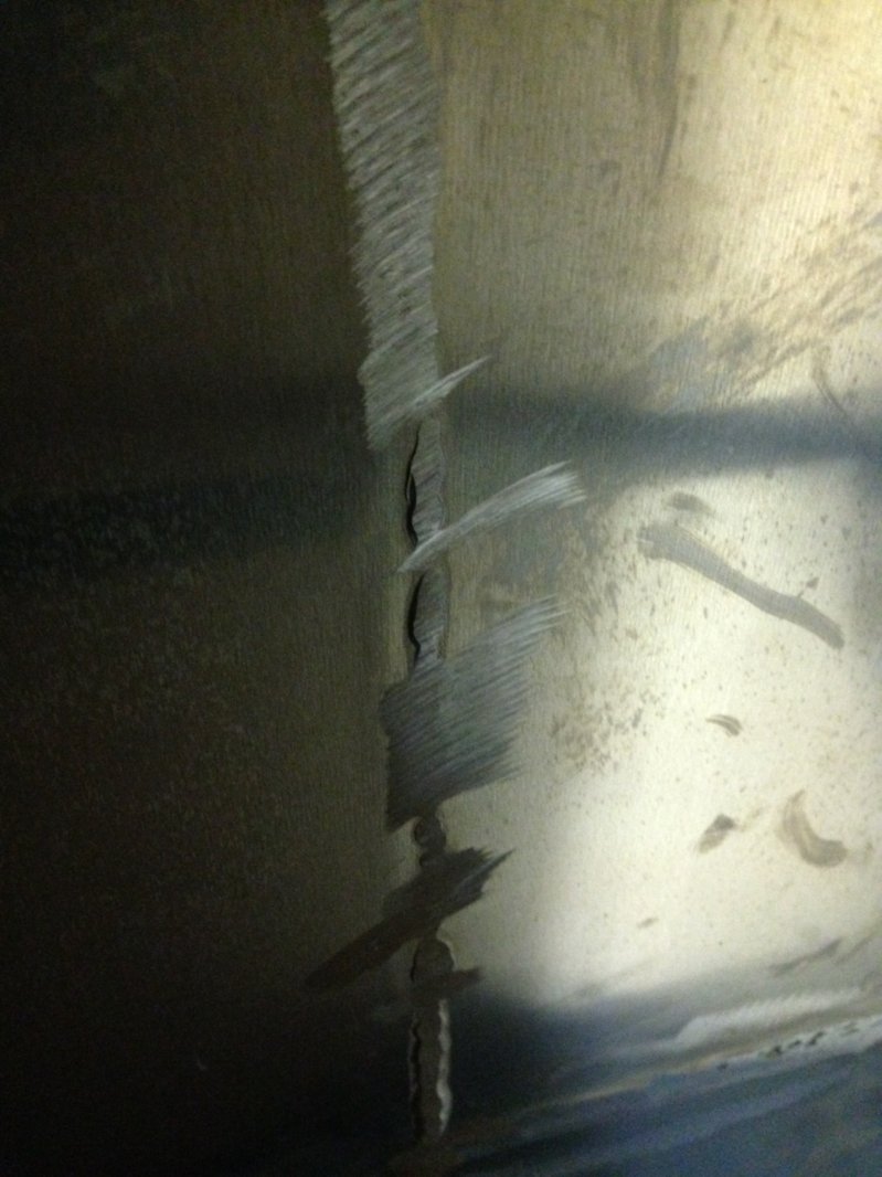

I just got a new waste tank and Im curious if any of yous think this lid may give me trouble being on the larger than tank side. Also Im wondering if I need to worry about the weld job in pic 2. Looks like a missed area. Guy at the company I bought it from says it was tested and he dosent see my crack (crevice) in the pics I sent to him. Is the flexing of the tank going to give me problems down the road? He says Im worrying about nothing. How would you handle this issue?

Im most concerned with the weld job with the crack/crevice showing. Im worried that the flexing of the tank when suction is on may cause it to split then possibly cave since its right where the blower fits up to. I really dont know. Maybe the guy is right when he said,"I think you are stressing over nothing".

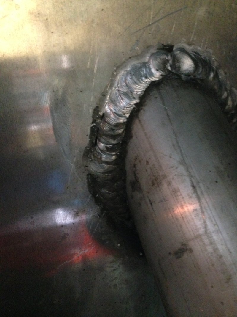

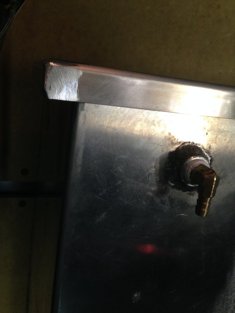

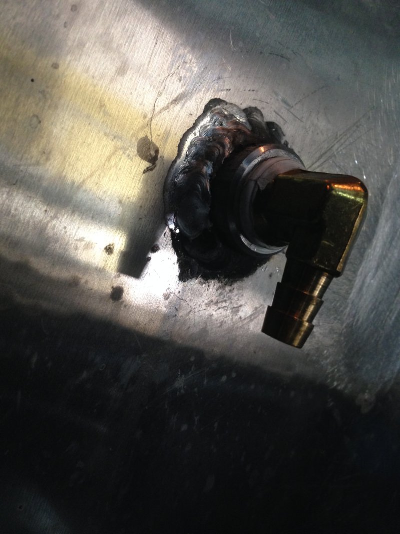

I told them I wasnt a professional welder but I thought it looked like a bad weld job.

Yes, is my short answer.. If I ordered that tank I would be VERY upset!! Why should you take any loss on this deal?
I went to tech college for welding, it was just a 1 year program.. I will say aluminum was the hardest thing for me to catch on to.. Aluminum doesn't show heat while you're welding so it is really easy to blow through it. He blew through the tank and there are already holes in your tank..
As Dan mentioned it was mig welded and mig is fine if your good at it, tig welding looks alot better..
Does your tank have baffles in it?
I you're stuck with it, take it to a good welder in your area like Shane said..
As your tank is right now I would not use it.

Maybe some chipping with Flux core and stick(love stick for thick metal)..
The "grinding" was him just embarrassed of the look of his welds(happened a time or two for me):eekk:..

It is a bad job period and you shouldn't be out any money.
The worlds are ugly but as long as they aren't leaking they should hold up fine.
The lid not fitting would piss me off the most. Does the tank have a horizontal ledge all around for the tank to sit on and make a good seal?
And how much FLEX does it have.
