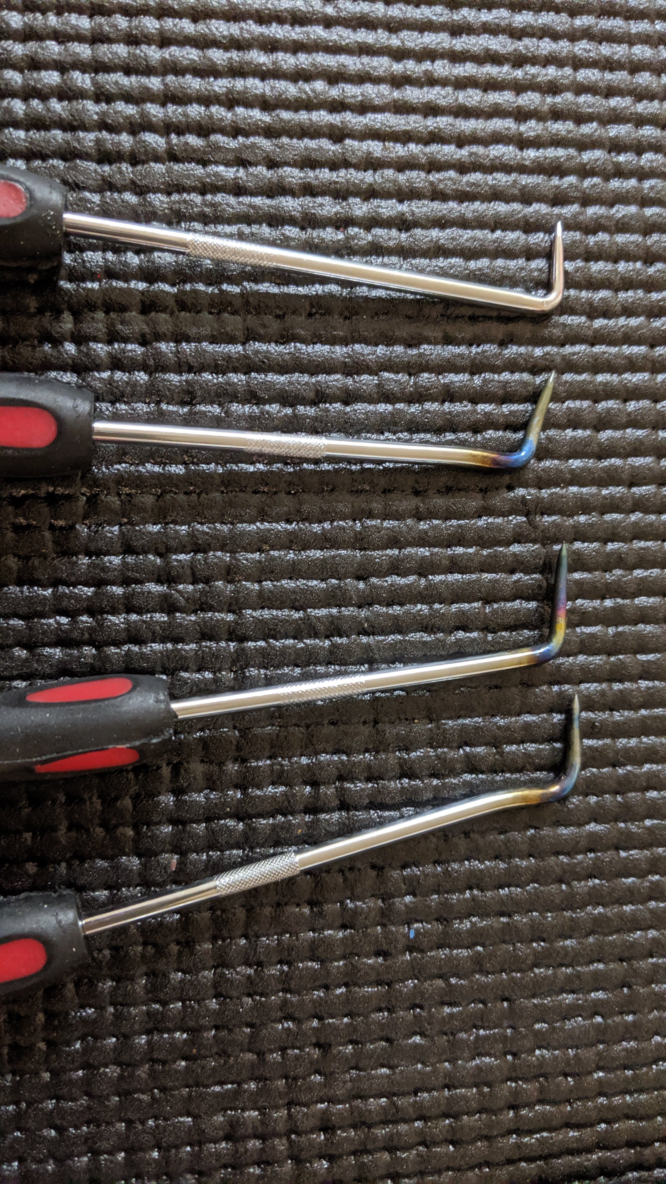

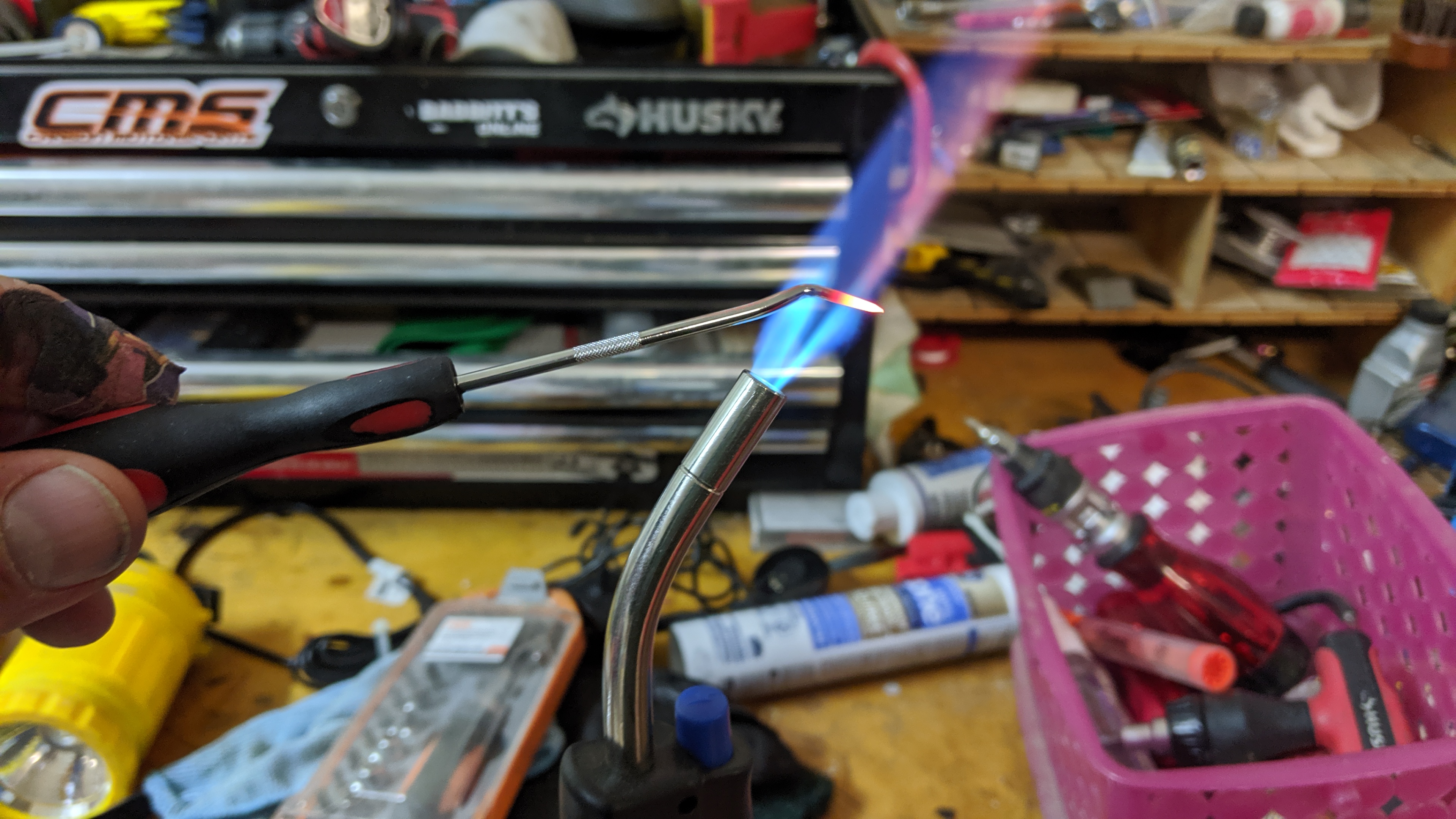

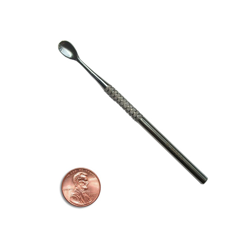

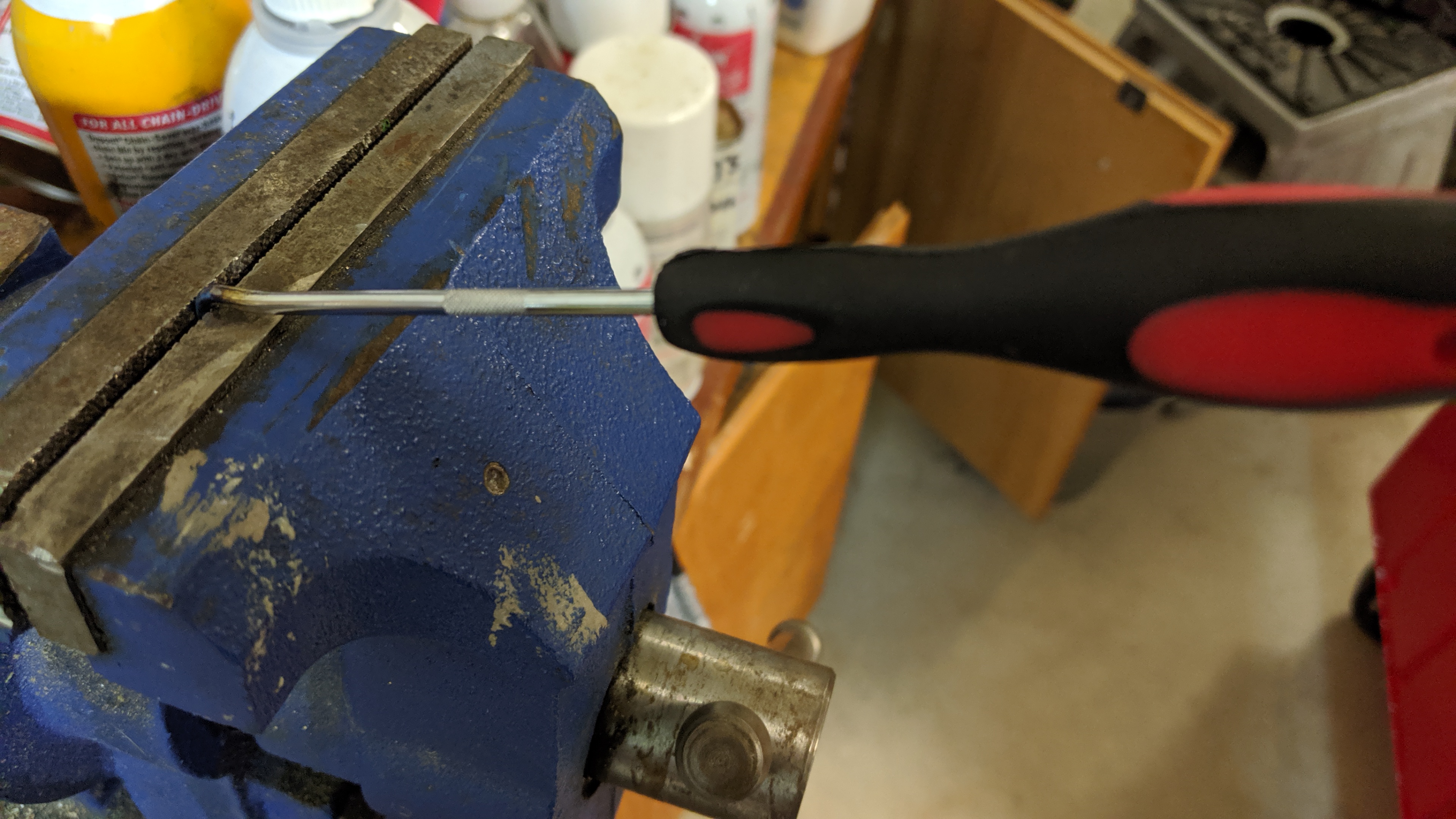

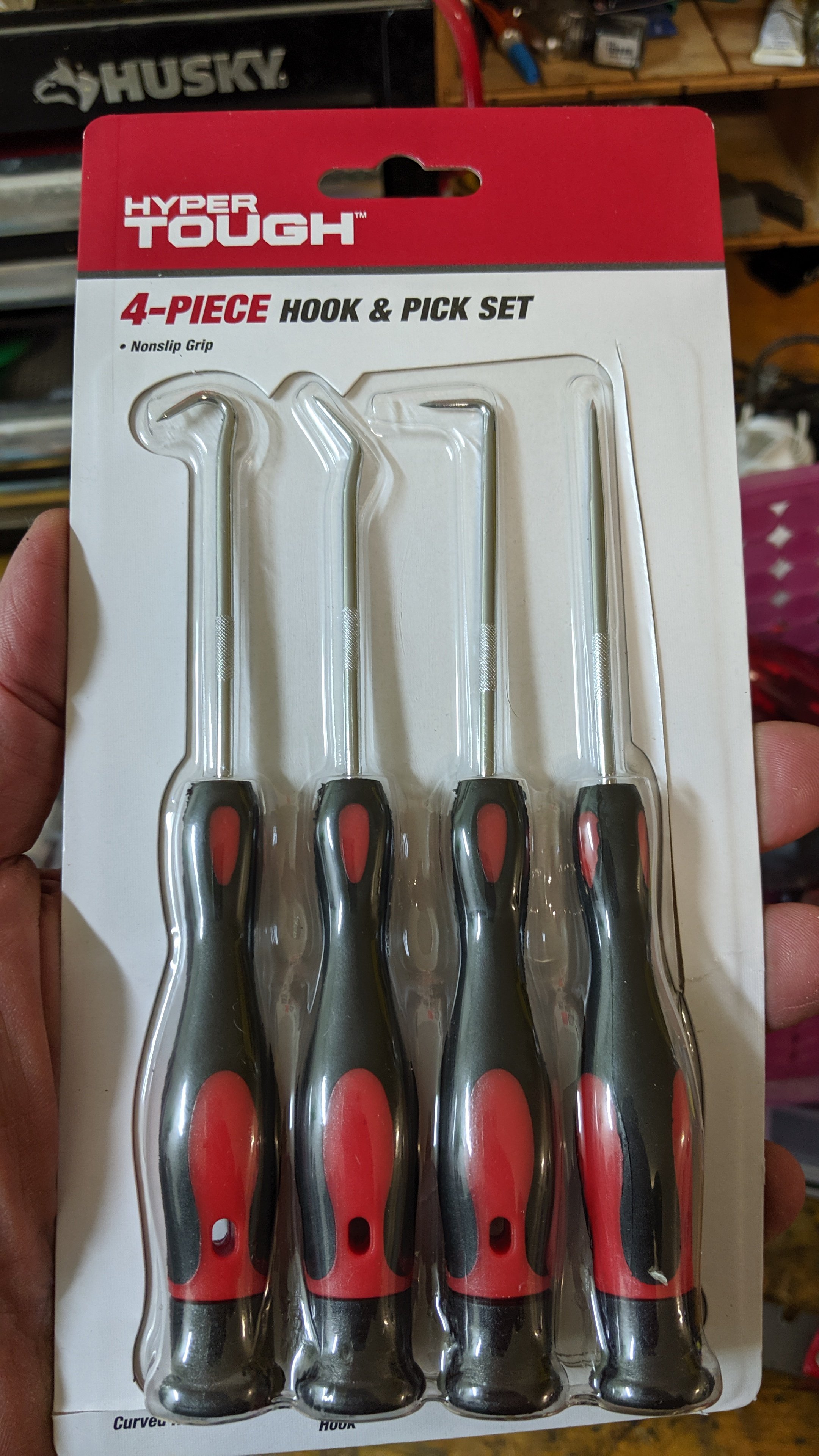

I think my dentist has that same set.Invaluable for us soap scumbags...View attachment 96642View attachment 96643View attachment 96644View attachment 96645
Tap the end flat like a little paddle, tuck it slightly forward. Then file an edge on the back, to make a small scraper. It will grab crap like you won’t believe.
Im having trouble visualizing what you're describing and in the mean time I just booked 3 more showers...![]()
