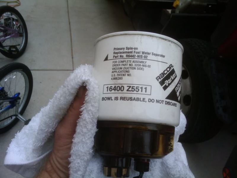

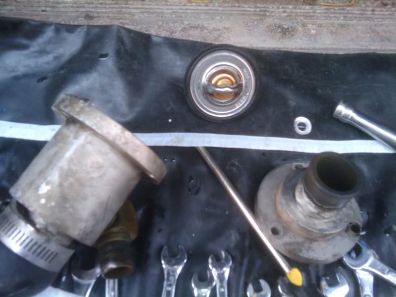

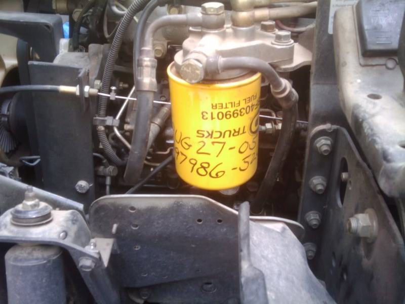

Decided to start with the easy stuff first.
I replaced the fuel filter. After spinning it loose I noticed a date of August 2005
Then, removed and cleaned the sedimenter
Also, replaced the thermostat
Then, dumped in a pint of deisel fuel additive (didn't see the Lucas so had to settle for Prestone).
Now, this truck runs better than ever!
It's smother, quiter, and the cab and fresh water tank heats up faster. Well worth the few dollars it cost for parts.
