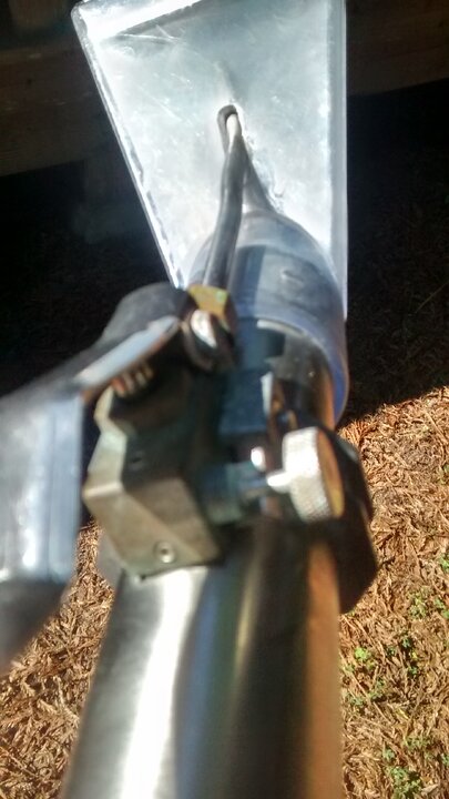

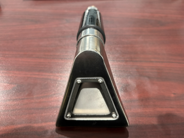

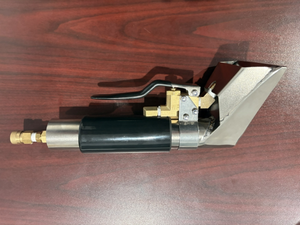

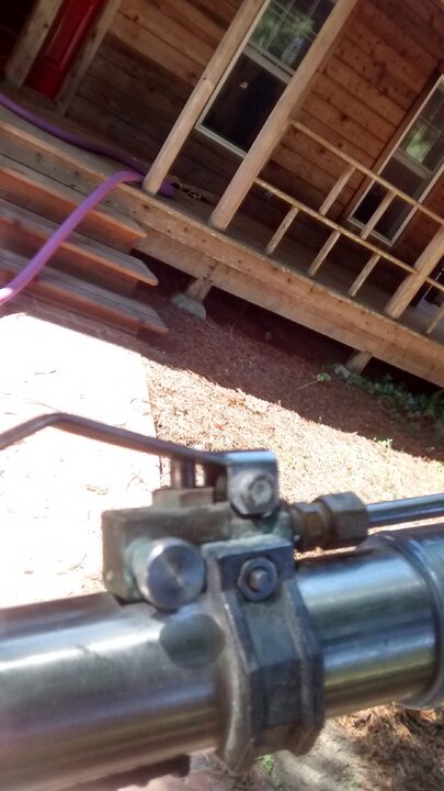

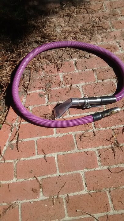

Too bad it doesn't have this valve, i really don't care for this tool. And only use it on the rare occasions that i have to do an auto or rv interior. What i really really really love about it is that it has an continuous adjustable bypass. It keep the solution super hot all the way up to the valve itself .
The stainless needle valve on the side manually controls how much solution if any is bypassed

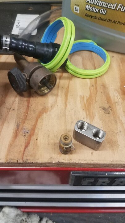

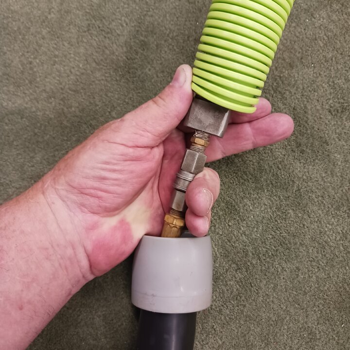

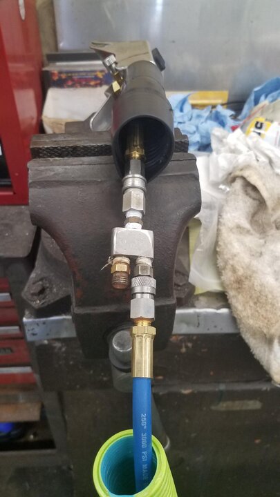

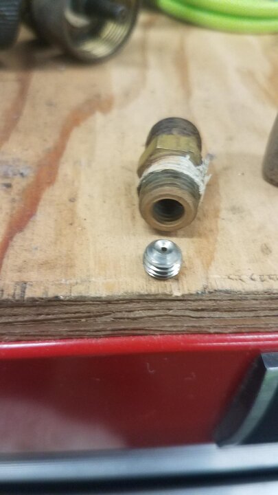

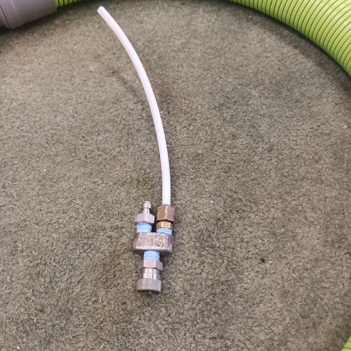

We chose to put the circulation valve on the other end of the hose
Keeps the weight and heat out of your hand, when needed, which it usually isn't
