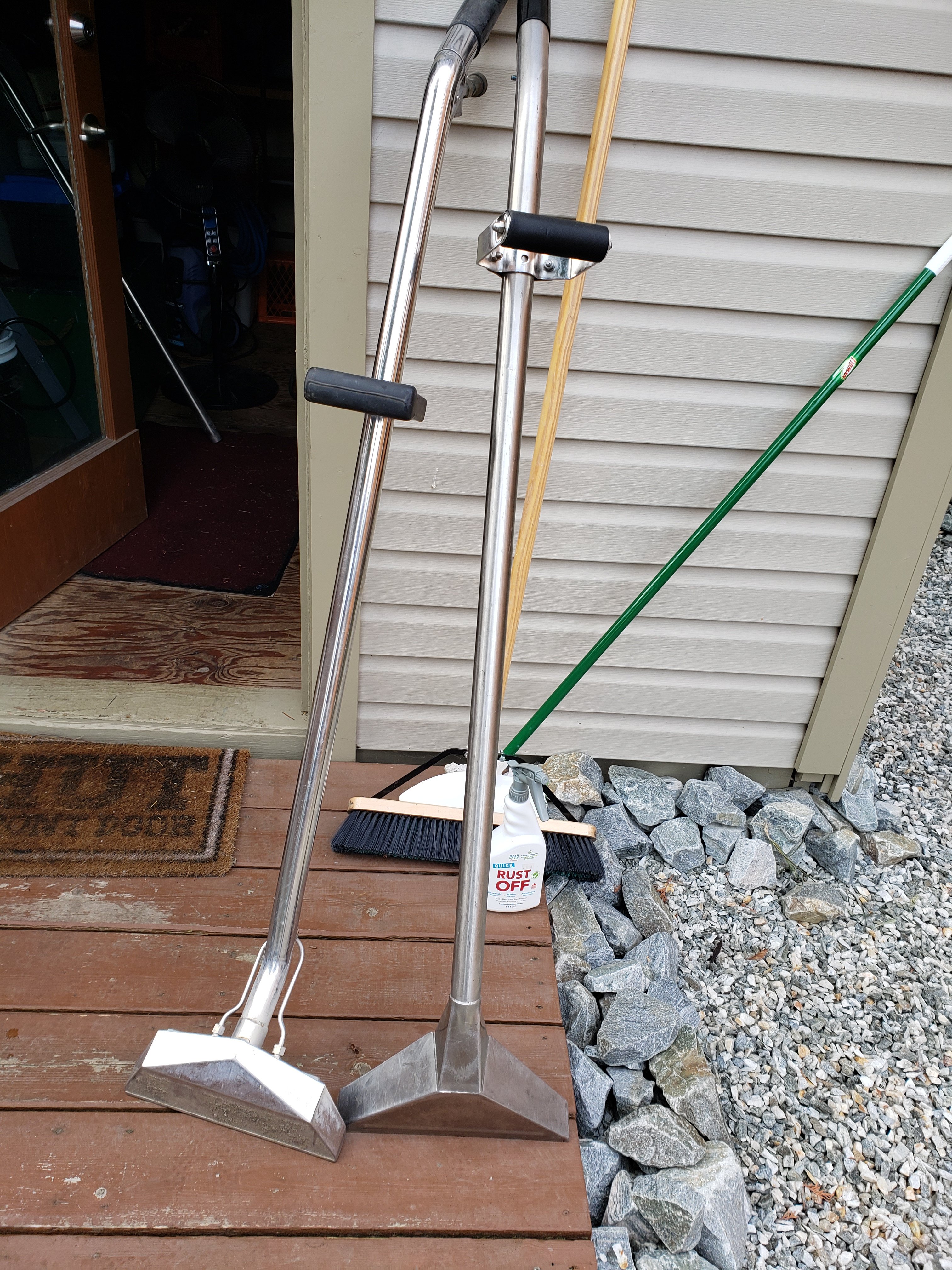

Anyone know what the 4 jet 14 incher is? I was given it last week.
