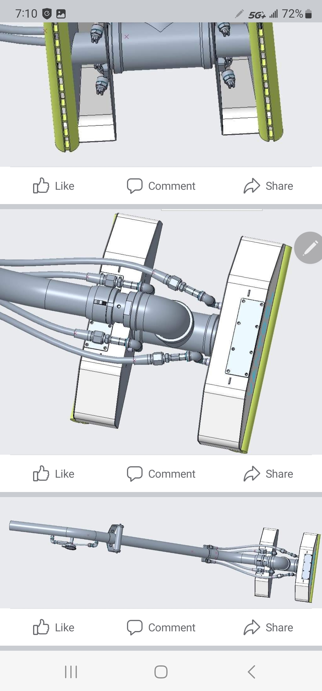

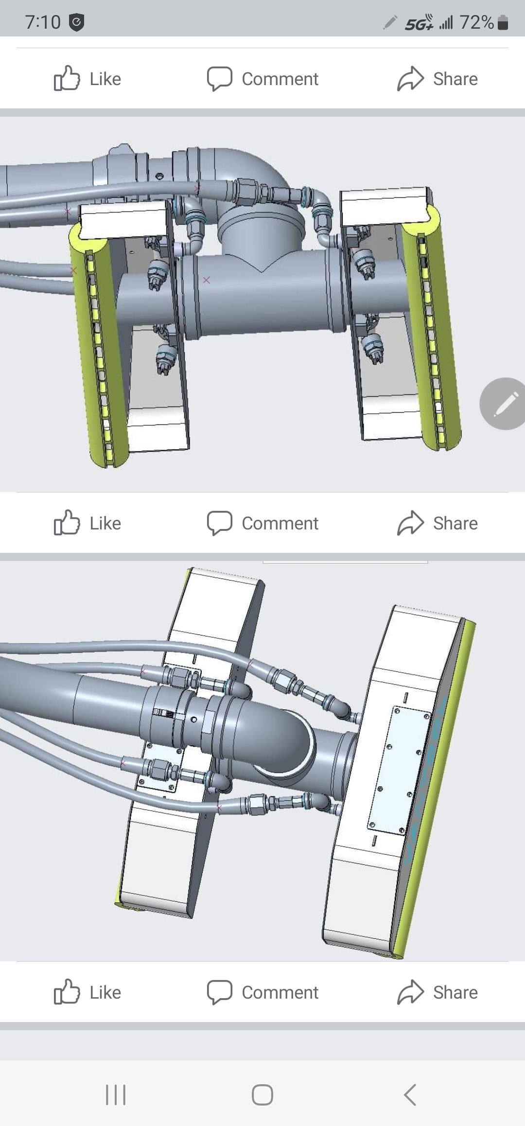

I just saw this on my FB feed and was about to share it as well.
It's amazing what the bottom feeders will buy into.
How the hell can they believe a 250cfm ETM the same as a 400-500 CFM gas powered TM with a PD Blower?
Will the draw be equal?
“Mine”? As equal as possible given the nature of airflow….you aren’t going to get perfectly equal draw especially after additional resistance to flow is added
But will the inequality be enough to matter…..
And it’s a cool idea but it doesn’t really solve an issue I’ve had. The zipper is probably the best implementation of this because beyond the potential of greater extraction or extraction in both directions it’s greatest benefit is in the area of fatigue which a wand style dual port doesn’t do much for and why the wand handle zipper was short lived

And how did you design your jetting?

Make the two vac heads close together just enough to put the spray bar in the middle. THAT was my idea a few years ago
