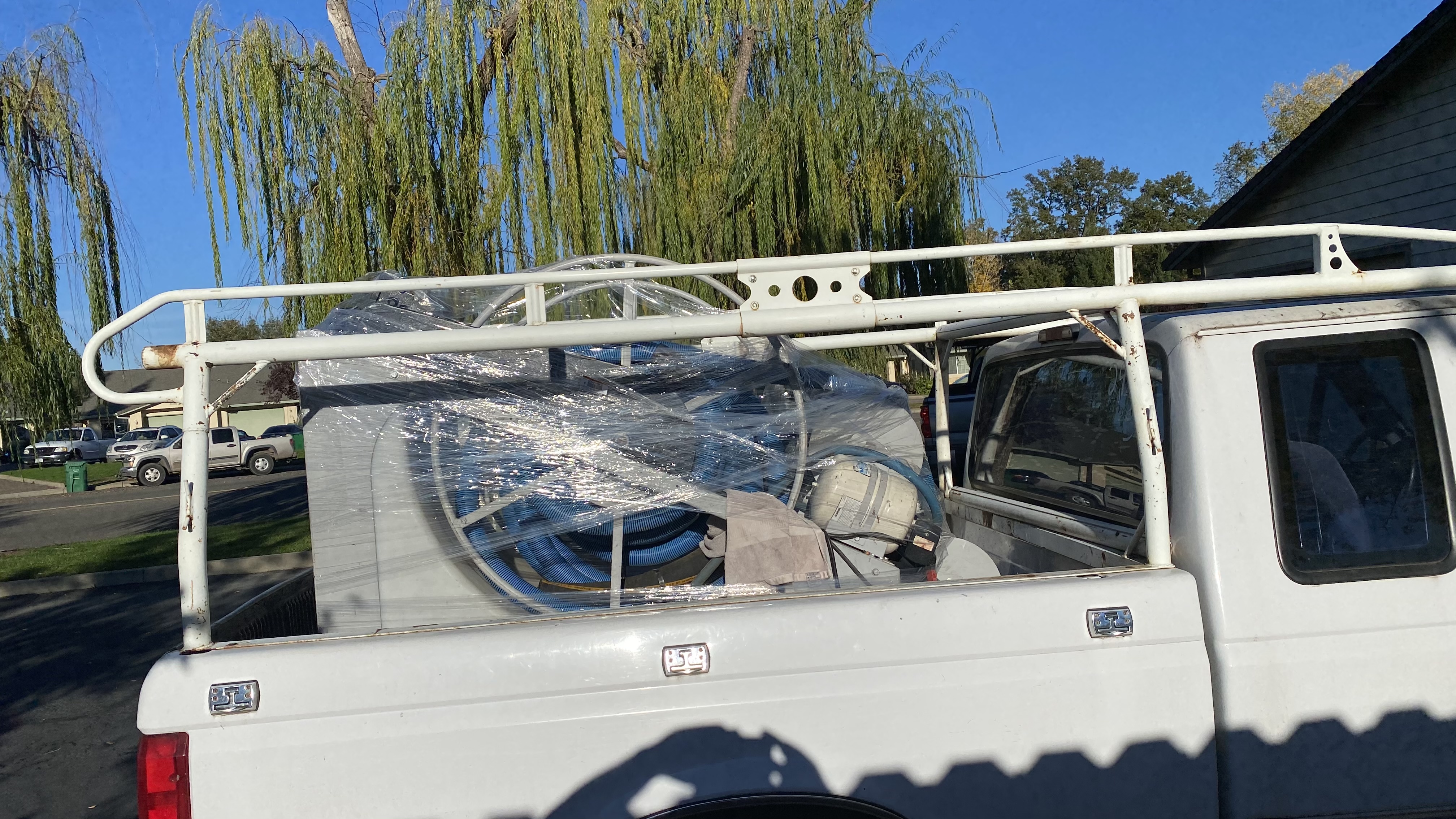

Picked up my waterpond today from the freight company. Now the fun begins. And yes. The truck in the pic is my other Ford truck I use for dump runs and as a spare.

Hope that's a one-ton truck. Water's heavy, and until a certain year (I don't remember when) the Dodge suspension was a little light.
Otherwise, helper springs or air bags might be needed.

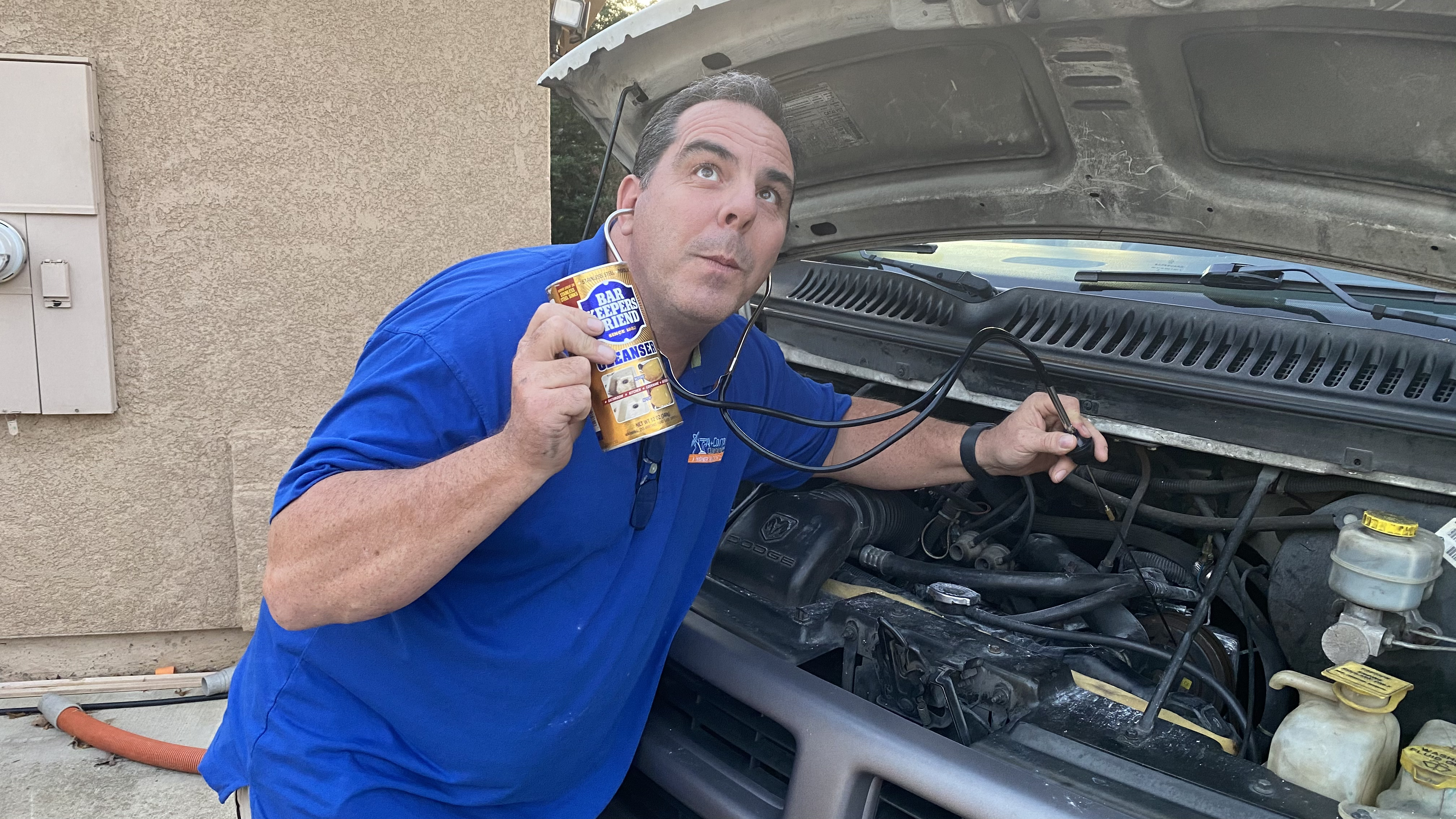

So the lima bean special has been working hard. Every morning I give it a bump of Bar Keepers Friend to keep it from squeeking. I was sure it was the PTO pulley, but then I thought it was the idler arm pulley. Its really hard to tell because everything echoes under the hood. On second I think the squeek is coming from one spot, then it jumps to somewhere else.
So today i went to Harbor Freight and Aircraft Supply and got myself a mechanics stethoscope. Turns out the squeek is coming from my power steering bearing. I’ll be dipped!
