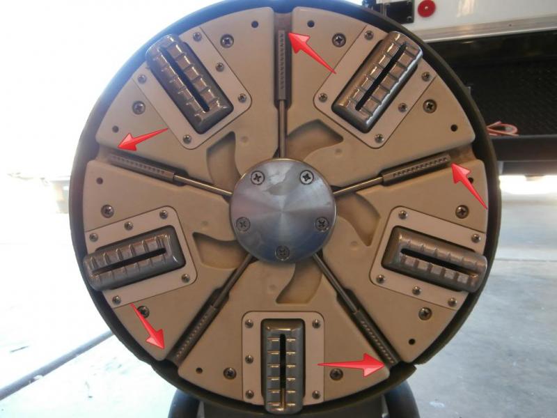

Jim and I were wondering if the RV shoes need channels or holes to increase airflow and break the seal..
Somebody should bring a Makita and a grinding wheel to Vegas..

Ok, I can tell you RIGHT NOW, that the 360-XL is 3x faster than the Hoss700... holy CHIT what a difference.

My Hoss was totally Jim Martin pimped, no flow disk, all long jets, Parker flow control valve... You had to move at a SNAILS pace to keep it from streaking.

You're a handy guy Ashley, cut/grind some air channels into those XL shoes to see if they speed up water recovery

Actually i thought about ordering another set of shoes, welding them closed, then drill 3/32 holes and some air channels into them... ala-chemdry rx shoes

Had to be operator error....5 high flow bars...off set leading edge vacuum shoes...it is physically impossible not to go faster....
you are pushing 4 spray jets that have to fan out and vac shoes that plant themselves down into the carpet.........with no vac relief.......

Equal only on your vortex. ..your comparing spray jets againest flow bars....and vacuum shoes that allow the air to move against ones that plant themselves. ..kinda like a glided vs a unguided wand....
Hoss is going to give you a better flush and dryer carpet....
