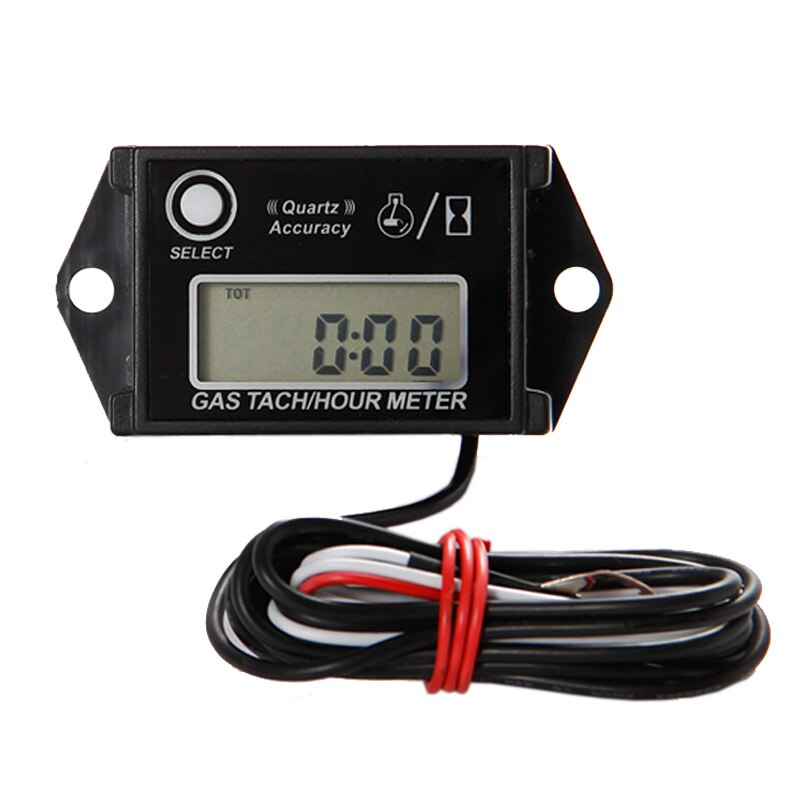

And did you also check your engine’s rpm at full throttle? These machines are known to have a setting that isn’t accurate
Do you have preferred tach to check it?
Those should be on all of the 2 cylinder machinesNo TinyTac/hour meter on the Boxer??
cheap (relatively) and easy to install
at any rate, you should be running any air cooled motor near max RPM to provide best cooling
'bout 3100-3200rpm would be the sweet spot on your motor
There's an adjustable throttle for a reason.No TinyTac/hour meter on the Boxer??
