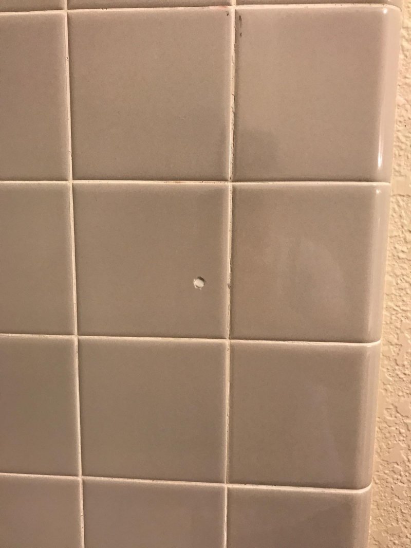

Jason my guys tried filling holes left over on a tub enclosure wall from the mollies.
They could not get your product level with the tile surface, it sort of dimple'd in..
Any tricks?

@Mikey P , here’s a tip. Pack those holes first with a thick mix of grout/water as a backer, then mix Super Grout Additive® as thick as possible for the final layer. Have your guys apply more epoxy on this one.
Same idea with any repair area that have large gaps.

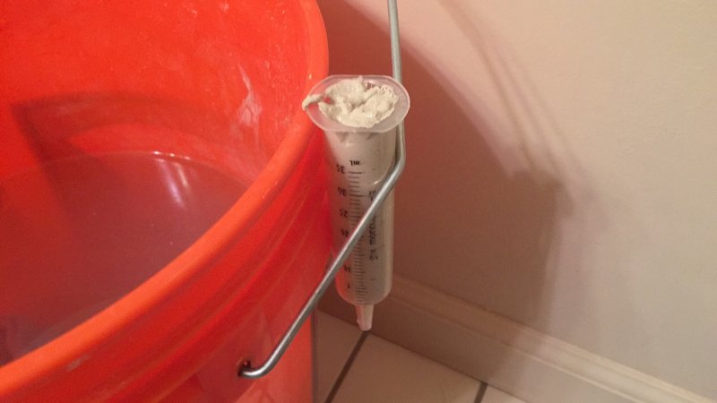

@Acp , get yourself a grout color chart and find the closest color. @Caulkmaster will mix different colors for custom matching. I always save any remaining epoxy as a sample and label them for future reference. Tip: let the remaining epoxy dry in the syringe overnight then remove it for a perfect cylinder core sample like in the pic.
You can also use the bucket to hold the syringe when filling. It frees up your hands.

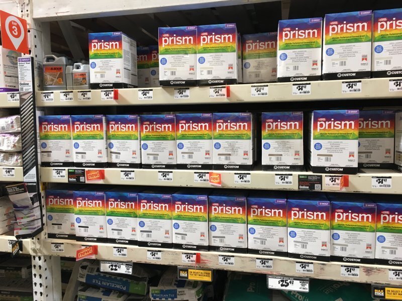

Mike..knife set polyester a better option for hole like that...your not going to get a product rhst has sand in it to towel flush and smooth,
Home Depot, CBP, no longer sell ssanded, unsanded grouts....
The movement is to sell 1 type that replaced both.. its considerably more. However color consists t and don’t need to seal.... use hydrolic cements- cure fast ..
Jason, have you tried with the new type grouts?
Mixing may even be easier,

You must mis read my post Jason....it’s a hydrolic based cement.. what we used to use in my former life for under water repairs on concrete pipes.
Think of it as grout on steroids.
And yes-FACT- our local HD stores only sell this as your only option for cementitious based grout. I’m sure you still go to website and get it....
Simple economics... and long overdue.....why carry 2 of every color...
The Mapei. Version of the same (FX) however will scratch polished TML

I’m not a slab guy but I agree that there are polyester products for seams that are better suited.
As for Home Depot no longer selling Custom Building Products Polyblend grout, sanded and unsanded, that is not true! Cement based grout is considered the staple of all grouts and the discontinuation of such is highly unlikely.
Well......truth be told...... looks like you might want to follow up with trends in your field.

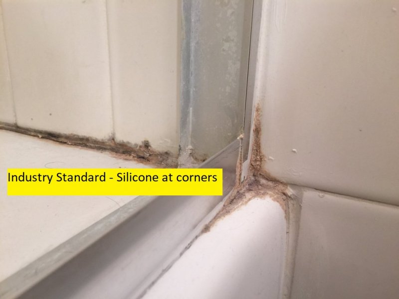

Dosnt TCNA recommend caulk for change of planes in shower?

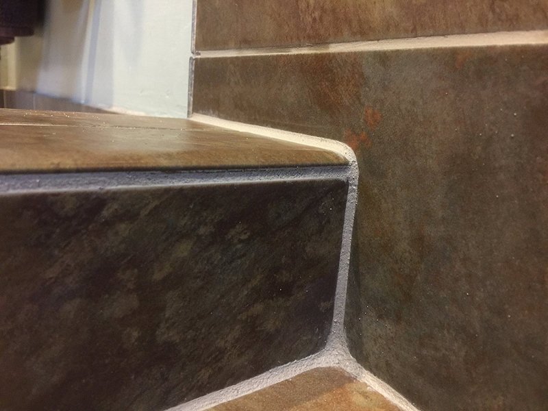

Industry standards are outdated and have been for several years. It's a fact and the pro's that run tile/grout restoration businesses no longer have to use low quality products that typically result in call backs.
Here's what the TCNA recommends for change of plane, right out of the handbook. Industry standard but certainly not Industry wide!

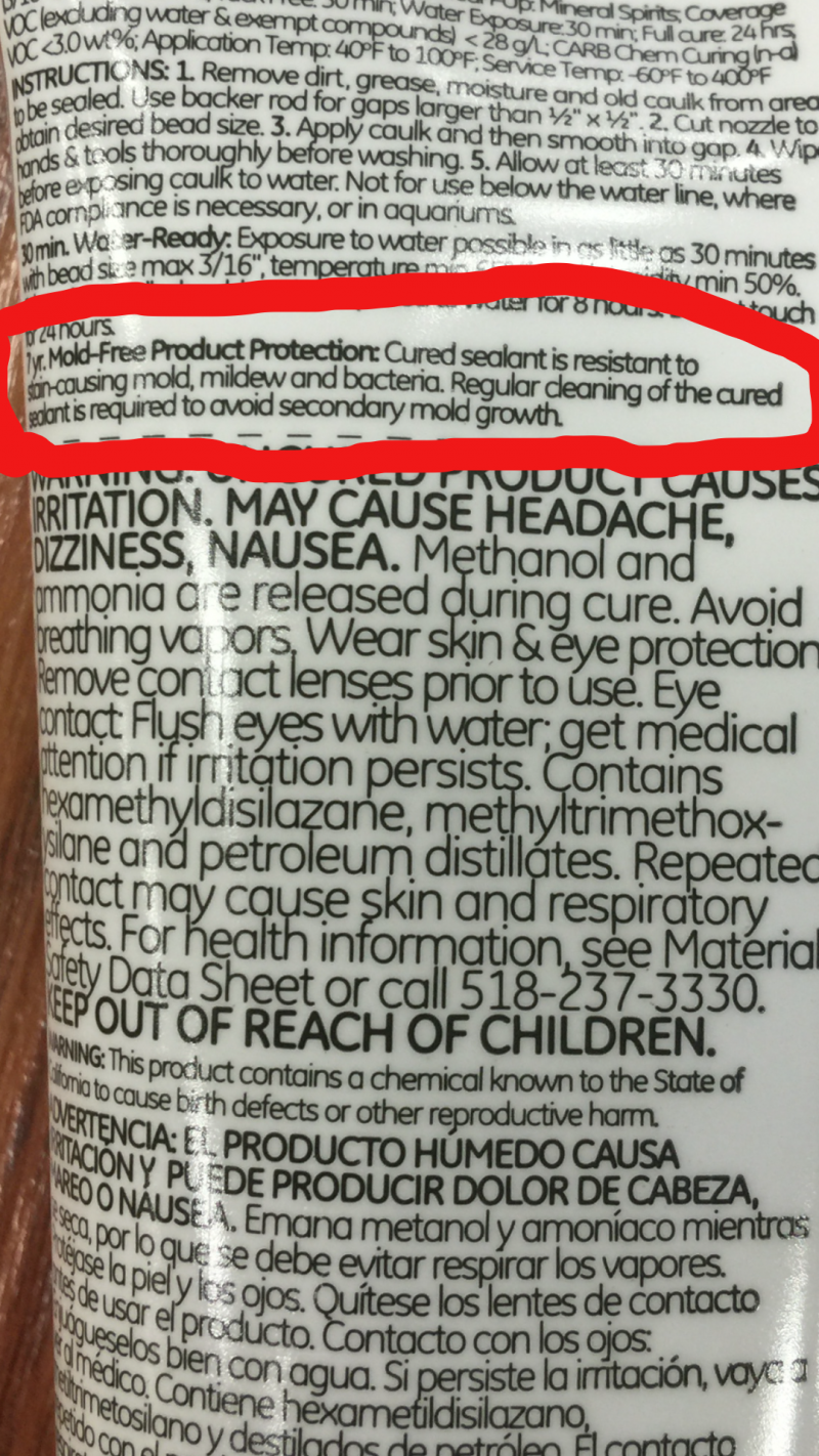

Read the fine print on 100% silicone. So misleading it should be against the law. How do these big companies getaway with it? Homeowners, DIY'ers, and pro's know what happens with this stuff in wet areas. Should be no surprise.
