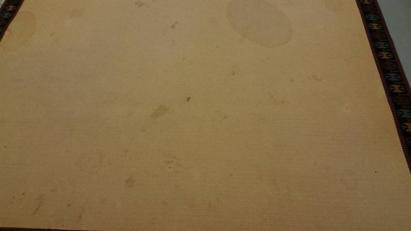

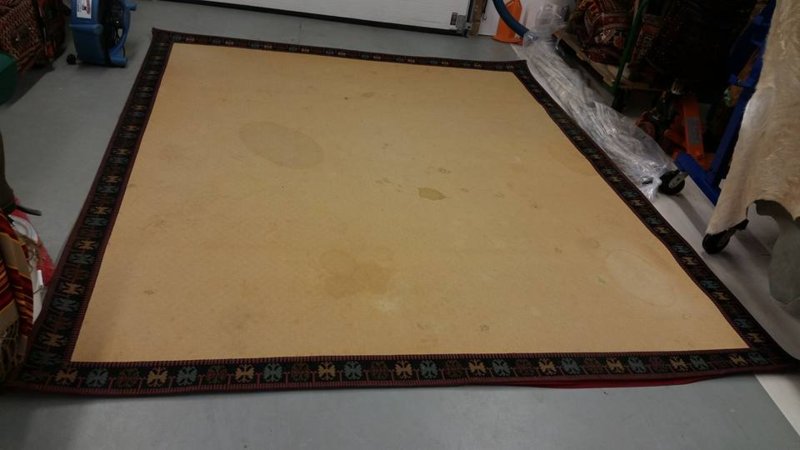

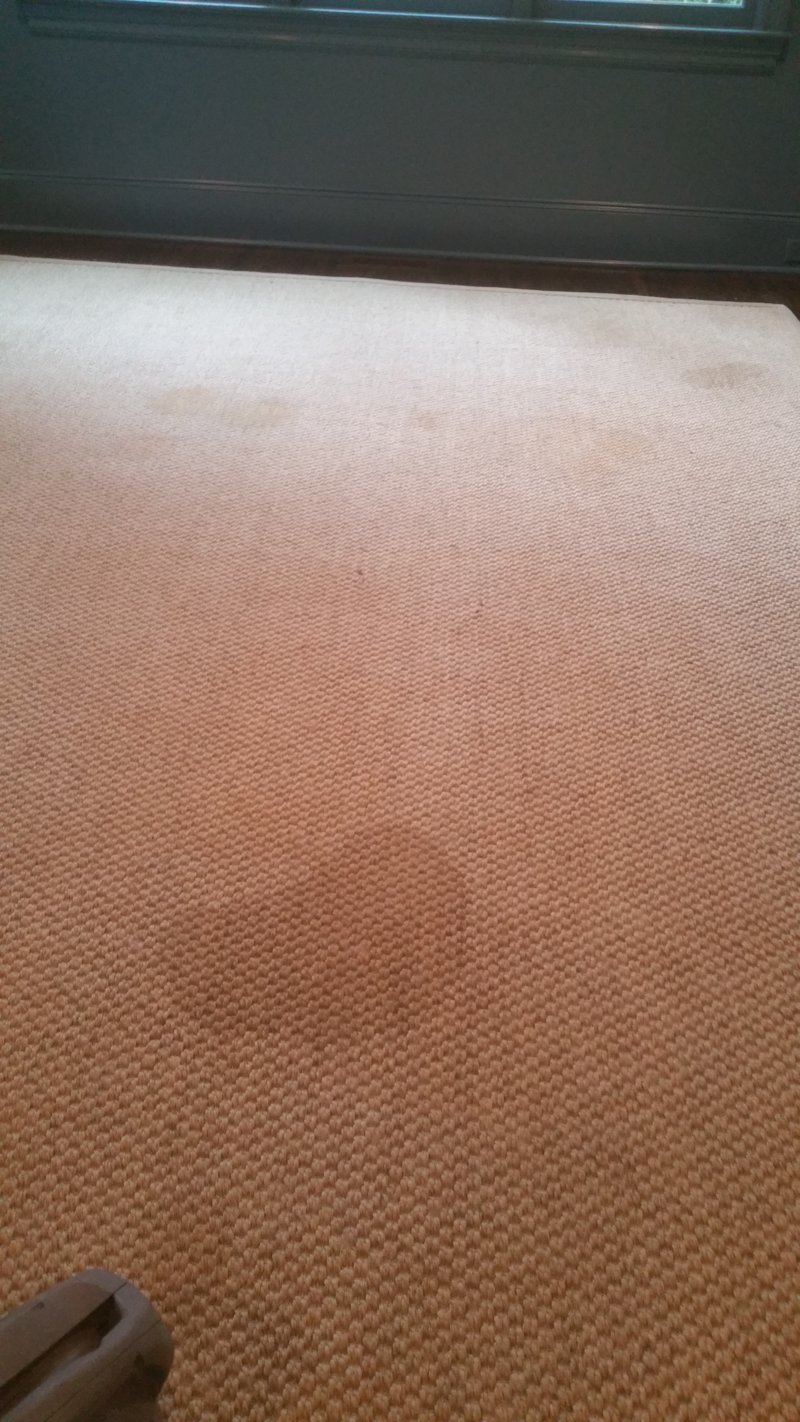

A client got this rug as a gift and wondered if it would clean up? What do you think?

J Scott W
Oct 16, 2006
4,061
Jeffrey Scott Warrington
The Stark label means it is a pricey rug. You could afford to spend a little time on this and charge right.

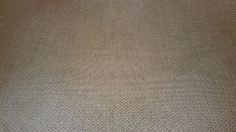

Same question as Jordan. Looks like sisal to me. That will be fun.
Wouldn't be in issue if FPA was applied at time of purchase.
Ron K
Jan 3, 2009
2,371
Not Sisal with that design! From what I can tell. Synthetic? Wool? I would test first then hammer it hard....seems to have been hammered anyway! Structurally looks OK?
So, Prima, Sisal and all Cellulose-tics can be washed safely after FPA??????

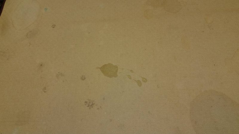

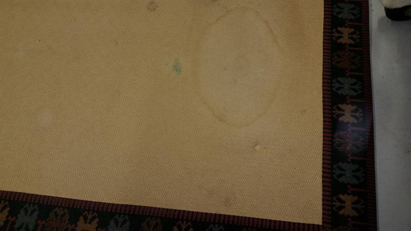

It is already doomed. It is a Sisal field and severely bleached-out in some areas along with a great deal of stains.

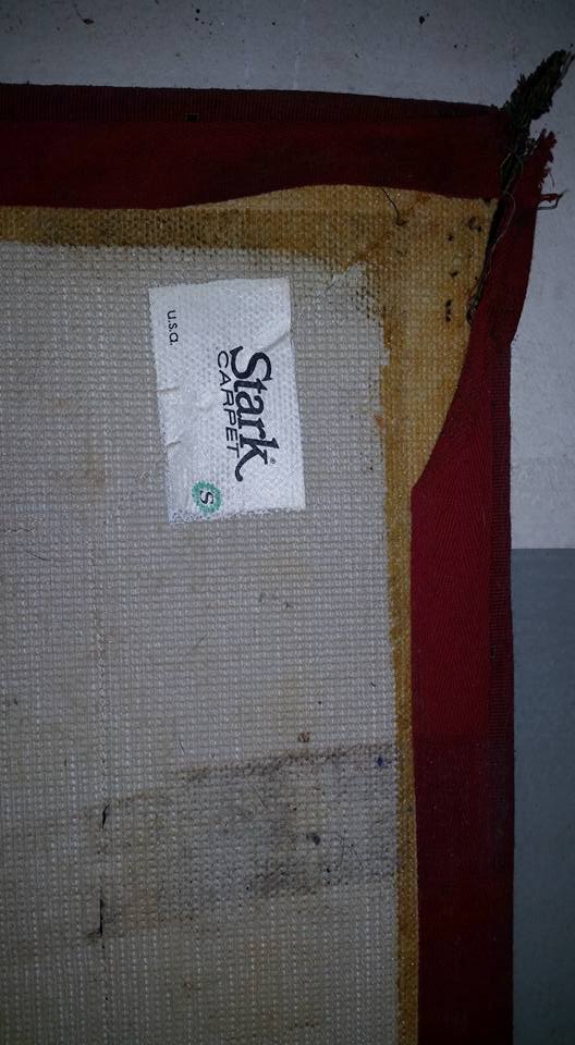

I'd Run-- from that rug..
Just too lazy to GAD.
Papa John
Lifetime Supportive Member
Aug 19, 2013
7,040
John Stewart
What's the worst that could happen?
As you can see the corners are already Curling up and this is just from absorbing moisture from the atmosphere. Once the border get wet the corners will pull/shrink in different directions--- which means you might have to disassemble the border and restretch the carpet and border and put it back together.
If you are new to rug cleaning just avoid rugs by Stark--unless you have a lot of extra money in the bank or great insurance to pay the customer for the rug.

What I find funny is the work performed. The tapestry border is falling off. It looks like a kindergarten kid applied to much glue. Lol sloppy. I'm glad my label is not on that. According to the backing it is not sisal.
My thought seeing the design on the front.
So Tom is it Sisal or not.
Reactions: Harry Myers
Stark carpet is what I deal with if not hand knotted. Lol just another wool manufactured by everyone else. Mt list could go on and on. Hand knotted is alot more money what you afraid of.?

I think you see a border instead of a tapestry. Which is no concern if it is seam taped.

Tom I'll look on my computer tomorrow to determine if this is a sisal. Or a sisal look.
