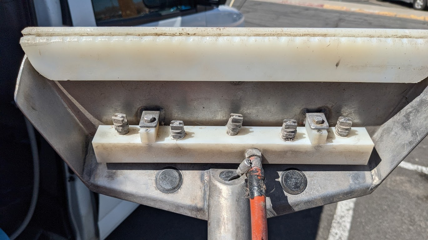

well howdie-doo
plastic manifold, center jet cross threaded and a band clamp on the manifold supply line.
nice....

I had a tubeless head for a while to redesign the glide for, I should have kept it as a paperweight.
The inside vac manifold was so....perfect.

One of the worst versions of a wand ever..3 jet was by far the best of there versions...

on the other end of the spectrum is the best wand ever constructed...
After years of slinging the Prochem Tri-Jet wand, which was sort of like pushing a boat anchor across the carpet, I really welcomed this wand. "Pre-glide days", I found it far easier to use, and these wands have held up for decades, unless they were used for flood extraction on concrete.

The nylon blocks were a vast improvement over the original aluminum ones that would blow a hole out directly opposite where the supply line entered.
You did have to be careful to not cross thread a jet though.
