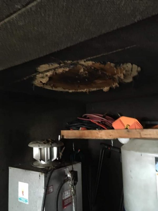

Waldo's POS LG nearly killed him yesterday.
Sure it Waldo but he's smarter than the average carpet cleaning idiot
How did it almost kill him?
I see a burn mark on the van roof that looks like what occurs after years of exhaust cooking. Usually, cleaning the coils keeps flames from coming out of the exhaust, but if this is what happened, how did the heat go around the wooden shelf piled with plastic stuff?
We had LG heaters in the old days and aside from the usual knucklehead things guys did around propane, didn't have many problems with the heaters. We currently have one jetted for natural gas on our tack-out floor. Going on 25 years with only cleaning and replacing a few thermocouples for service.
Reactions: Acp and Cleanworks
27,933
The propane pipe that goes to the thermostat fell off ...poof!
That's exactly what almost happened to me. The swivel union came loose because of the broken mount. I just had a little flame coming out but would have been much worse if I hadn't caught it in time. That's what comes from being too fooken lazy to fix it and thinking, "just one more job". Taught me a very important lesson. One that I already knew but grew over confident on.
