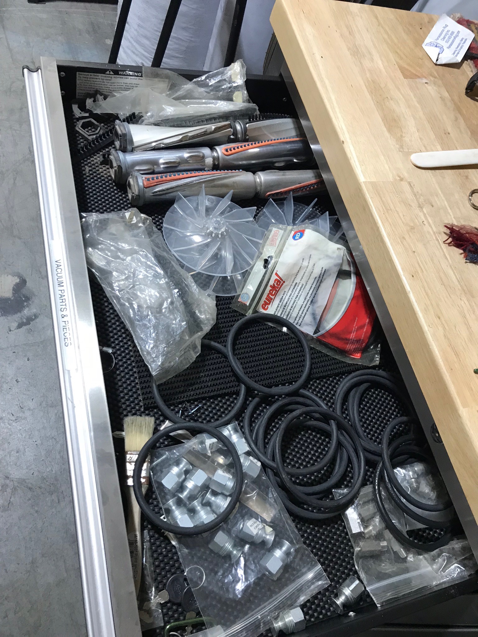

rhyde
Do your own comparative testing I have all the stuff I'm telling you the standard bar works great
