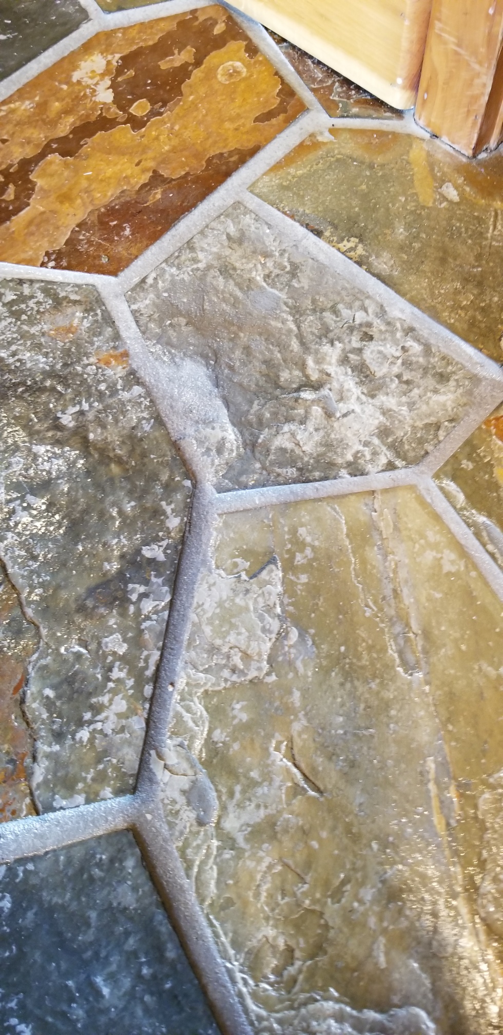

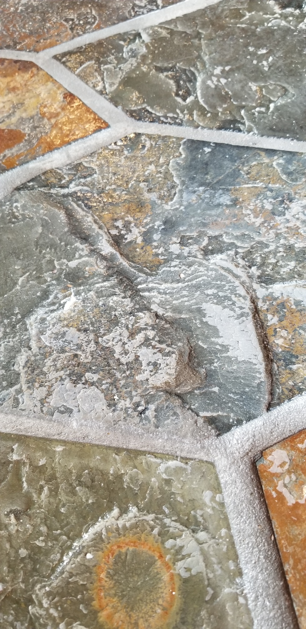

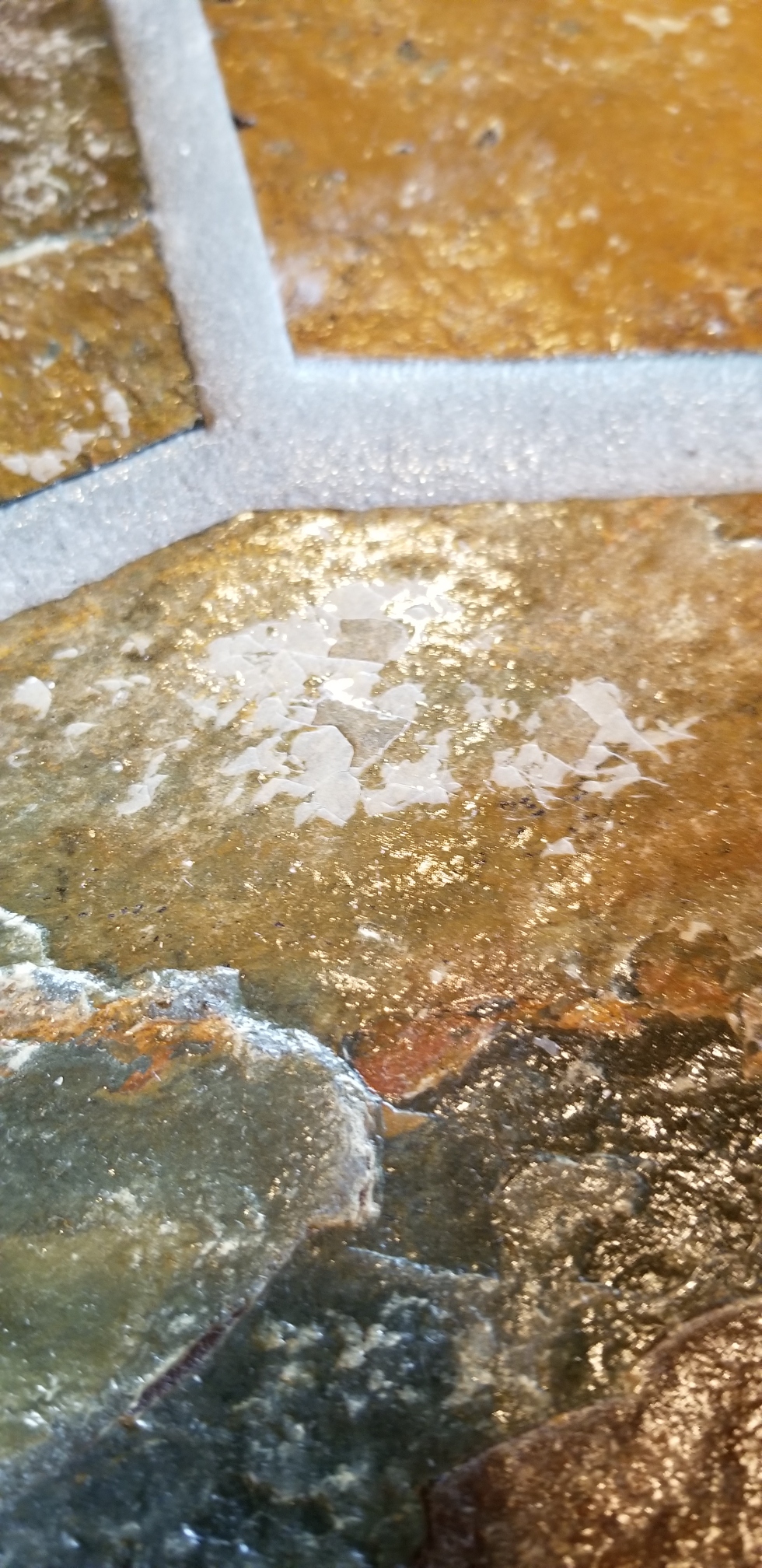

Mark was asked to correct this failing enhancer.
Looks like a topical mess to me , not an enhancer
9 month old install, customer swears onlt the shown product was used..

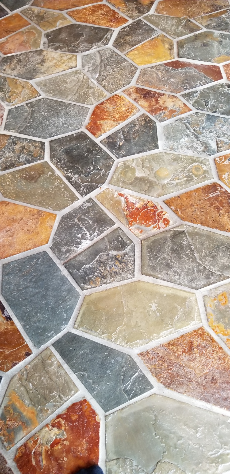

clean image

Great product used incorrectly
Enrich and seal is a 100% solids penetrant enhancing sealer.
Goes in, not on the stone.
Clearly states it right in diections

I actually have pretty much passed the buck and hope they don't call me to do this one....LOL...
Too much work and I know they won't want to pay big bucks for the time to fix....

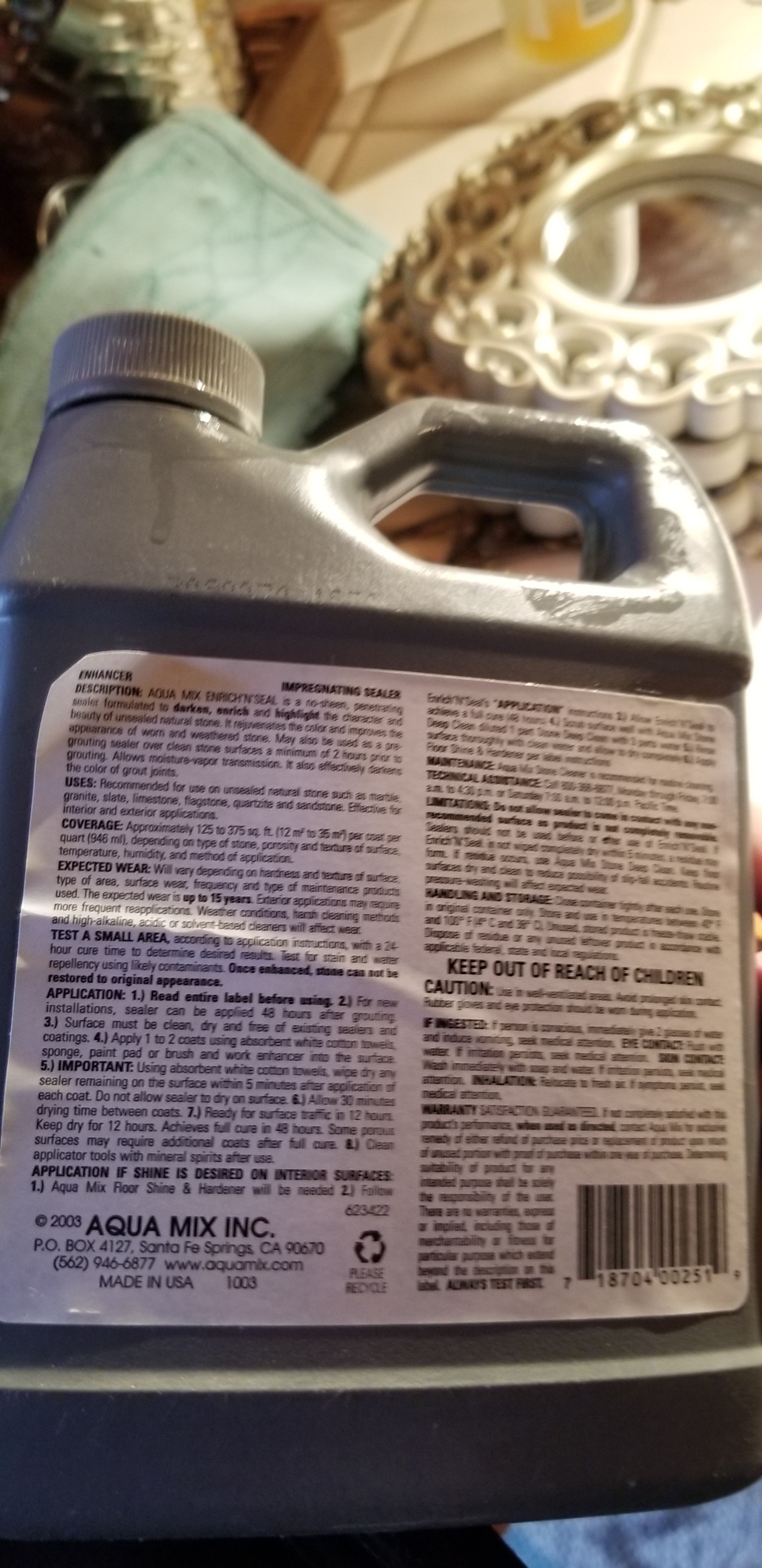

Agreed Over applied. If leaving it with the customer the label mentions to use Aqua Mix Stone Deep Clean to get it off.
DAT
Apr 3, 2017
6,487
Bill Cheryl
It also said, once enhance, stone cannot be restore to original appearance...
