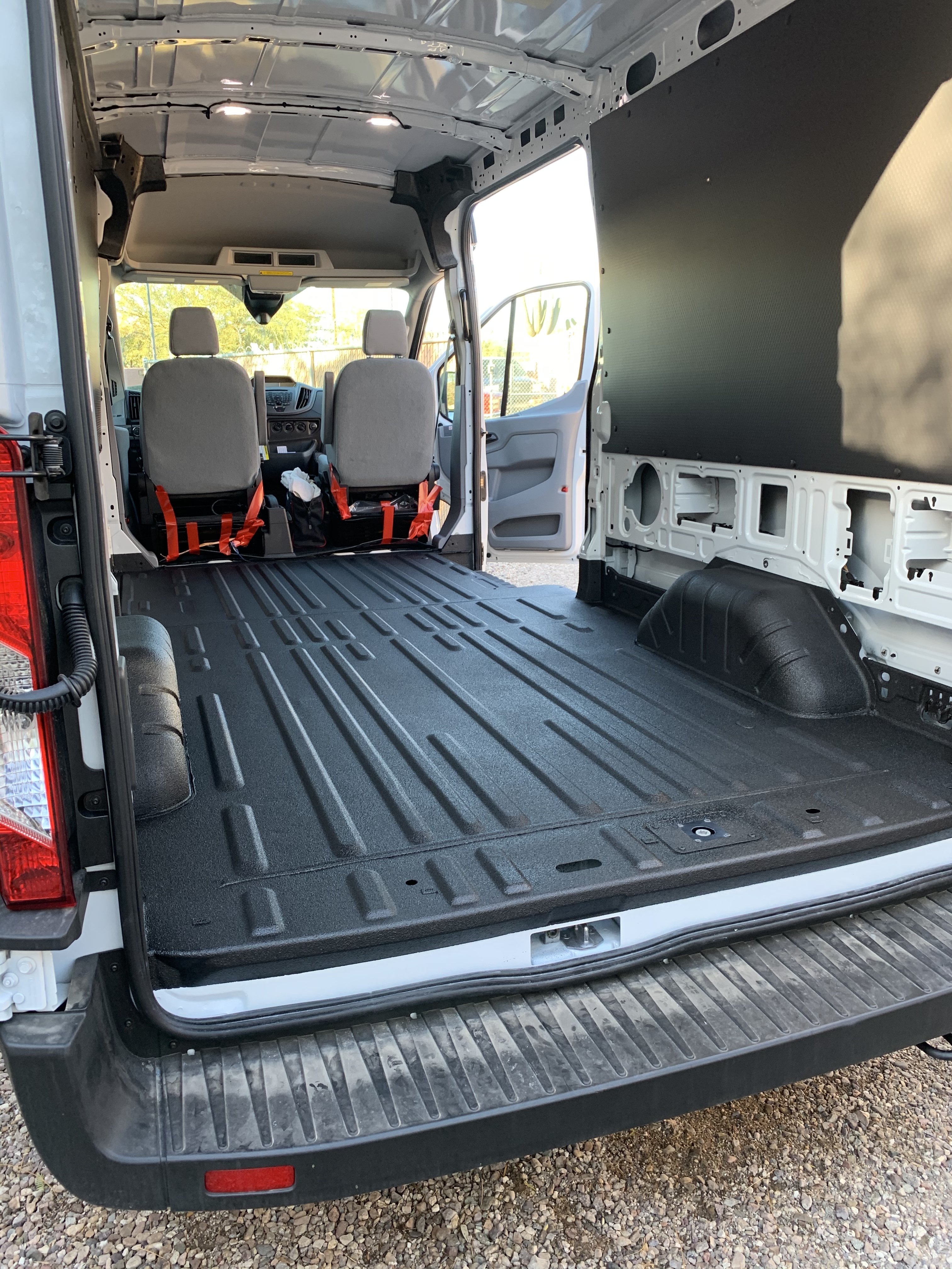

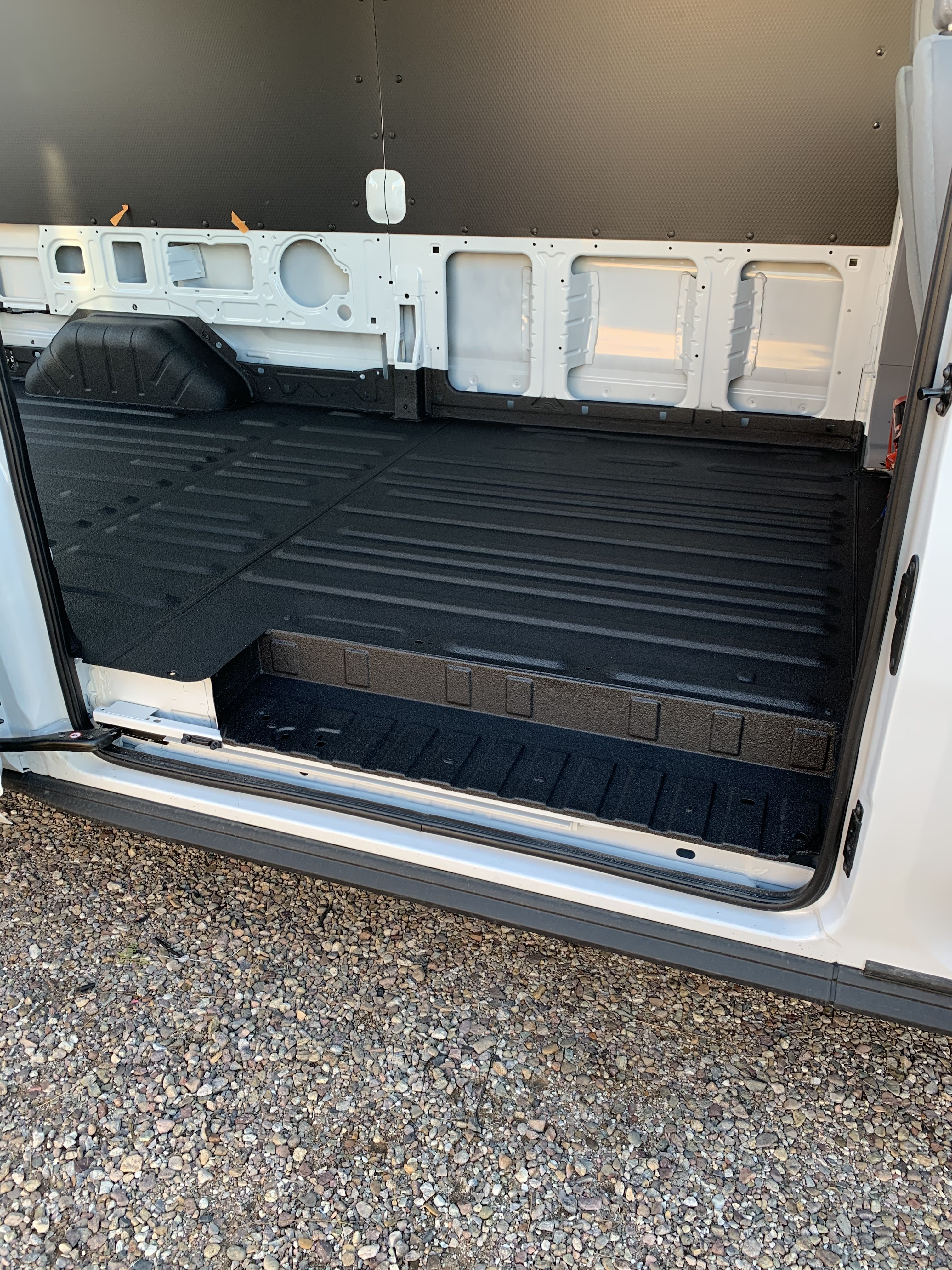

Who hear has used raptor liner? How is it holding up?
I sprayed in our van today I think it looks good, hopefully it will hold up.

Both our trucks have spray in bed liners. Big time savers!!

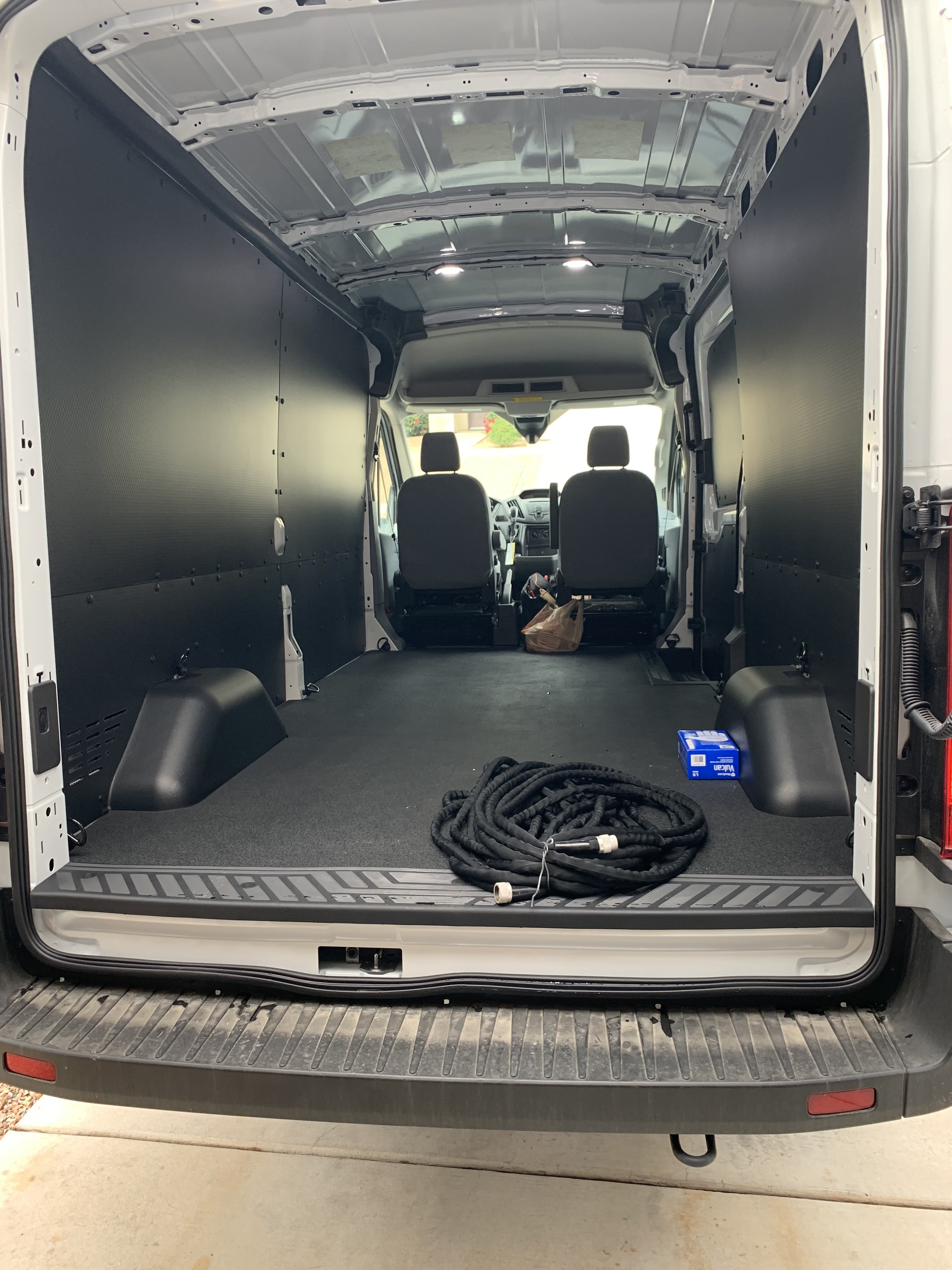

I was thinking about putting the factory liner back on the floor any reason I should not? The only thing that may be an issue is it has some kind of fabric glued to the bottom.

That’s why I was thinking about putting the mat back in, looks easier to keep clean.

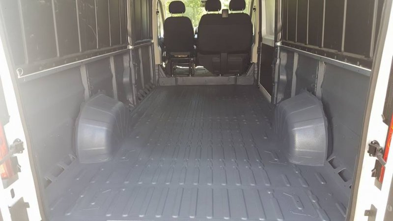

I found out the hard way. I bought it twice for my Promaster. I bought the first batch from a local auto paint supply shop. It was white tintable. Turned out it wasn't enough to do my van so I bought another batch on Amazon for 1/3 the price of what the shop had charged me. But when I ordered off Amazon I accidently ordered black. so I mixed the black and the white together and it came out Grey. I like the grey so much i'll be doing it again in my truck.

what psi and distance from surface did you spray?
watched some youtube vids and they were saying psi and distance changes the texture
my vans sprayed out with shipping container paint so its chem resistant, but when it gets scratched..

I sprayed about 45 psi and 12-18” away.
