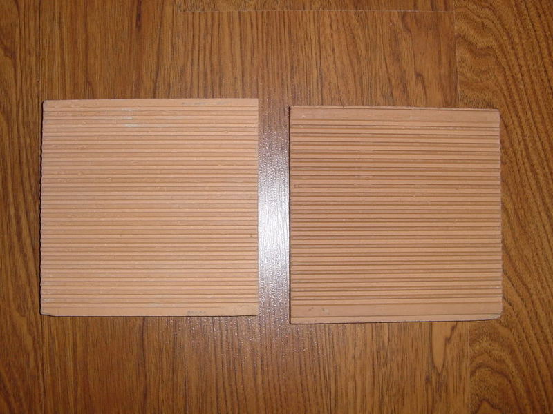

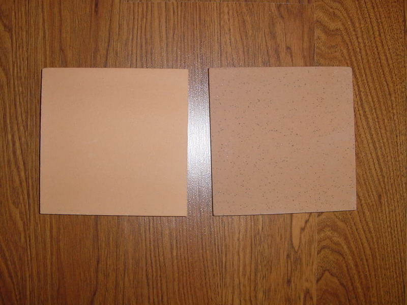

Customer of mine owns a custard stand. They just added an area for dine seating and now have some areas of older quarry tile with some anti slip particles in it, also areas of new quarry tile without the anti slip particles. Anything I should be concerned about as I clean it? Owner wanted to know if he should wax or seal the floor?
