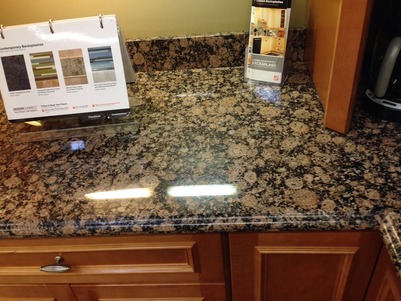

Putting in counter tops
11,551

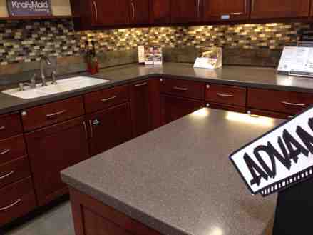

Almost went with corian but a customer said it scratches and is really hard to keep up
Talked my wife into granite instead a little more but I want her to be happy 10 years from now

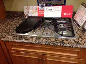

How porous is that verity?
Seal around the sink and range twice a year, neutral cleaner only, Magic Al's fit mineral build up, no hot pots, no chopping and you're good to go

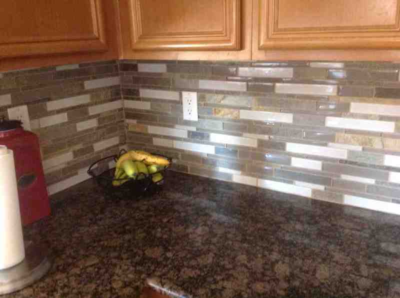

We sealed it several time's last time with a stone enhancer sealer.
Picked up the back splash at costco for $25.00 a box covered 5 sq ft, had 5 pieces in each box.
