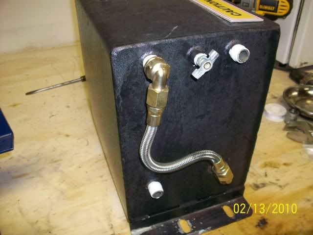

that Butler i had was ALL AN line..
heres the HX

It's crazy NOT to have an EXHAUST heat exchanger when you have a V8 engine sitting there running the whole time. It would be easy to do.

Right behind the catalytic converter unbolt the exhaust pipe and add a loop that totals about 8' of pipe that is flared on one end so that it bolts stock back up to the converter and tail pipe in their stock locations. Coil about 150' of 3/8" stainless tubing around that loop and insulate over the complete assembly. Don't insulate the converter or factory exhaust however, as this could trigger warranty issues.
There would be a couple of other details for freeze-proofing it. I did a crude version of this when I had a Butler.

I had both ends of the loop come up thru the floor at the side door to quick couplers. When I used it a short section of solution hose went from the machine to the inlet qc and the working solution hose was hooked to the outlet qc. I blew the water out of the loop between jobs, you could just vacuum it. I'd love to figure a way to have it just drain out but not enough room to do it right.
I didn't bother to do a temperature control on it, got stinking hot. I used copper and just 25' of it. Too busy at the time to keep playing with it.
