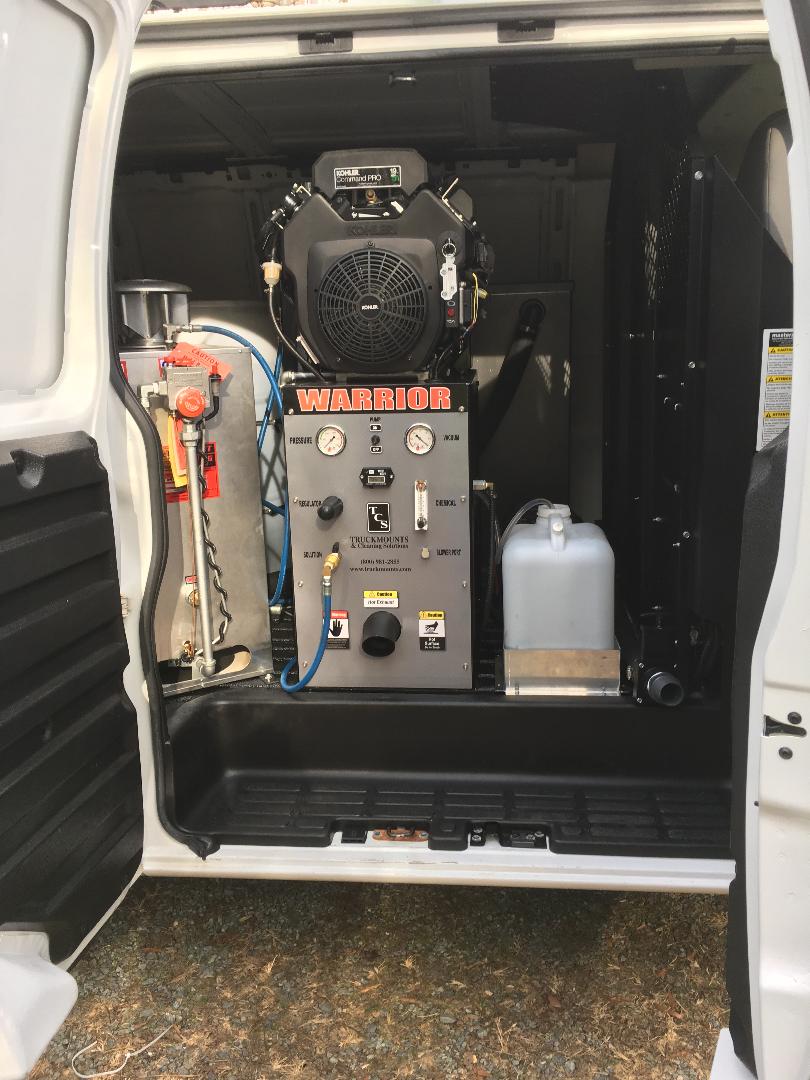

Hows that compared to cheif? Is warrior more than enough for residential cleaning?
I believe the chief has a 4m blower. Gives you a little more airflow. The warrior is fine for residential and light commercial. The chief will allow longer hose runs. Both have the same heat. Apparantly, they now have hx machines available.
I’m actually getting better dry times than my old machine that had a Roots 45. No HX to slow down air flow. I use it on 250’ runs with no problem. I chose TCS for the simplicity. At some point the motor and blower will have to be replaced. My old machine was a nightmare when I had to replace the components.

14K includes hoses and stuff also?
Yes. Hoses, hose reels, live reel and hose for fresh water and 50 gallon fresh water tank and a Westpak wand. High pressure 3HT heater and belly mounted propane tank too. Standard waste tank is 65 gallons.
