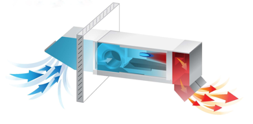

The Cambridge unit as it operates: Make up air comes from outside. Outside air then passes through motor and then through proprietary stainless steel burner into the drying room.
The dimension of the unit is only 55" in length by 21 1/4" height and 21 1/4" depth.
12.3 amps
Weight: 235 lbs.
1200 CFM
Input 250 MBH
Output 230 MBH
Reactions: cleanking and West
