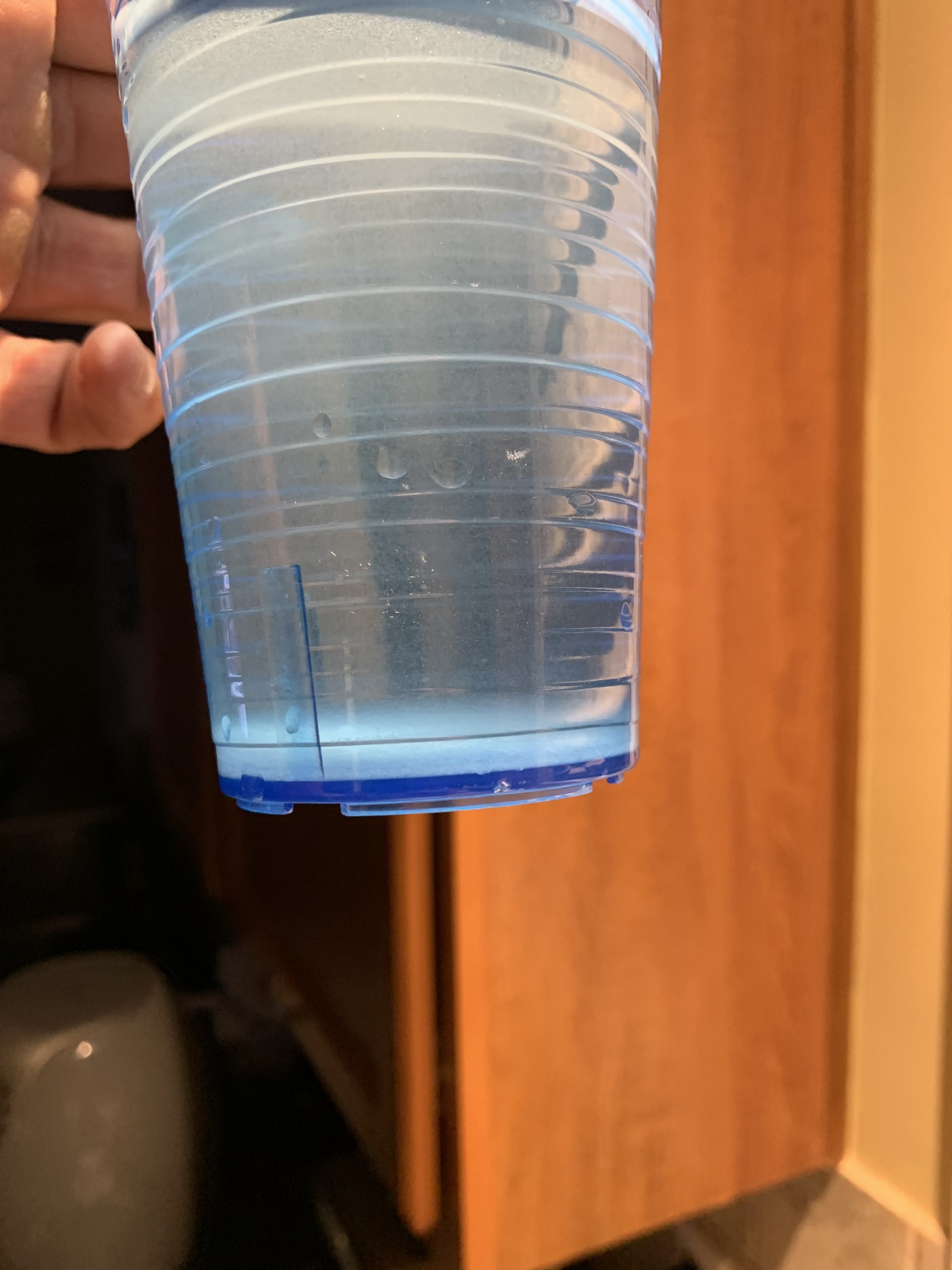

I mixed a teaspoon in a glass of hot water and let it sit for a few minutes.
Easy to see the powder at the bottom of the glass.
