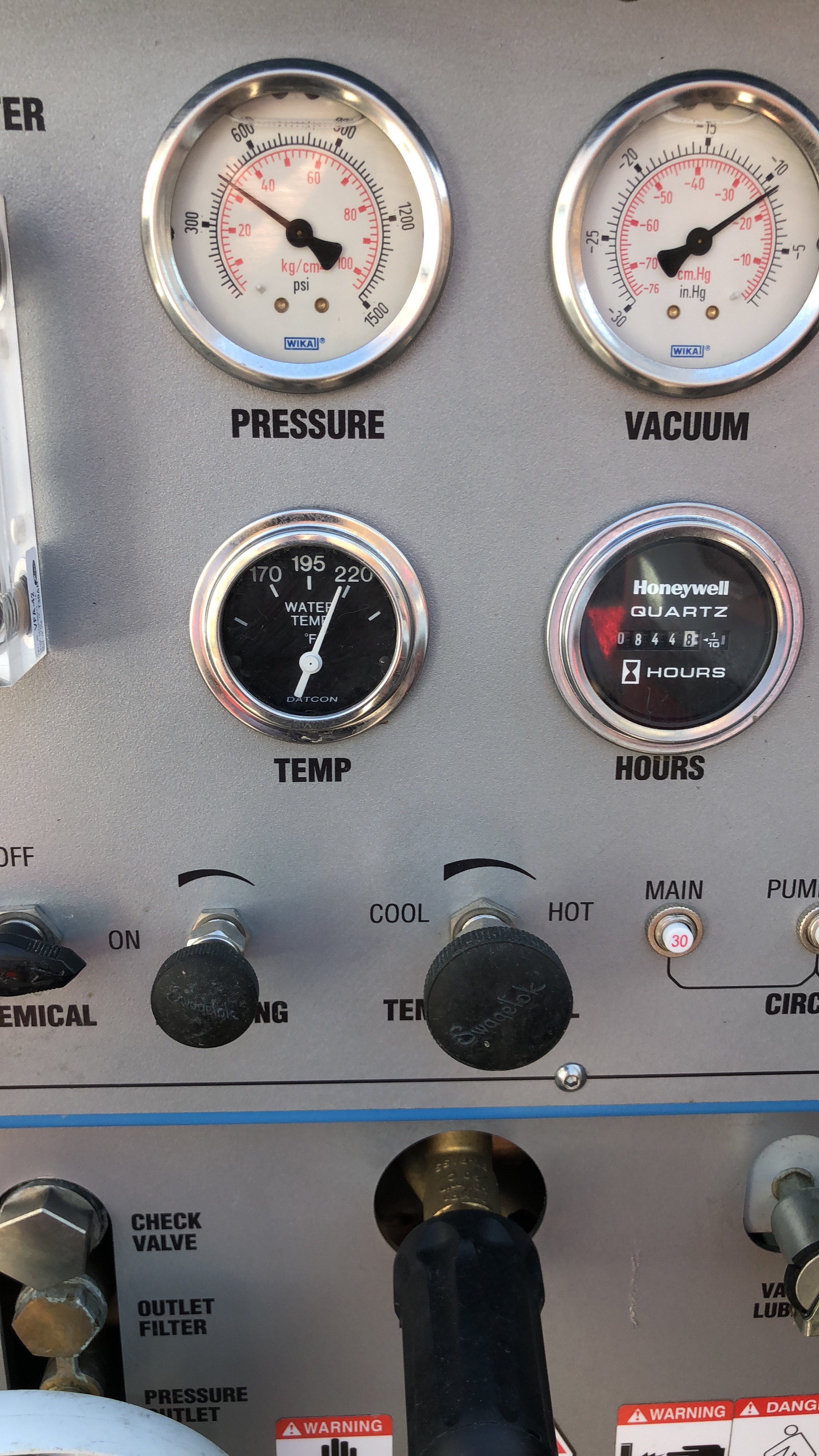

so I ran it hard for four hours straight it was spiking well over 250-260 if I let it sit to long.
I noticed a little coolant under the truck
It hasn’t leaked in the last week!
Got a lube oil filter and the jiffy lube guy said I had a water pump leak and should take it to the dealership cause it’s still under warranty!
I’m also getting a slight chirp!
I think the chirp is the belt
And I’m worried my Chevy dealer may want to try and keep my truck and the busy season just hit!
I guess I’m wondering could it have back flowed coolant out the reserve tank since it hasn’t leaked since?

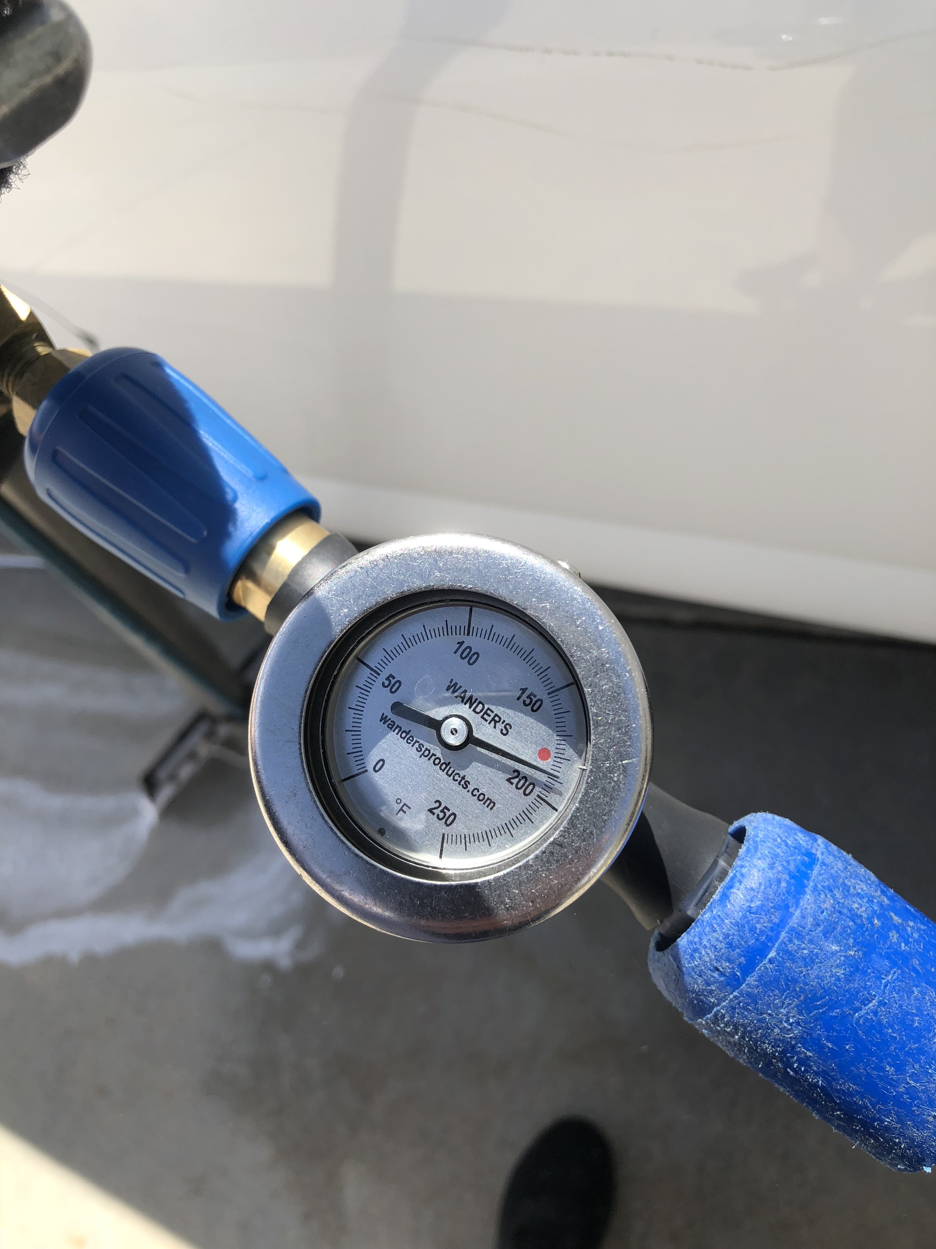

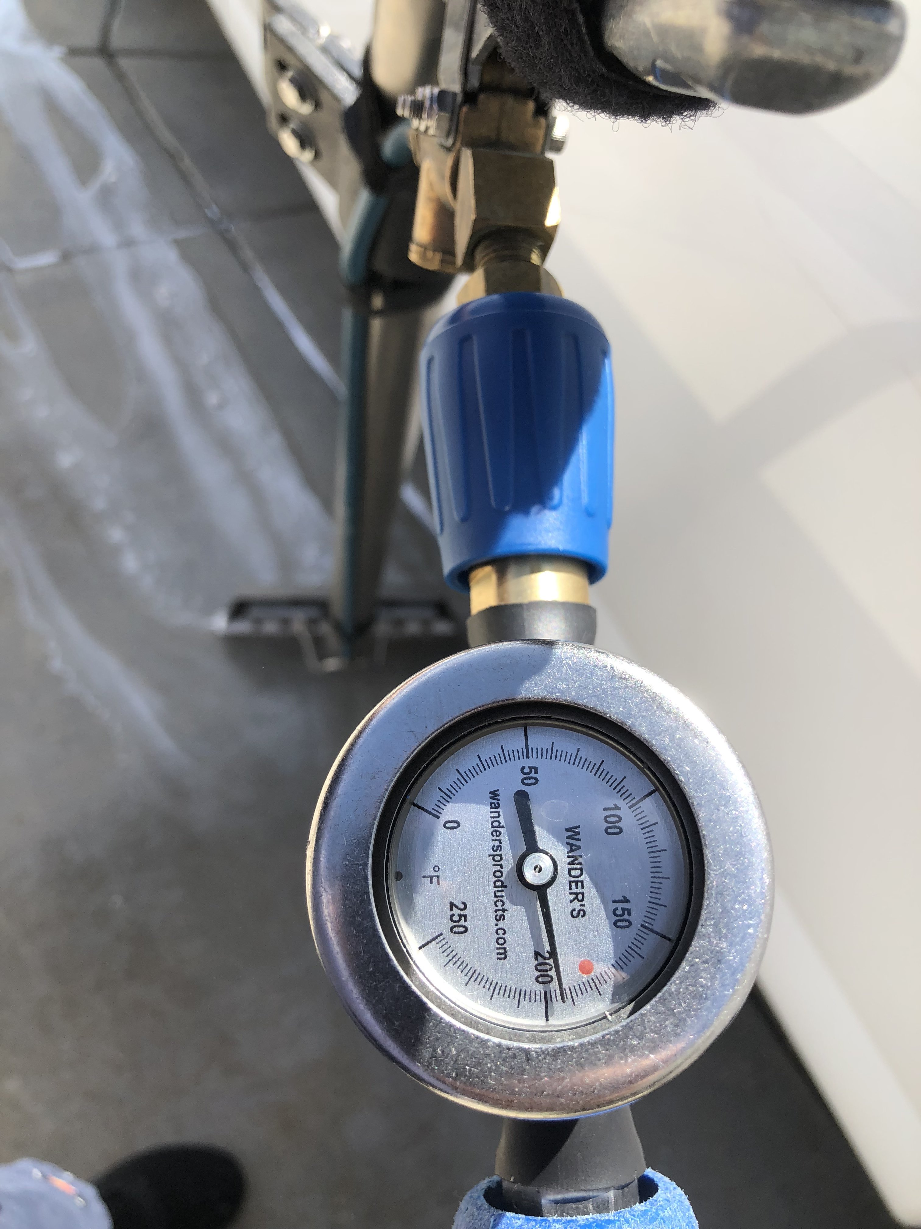

Well well we’ve been seeing numbers steady at 180 atw on medium 1200 rpm blower spinning 3000 rpms no need for high!
I know on high mine runs at 1400rpm,
Ashley M modified his at set it to 1500!
I’m tempted Rick A said go for it!
New lid gaskets really helped to!

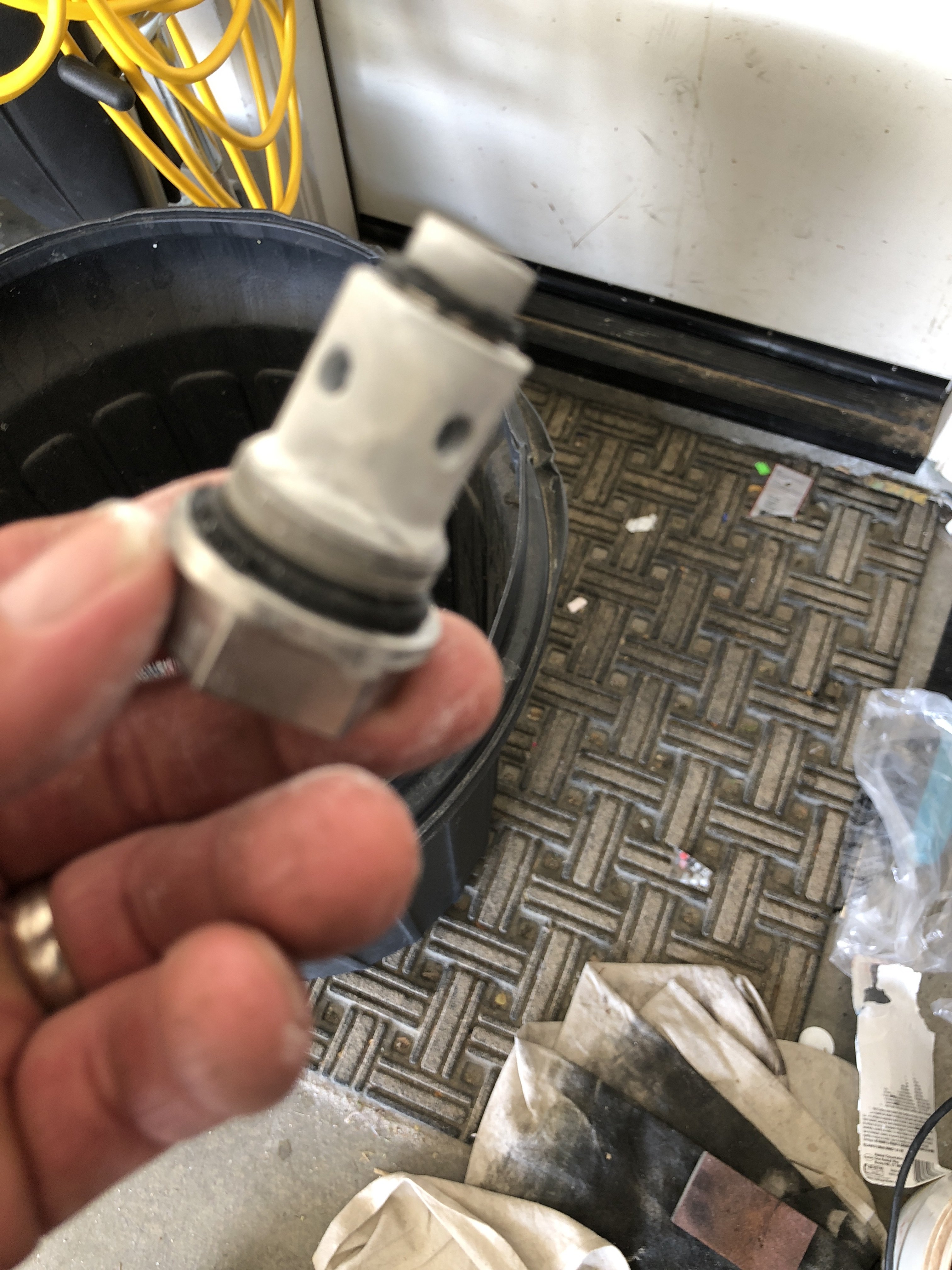

2EDAFC39-31E7-4754-A93C-91DAF0A63636.jpeg 1446A9A9-BEA3-44E5-99B6-D22A5FD0C4A6.jpeg

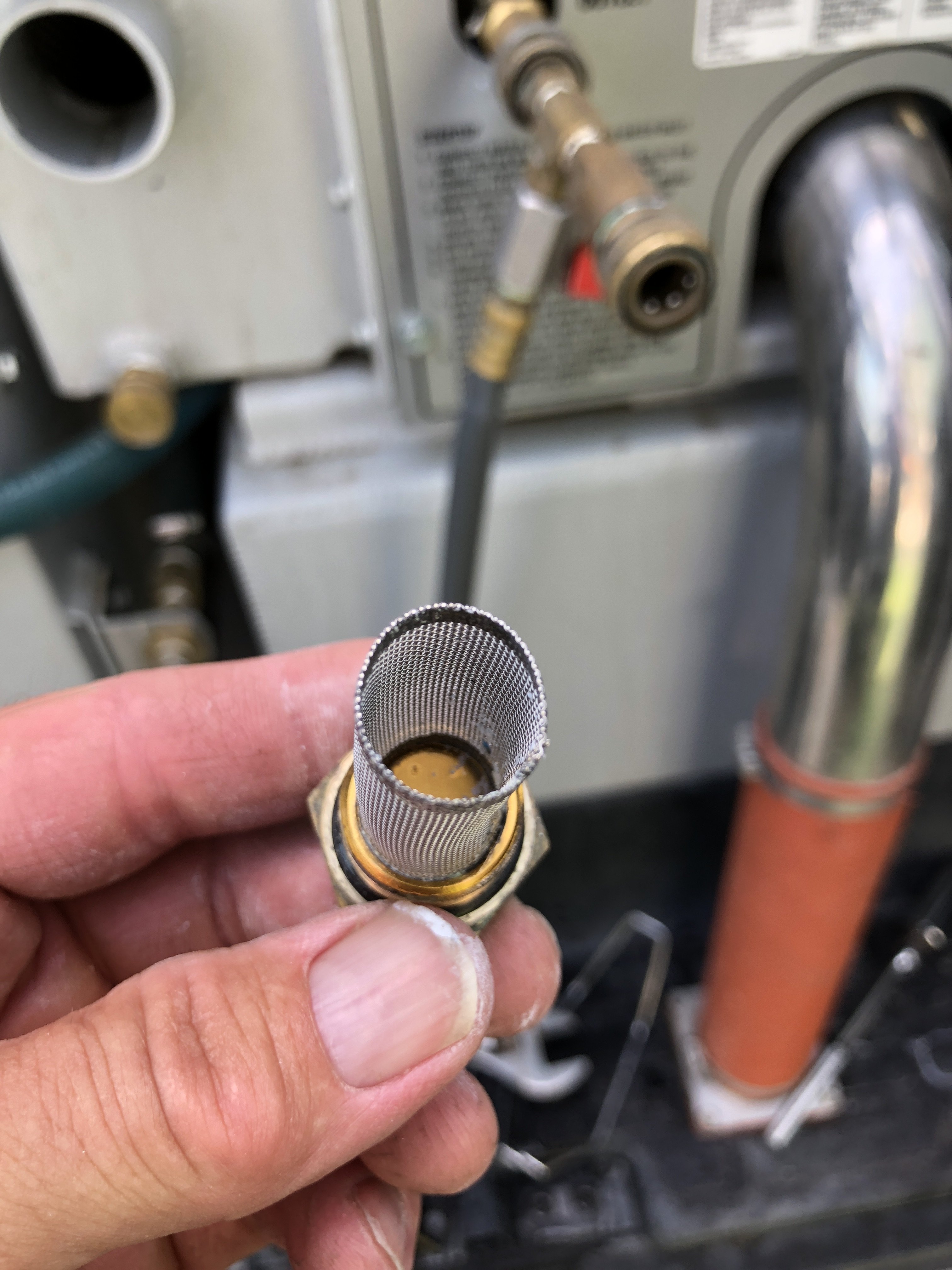

So I’ve had some serious water pressure issue but no cavitation or pump fluctuation
I opened the out bound filter clean as a whistle!
Opened the check valve and scale baby scale
So I called a few people and a dude from Sapphire Ron gave me the most useful advice!

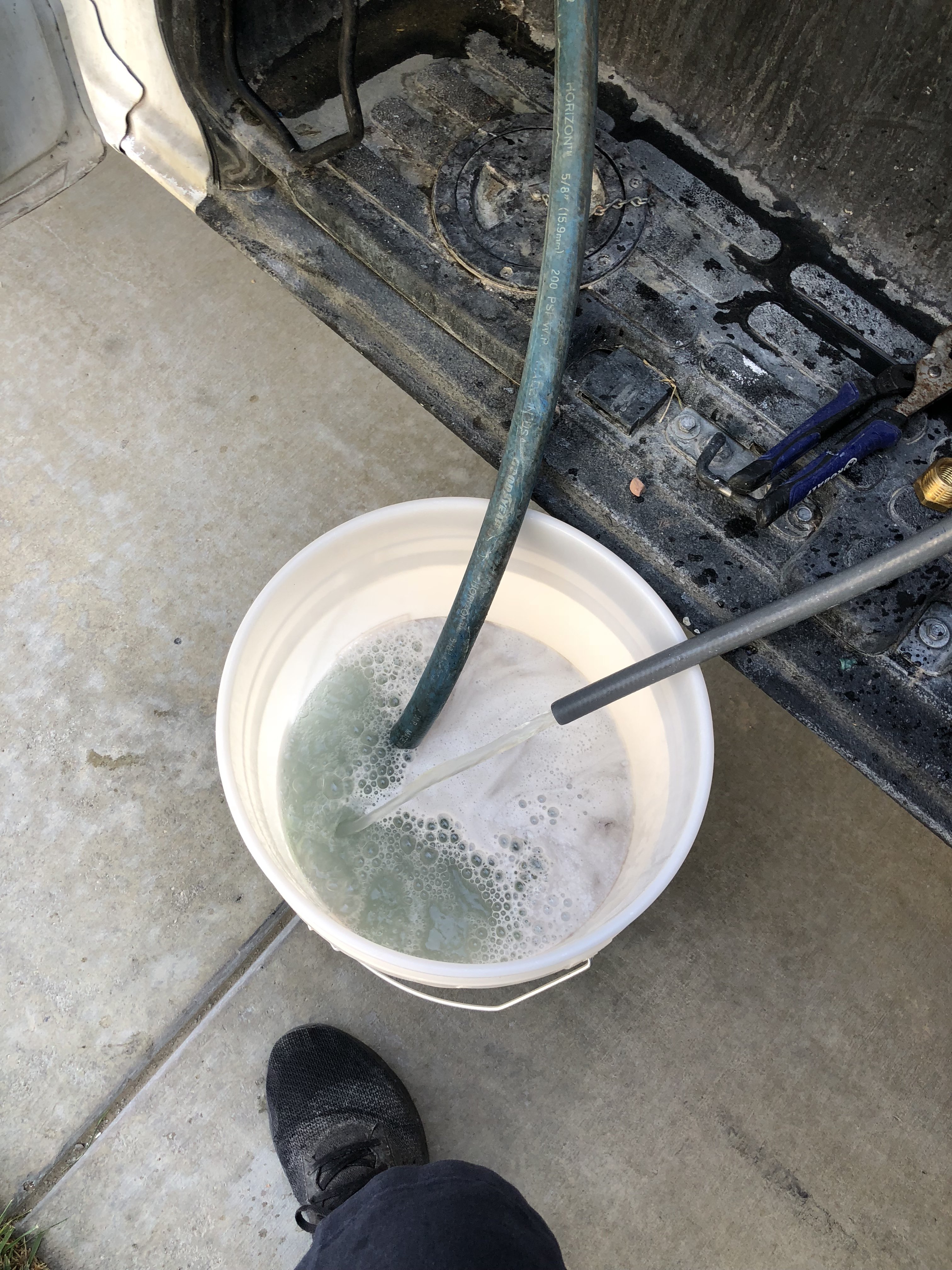

My water mod was empty so I pulled the draw hose off added an extender into a bucket and put Prochem descaler in the bucket then let it cycle for 10 minutes.
The water pressure was back to normal.
I did a couple rat nasties with the lower pressurer today and they took way to long!
Looking forward to the flow.
