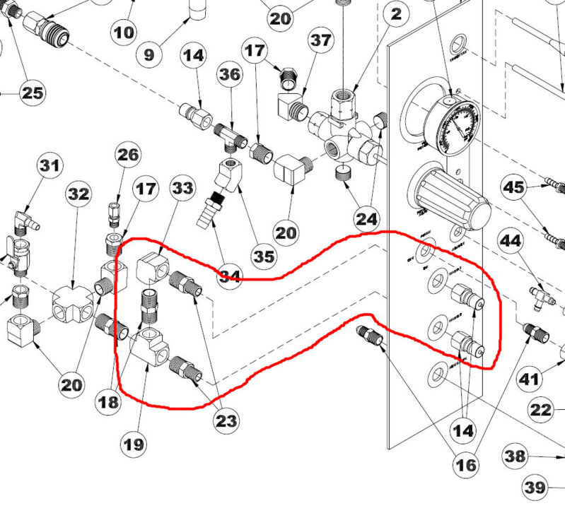

Interesting. According to the manual the two solution outlets are simply teed together:

Someone may have altered the original plumbing. Based on the above both should read identical.
