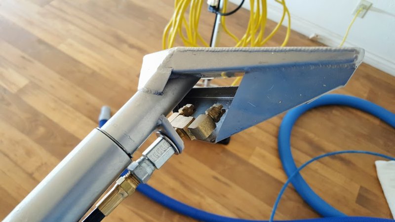

This is a Ti version made with two jets because they like me.
I used a 15" 2-1.5 tapered vac hose.
I hardly ever see stairs out here in Ranch land but I'm finally getting a hang of this thing.. I likes it!

I have been using the PMF stair tool also. When I was up there last time I picked up one of there metal 2" to 1.5 adapters and just pressed it on the end of the stair tool this thing screams.
I was not super happy with it at first, but dam guys it is pretty reasonable in price, after using it on the last four jobs I think it the easiest stair tool I have ever used.
The solution line is just a little short so it makes it a little hard to swivel it for the riser but it is very light.
I have the single jet version and there is a little splash back when going from wand to the stair tool but I just reduce the pressure with the ball valve on my solution line. The spray cover on yours possibly gets rid of the back splash also.
The adapter gave it a little more length perfect for me anyway. I actually really like it, I went out today to get some towels out of my van the carpet was poly and I needed to do so touch up on the bullnose, I could hear it all the way out at the van the thing was screaming, the water recovery was VERY good.
I'm pretty happy with it, I think I will do the @Mark Saiger two jet set up on it and call it good. I don't have glide for it, I don't think I'm even gonna get one as I like the extra scrub with out the glide.
The first time I used it it was on CGD carpet on stairs and I didn't adjust pressure so it kinda got off on the wrong step lol, kinda pissed me off, glide might have helped also for the cgd steps.

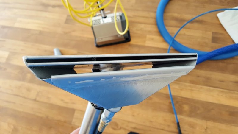

I like the splash guard Tom, it also helps keep the slot at the correct level.
The hose is an inch too short though.

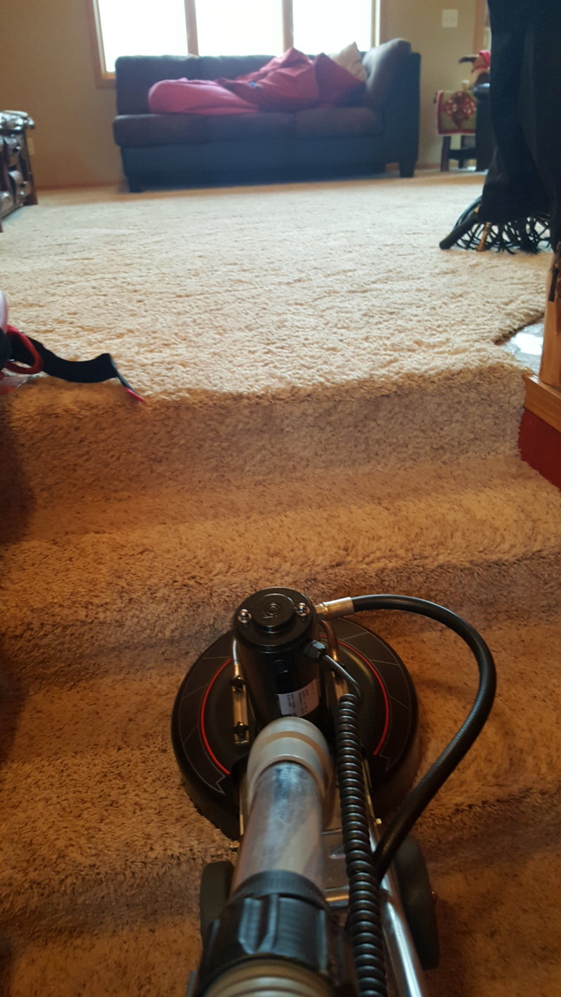

If, and at the risk of repeating myself continually, you guys are looking to take it to the next level in your stair cleaning abilities, get a RotoVac StairPro.
For all the positive comments on RV brush heads and their world changing performance in cleaning trashed carpeting, can you not see the benefits of a tool that will clean stairs to the same degree?
I've watched the videos and listened to all the varying opinions, and every staircase that i clean confirms my belief in this amazing unit as the one to beat for cleanability and versatility.

Yeah I had to add a brass extention to the SHORT solution hose so that it would swivel all the way.

Sorry Mark, but the critical part of the stair (the nose) is not really being cleaned.
Makes sense, once you look at the jets' angles due to the length of the tool and not being able to bend following the contour of the stair's nose.
That's always the worst part of the stair. Due to ground in soil and wear. It is also the area most susceptible to wicking.
Unless you get it cleaned well (in close and personal:winky: ), sorry Mark- No cigar.

Seriously, I have been using the pmf swivel lately, (it came with a used tm I bought recently) and although I agree on lengthing the hose so it swivels completely, I like the single jet. I am using a 11006 and I find flushes over the bullnose extremely well. I wouldn't put a glide on it as it really digs into the crevice between the tread and riser. A shield would be nice to limit over spray but the over spray isn't bad with the single jet. Very powerful little tool.

I don't see how you clean the bull nose with a Rotovac? How do you hit the risor and maintain a seal on the bullnose? :headscratch:
Reactions: Doug Rice
Pull it over the nose like any other wand as needed....
Use the cuff to extract any excess...if still soiled...hit again.....
No really problems....actually faster for now.
but we agitate and agitate the bull nose with our 10 inch crb....
The thing isn't perfect...yet....but I have been talking with PMF in the past to change the jets....
Might happen soon....
