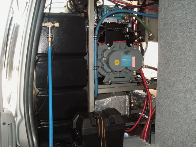

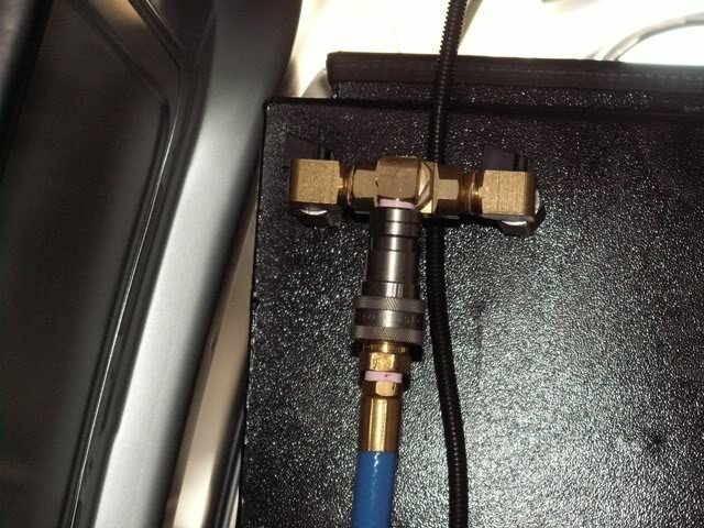

We are starting to play with 2.5" ports on the existing Genesis.
We'll see how it goes and I will post some photo's up on here down the track.
For getting access to, and cleaning the tank however, we retrofit the stainless steel waste tanks with a jet system as shown below.
With the two different taps on this, you can turn one of them off, which then cleans the top and sides of the wastetank, then open the other tap which then floods the bottom part of the tank from the back and pushes everything on the bottom toward the dump port.
