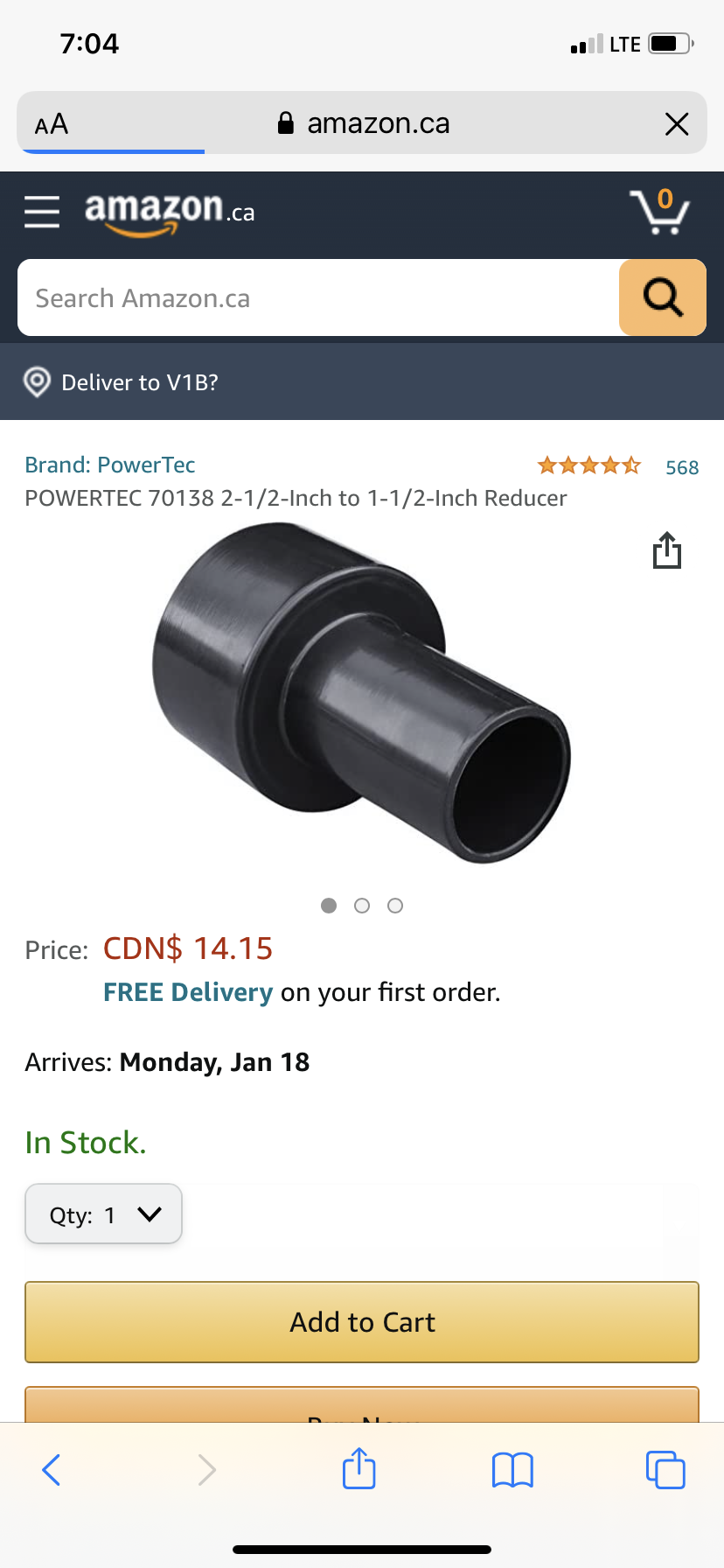

Those of you who run an 1.5" wand, do you prefer to use a whip hose or do you use a converter cuff and run 2" straight to the wand?

Easiest thing to do is a 10 ft whip. You won't have any appreciable drying time difference using a reducer cuff. The whole purpose of the whip is to reduce the weight and stiffness of the hose, making easier to use. I'd love to have a tapered whip if they were more durable. I heard Tom may have something.

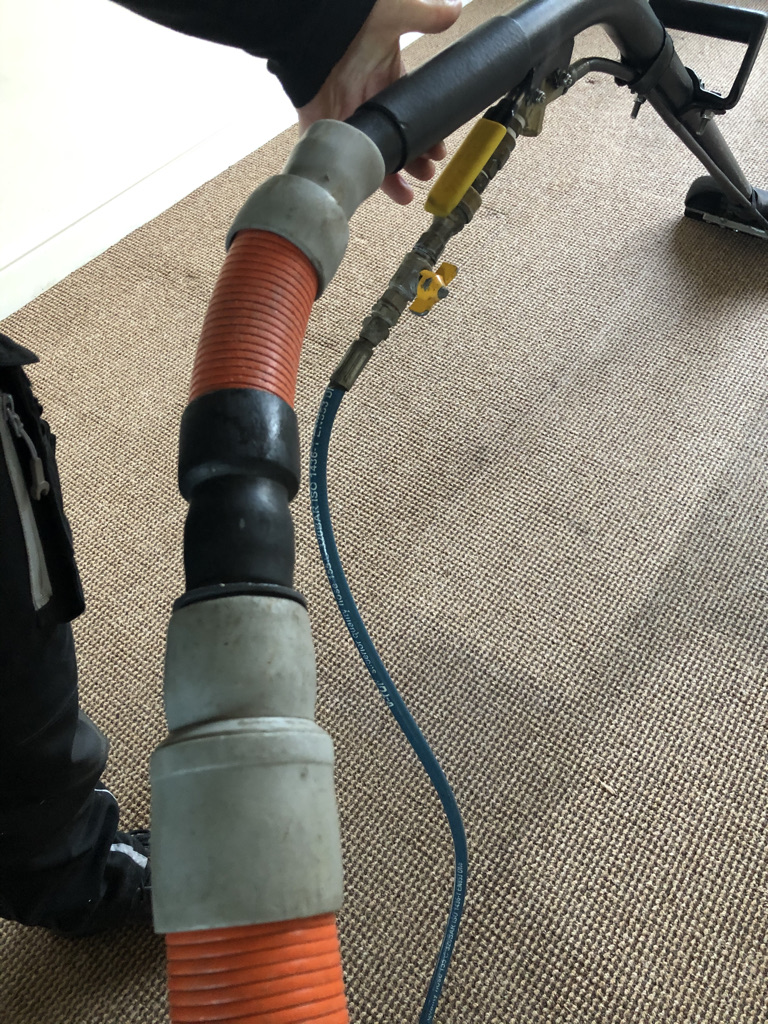

I use a 10 foot whip flexible 2 inch hose right up to my 1 1/2 wand
6,564
So 2.5 to 2 to 1.5 makes sense?
