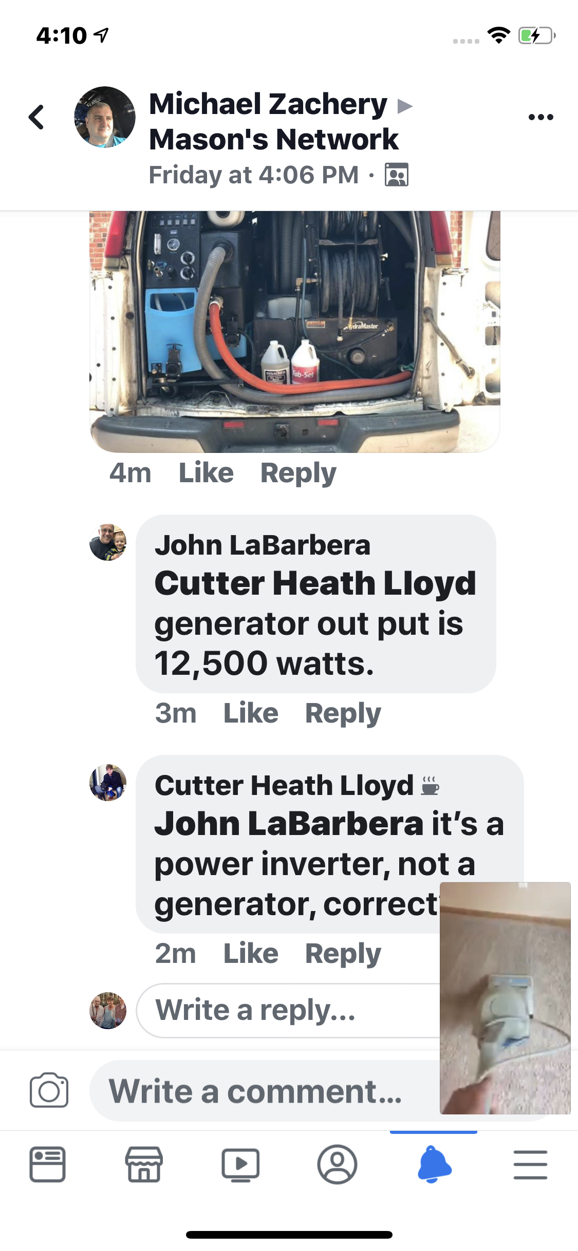

"we have used this generator since 2012. Absolutely no problems. No maintenance. The ecu was placed too close to the 210 degree heat exchanger. The generator did not fail nor did the ETM. The ecu needs to be moved. That will be some next week. We’ll post the video than. Both the ETM and the generator is proven. The exchanger was install after the generator was."

This headline will have you locked in the closet if your wife sees it. By the time she lets you out this mytee fine idea will be cancelled.

I just don’t get when it’s show time and there’s money invested! How could they not know about the problem?
I mean for god sakes clean some carpet with it and make sure it’s gonna do what you say!

I like John, he was a good board contributor. there a lot of people here who
Liked him, I could see he was a little stressed trying to spin it into a positive!
But I would fire someone for that mistake!
On a positive he was saying if a vac went down a guy could swap one out easily and keep working.

Apparently it ran the first day, but one guy said it didn’t feel stronger than his 3.3 blower! Whatever that’s worth.
I don’t know if they had all four going.

did the specs say it was a 7k generator? I think a 10k is the minimum gen. one should have due to conversion of DC to AC loss.

The Xdrive is basically an ETM with positive displacement motors, powered by a generator and invertor--
So the Xdrive is actually the most powerful ETM IMO.
Since the xdrive doesn't really save any space in a van, might as well go with the a Titan or other slide-in.
