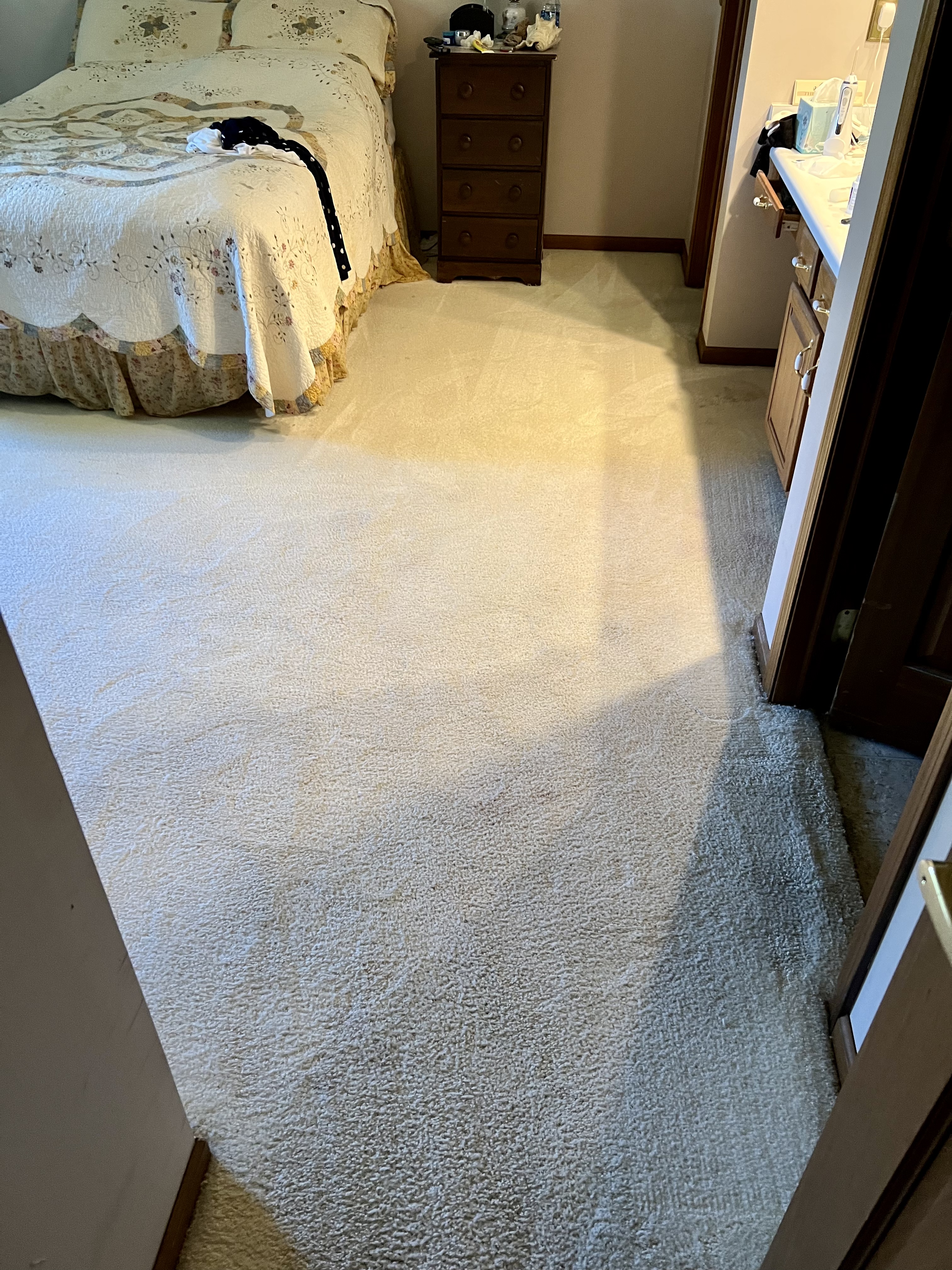

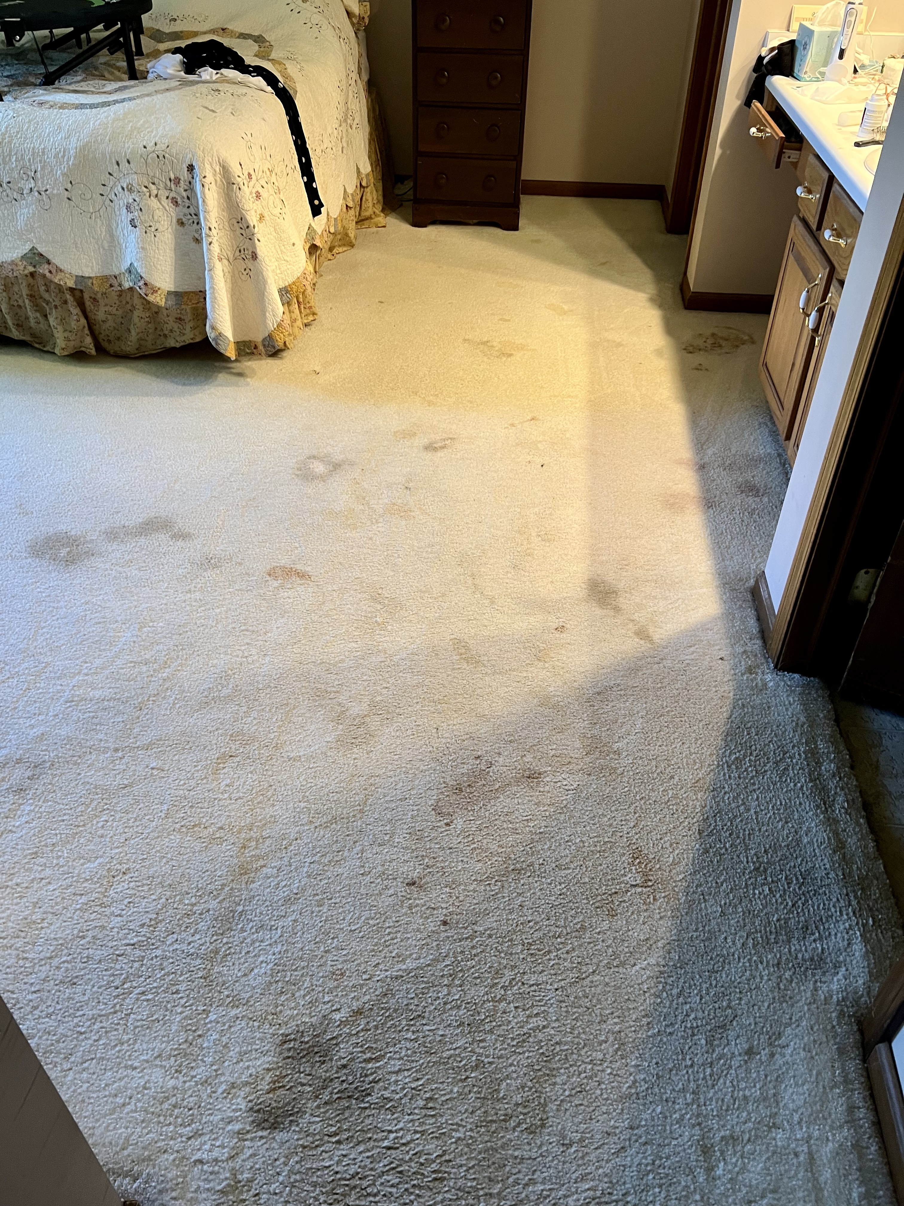

Old lady, cat room (puke).
Odyssey
PCP, TOPS Spot, sodium chlorite & red out
Scrub pad
3 Glad pads (until the pads weren’t dirty)
Yes, I rinsed after this pic. My waste water wasn’t anywhere near as bad as I thought it would be.

And I scrubbed with the Trinity, two different pads and then rinsed with hot water. Pretty sure it wouldn’t get any cleaner than that. She got a Hella cleaning.
It’s also carpet from the 90’s.

I was experimenting with VLM. I knew it was going to be rinsed.
This was about showing what the Odyssey can do by itself.
There was no actual puke on the carpet when I got there… just the stains. Her neighbor used a brush and Green Machine prior.
