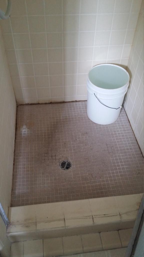

you mean like this nightmare I looked at yesterday?

that one's a doozie.....did ya do it....
how much would it take for a grown family man to climb in there and do that.....
i think i'd rather stand on the corner wit a cardboard sign
