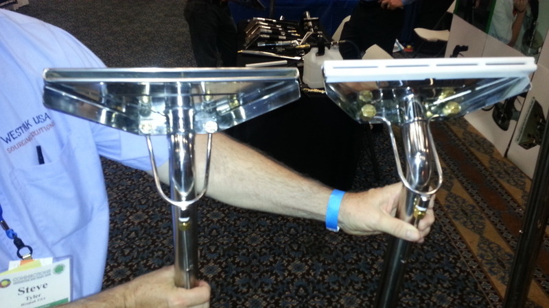

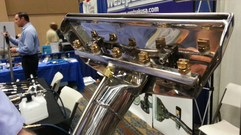

A new way to put a full length spray bar on a low profile/two inch tube wand..

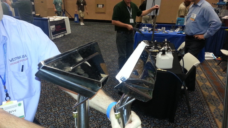

An AW29 with a lower profile and an included glide
any other pics of the full length spraybar? Did they just clearance the shit out of the tube with a BFH? Airflow?
When you mentioned it on the phone I envisioned something a bit more elegant........
and who did those welds?
and am I allowed to ask these questions?:lol:

Yeah..I'm wondering about that choked down tube ending as well...or is it just to get the velocity up and that supposed to have equal lift at the wand lips? I'm not sure thats a good idea...
But maybe....if we put in a choker at every 50' section of a hose run to speed up the airmovement maybe that would work too? kinda like putting in a 1.5" connector in your 2" vac line at every connection.. anybody tried that before? This maybe the stupidest thing I ever thought of...I need coffee this morning.
Are angled jets just another BB fad?
yep
as the shear angle increases, you lose penetration.
to compensate, one must increase PSI and flow
what ends up happening is...(besides spray/splashing ) you just use more water for same clean as less PSI with a "normal" wand
BTW, that wand doesn't appear to have a bad (excessive) shear angle
