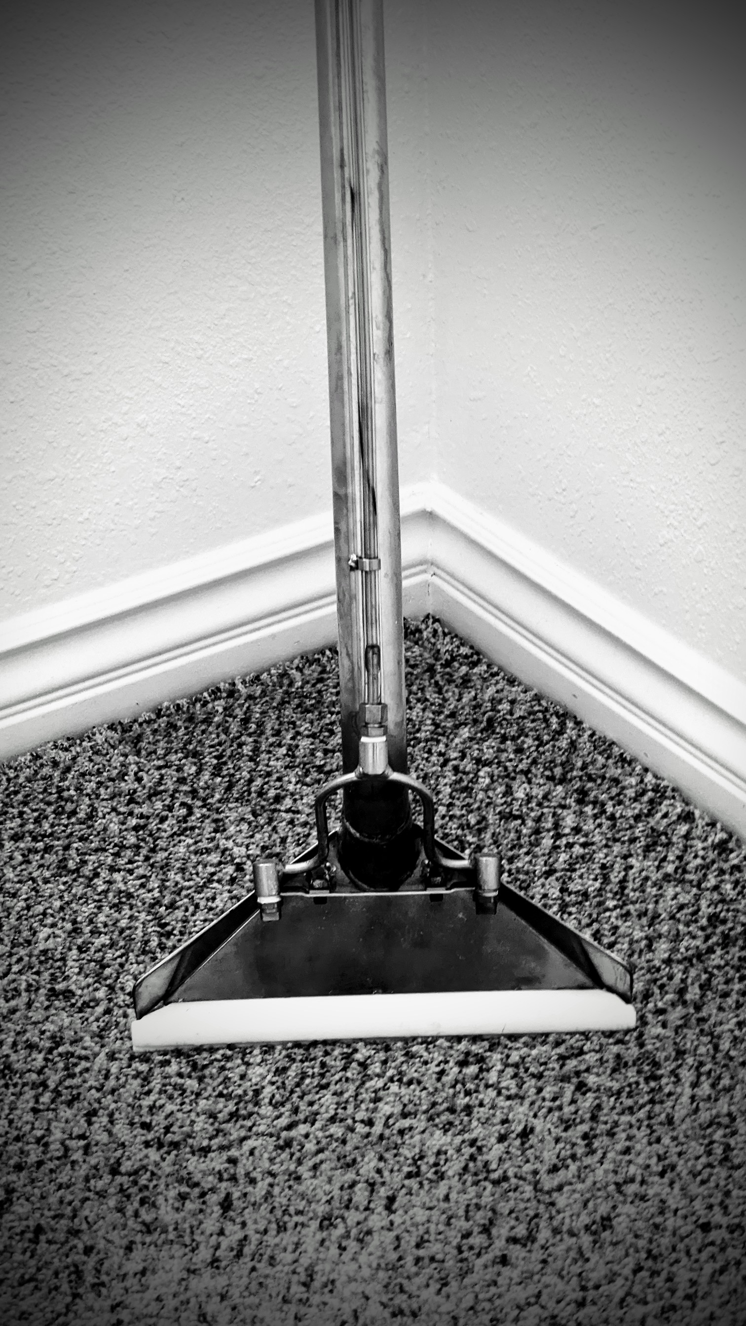

Just sold 3 Glides to one company for this beautility wand. PXL_20230621_190343997.jpg
