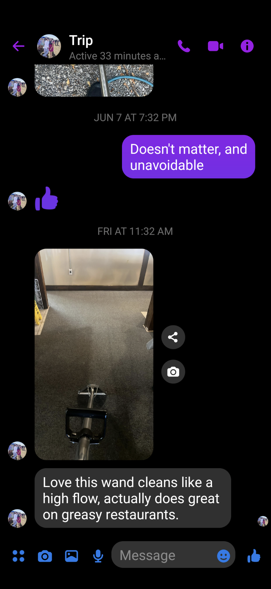

THIS IS NOT ME. THIS IS A DIFFERENT TRIP. I DO NOT DO RESTAURANTS. I AM A HIGH END HACK.
