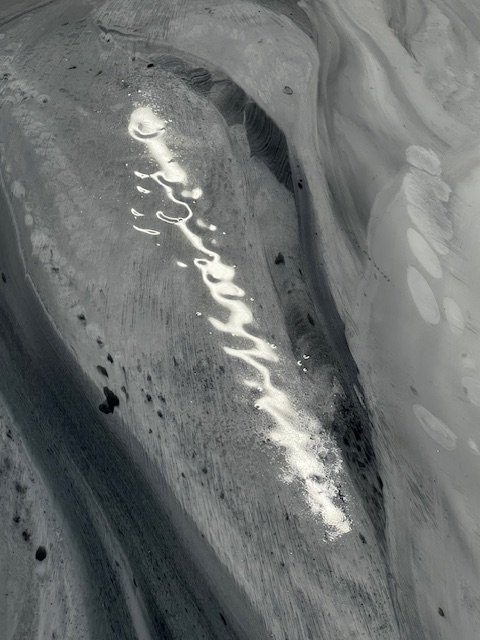

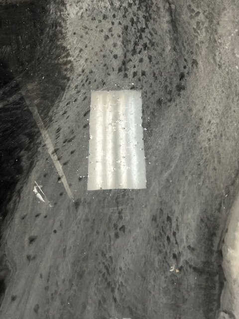

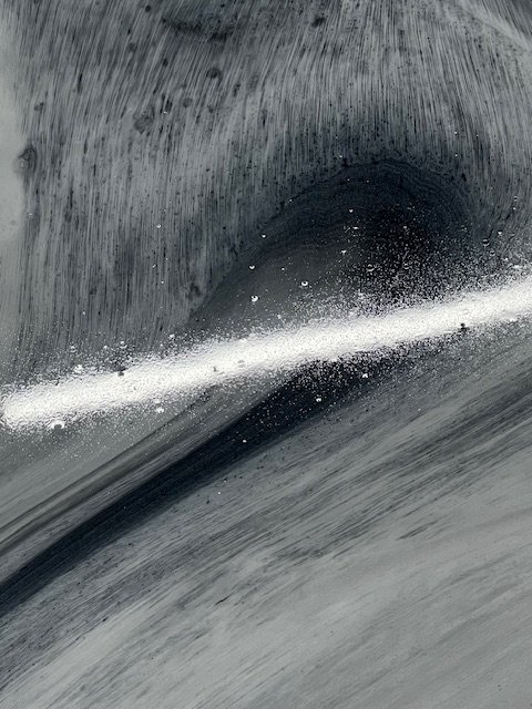

Then they put epoxy on it and there were bubbles everywhere. The buffed the epoxy off with a rotary machine back down to the color last week Tuesday.
Then Thursday they applied a coat of epoxy and another on Saturday night. Monday morning it still had bubbles and other issues and still is not right.

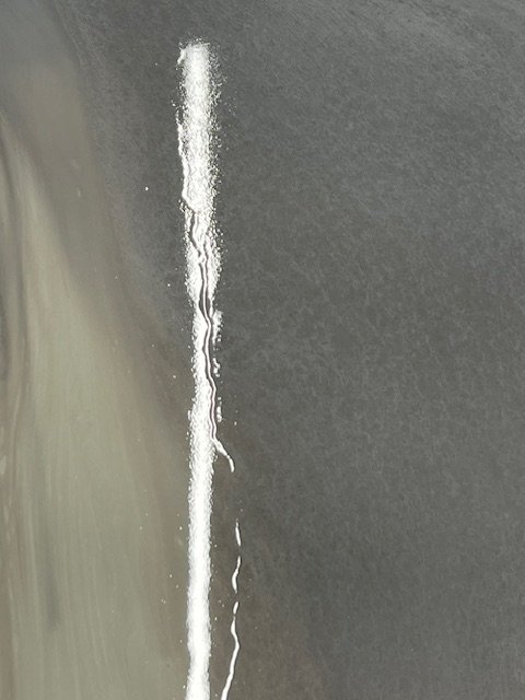

They knew we were having a plumber come in on monday and although we put moving blankets and cardboard down the floor got scratched in the bathrooms

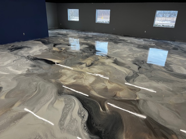

initially he was thinking of this floor which I think is a polished concrete.

i guess my initial question is would the bubbles be able to be buffed out?
117,322
Are the bubbles from moisture in the concrete?
Buffing scraping or anything to get rid of them is going to cause dimples, right?
not likely. Depending on the severity it will need to be sanded, cleaned with acetone, and recoated.
