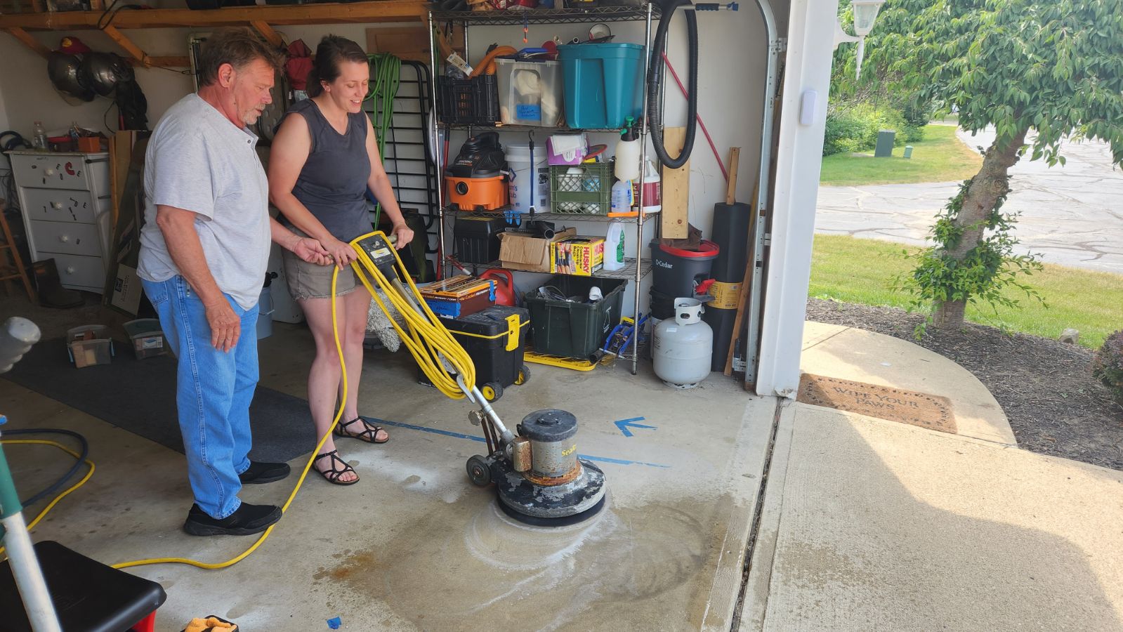

A 175 is a classic and rugged scrubbing machine. For scrubbing it can't be beat. Although it weighs about 100 lbs (depending on the model, I'd recommend 100 lbs or less unless for stone resto) with small wheels so bringing it into places needs to be considered, not for standard res cleaning. It can be used for stripping finishes, agitating hard surfaces and carpet fibers, as well as vlm. Great for commercial, trashed residential, and high paying hard surface jobs especially restoration if you go that route.
They are very affordable too and tend to run forever due to the simplicity of their design. Often ugly as heck from regular use, but can be found for under $500 used on the marketplace just about anywhere. There are a multitude of pads and brushes available for different applications with a 175 in standard sizes that easily fit whatever machine you might score.
Here's Uncle Larry giving my wife a demo when he kindly hooked us up with his old 175. Hope ya don't mind the public pic Unc! Let me know if you don't jive and I'll take er down.

It’d be nice to remove 50% of that pic, and we can agree which 50? But, we don’t care, he’s nice. Don’t let her or you get to you use to her running that machine! Mine ran one for at least 20 yrs., before the demand took its toll.🄲 Even though they’re easy to use, they’re demanding long term.

Good call Kenny, I'll keep that in mind! My wife is already sleeping but I know she really appreciates the thoughtful advice.

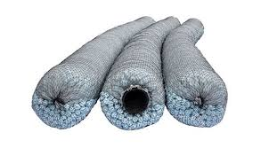

I kind of get the idea you don't understand how a drain field works...
The local county toilet police require us to bury styrofoam or plastic tubes to drain our septic water from the tank.
you talking about this stuff?
it's more expensive than gravel and standard sewer pipe, but is quicker/easier to use
as far as septics, most that are 30 years old would fail a test
when we get a house that has septic probs, we spec NPDES type because they can be installed anywhere and discharge into the ditch that runs past Bryce's front yard

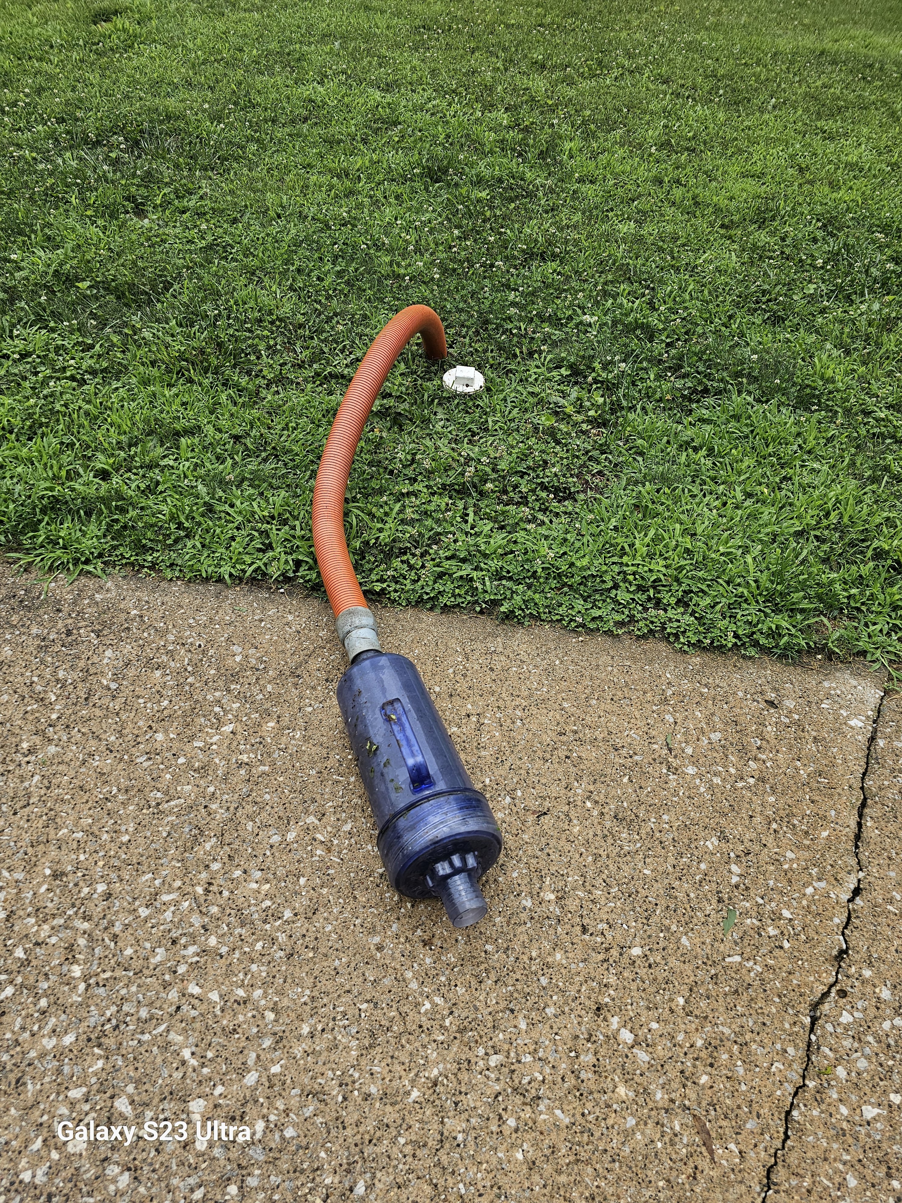

Phosphates and other nutrients in the recovery water that plants love.
The only time you don't want to dump in their yard is when you're using strong peroxide treatments on the carpet. It'll chemically burn the grass and you'll get a callback
Just make sure they are not on a well.
I have a clean out in my yard that I keep a hose in for dumping. I use a filter as I'm dumping.
