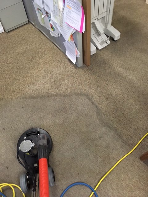

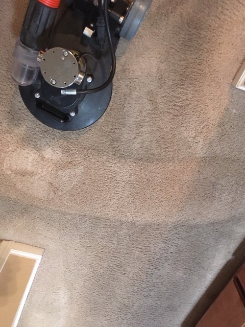

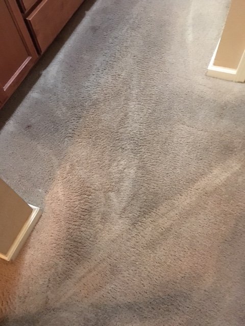

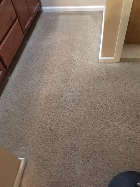

I wish I had a Trex and the additional brushes when I was scrubbing restaurants. I never go in for my own before/after photos and I think this is the first one I have ever posted. Saved my bacon on residential and commercial this week.
