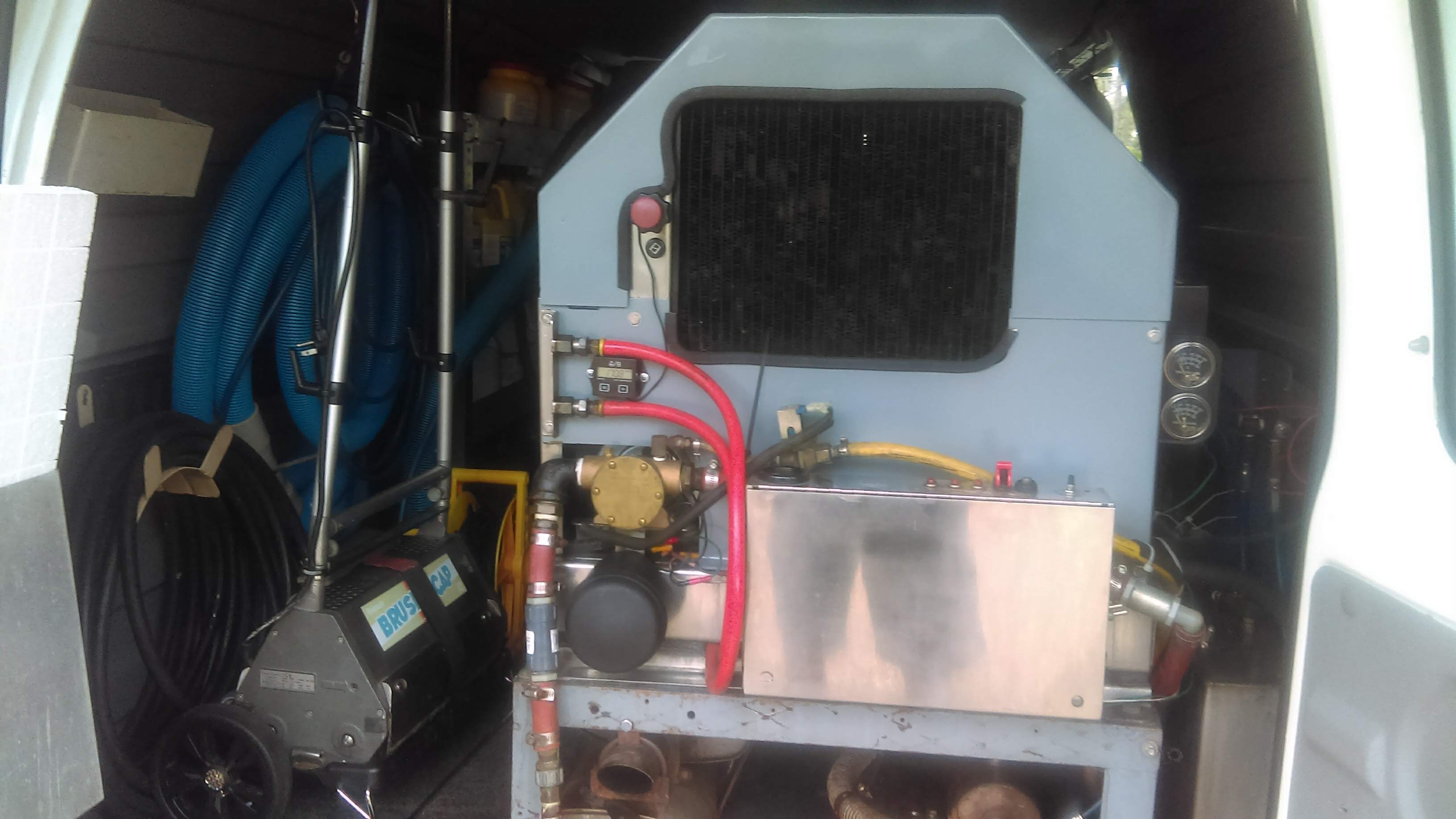

My former employee and future 3rd cousin just scored this van/unit for $5k..
116,197
He might have some insight from Butler.
Just let he and I discuss this.

I wonder how long he could pull a Damon for with Google adwords ..
View attachment 112663View attachment 112664View attachment 112665

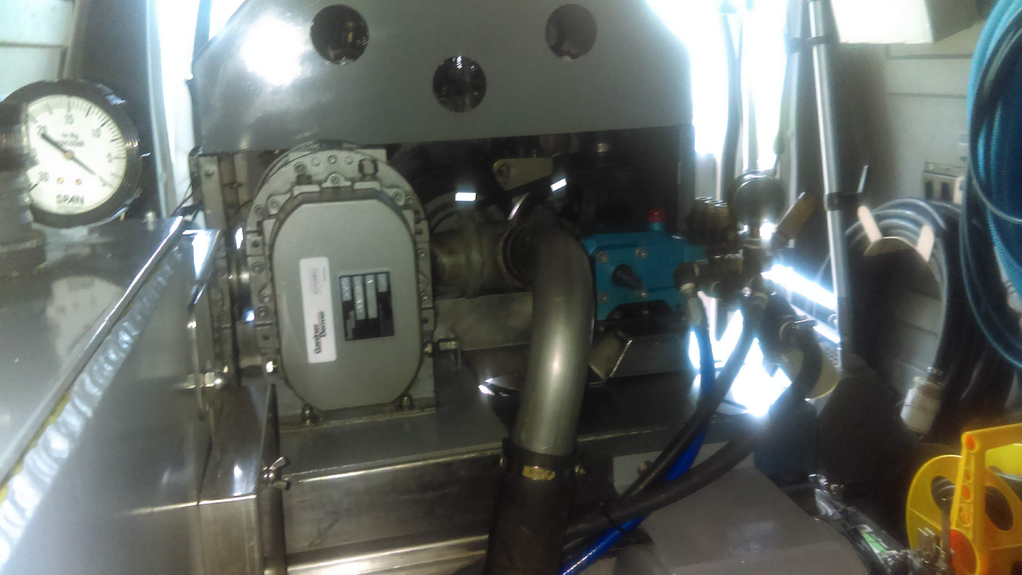

I have one that I've run for years. I built a frame to raise mine up so I didn't have to cut a big hole in the floor and changed out the 56 for a #4 blower because it's only a 21hp Kubota. Got rid of the all metal pancake coolant hx and replaced with a stainless steel one and added a ss exhaust hx. Simple to work on but it eats up a lot of your van space.

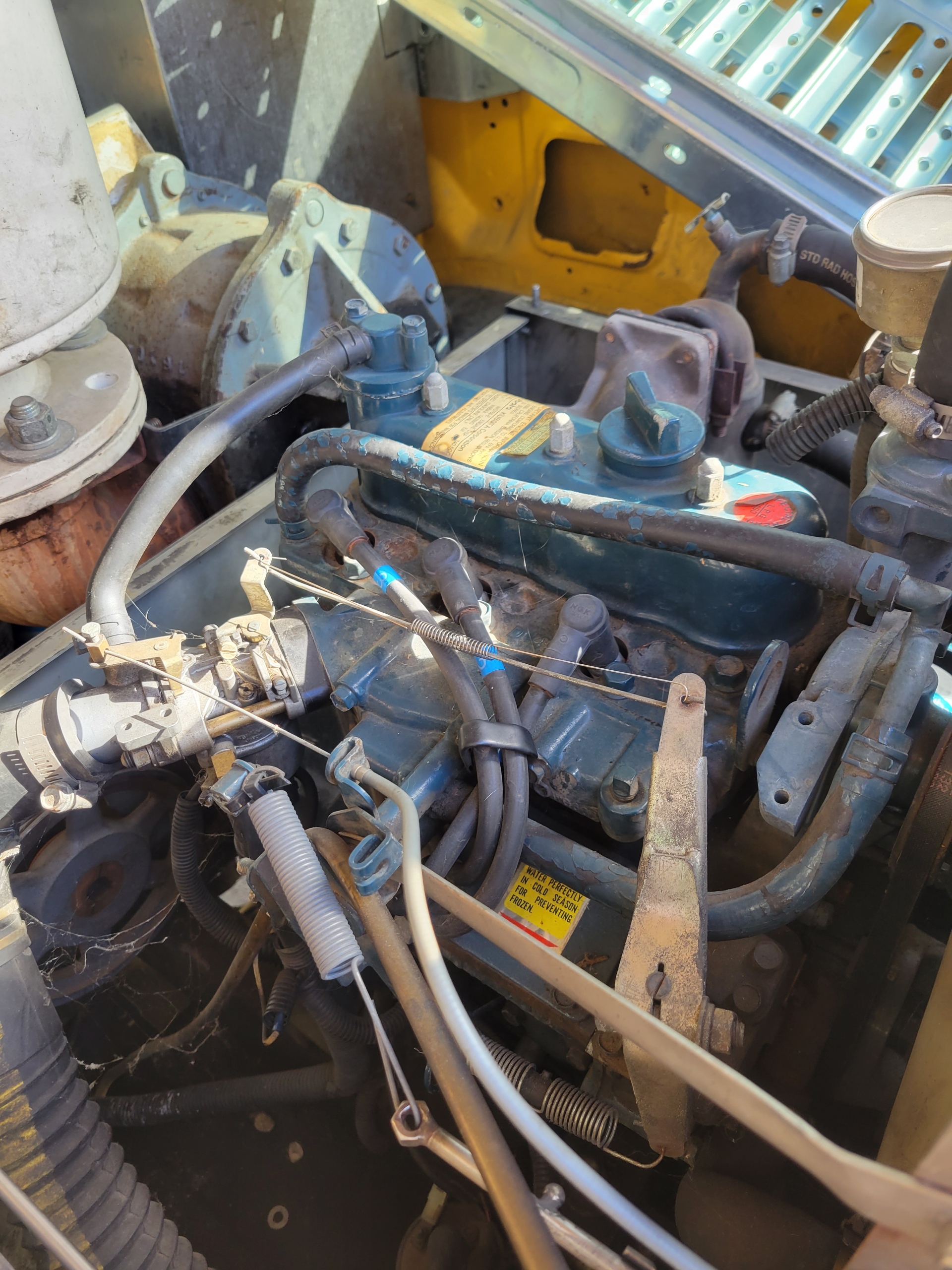

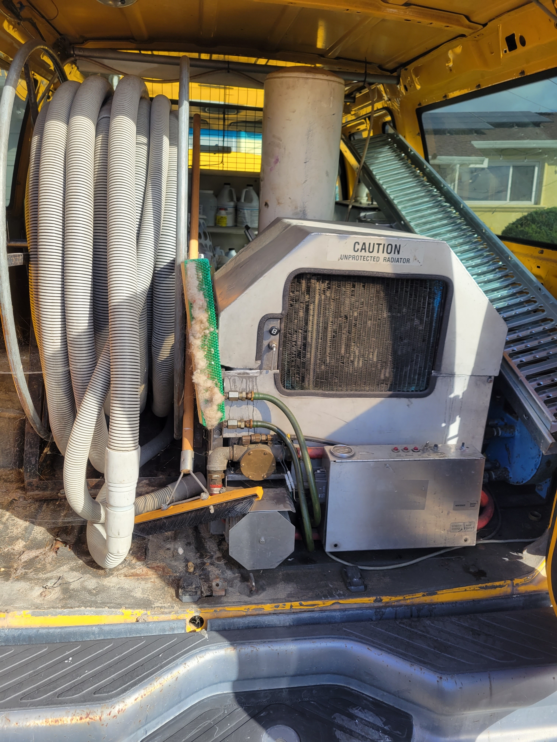

View attachment 112821 View attachment 112822
You're probably one of the cleanest carpet cleaners I've ever seen, or master at Photoshop.
