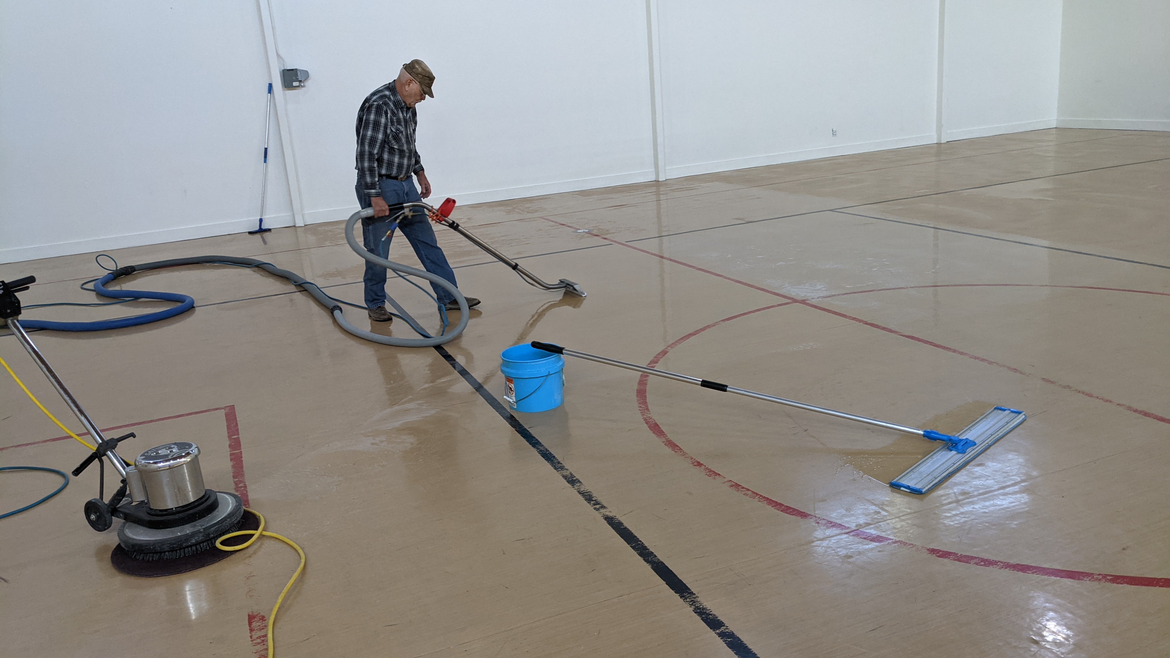

BB court to do today.
Neutral ps, SPP, GBG/370 rinse
3800'
with my 78 yo old helper
Go back tomorrow to lay down 4 gallons of high solids.
underneath is 80 existing layers of a faux bamboo sheet vinyl with the painted court lines.
$2600
Military housing.
thats it.
