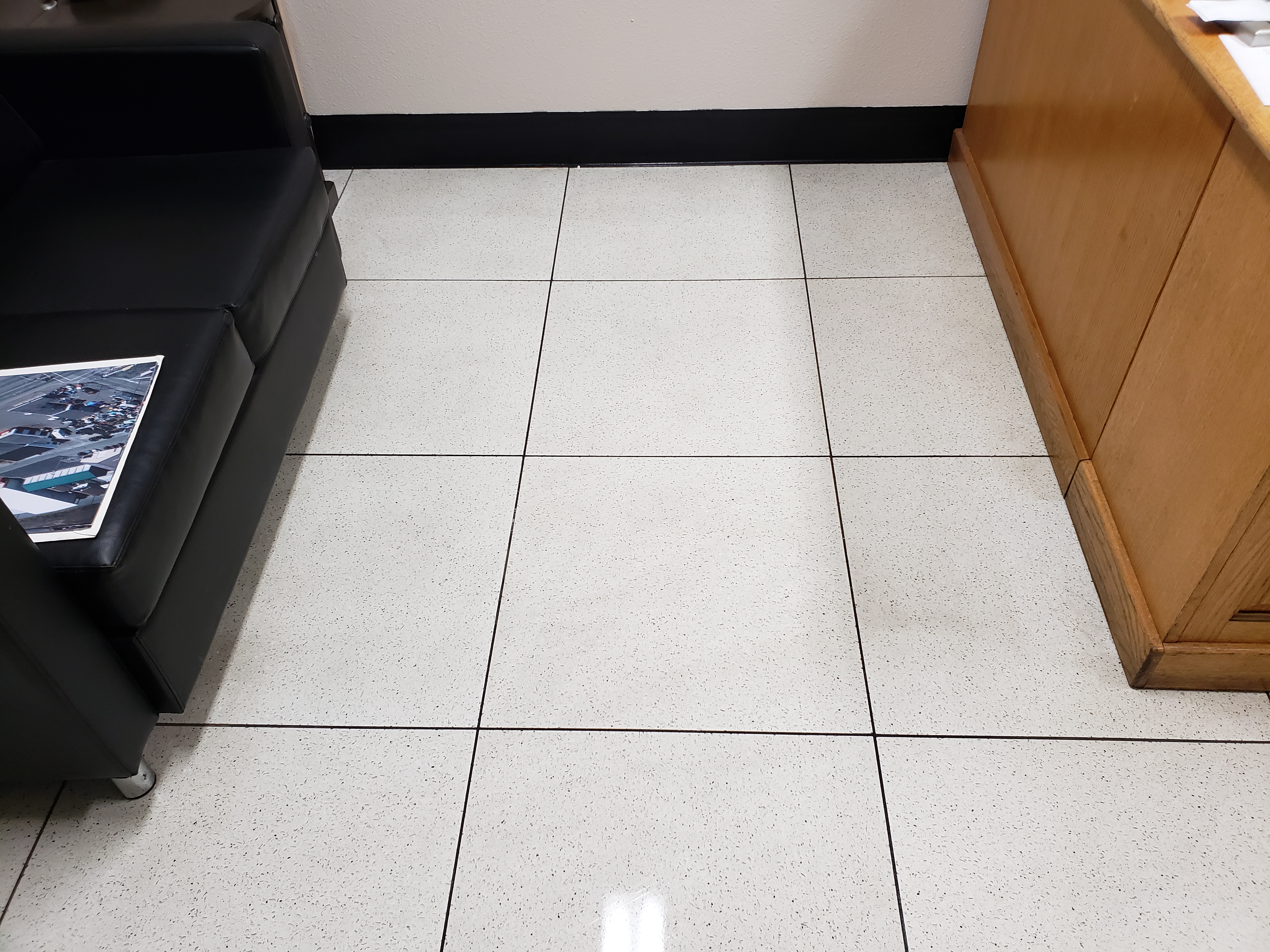

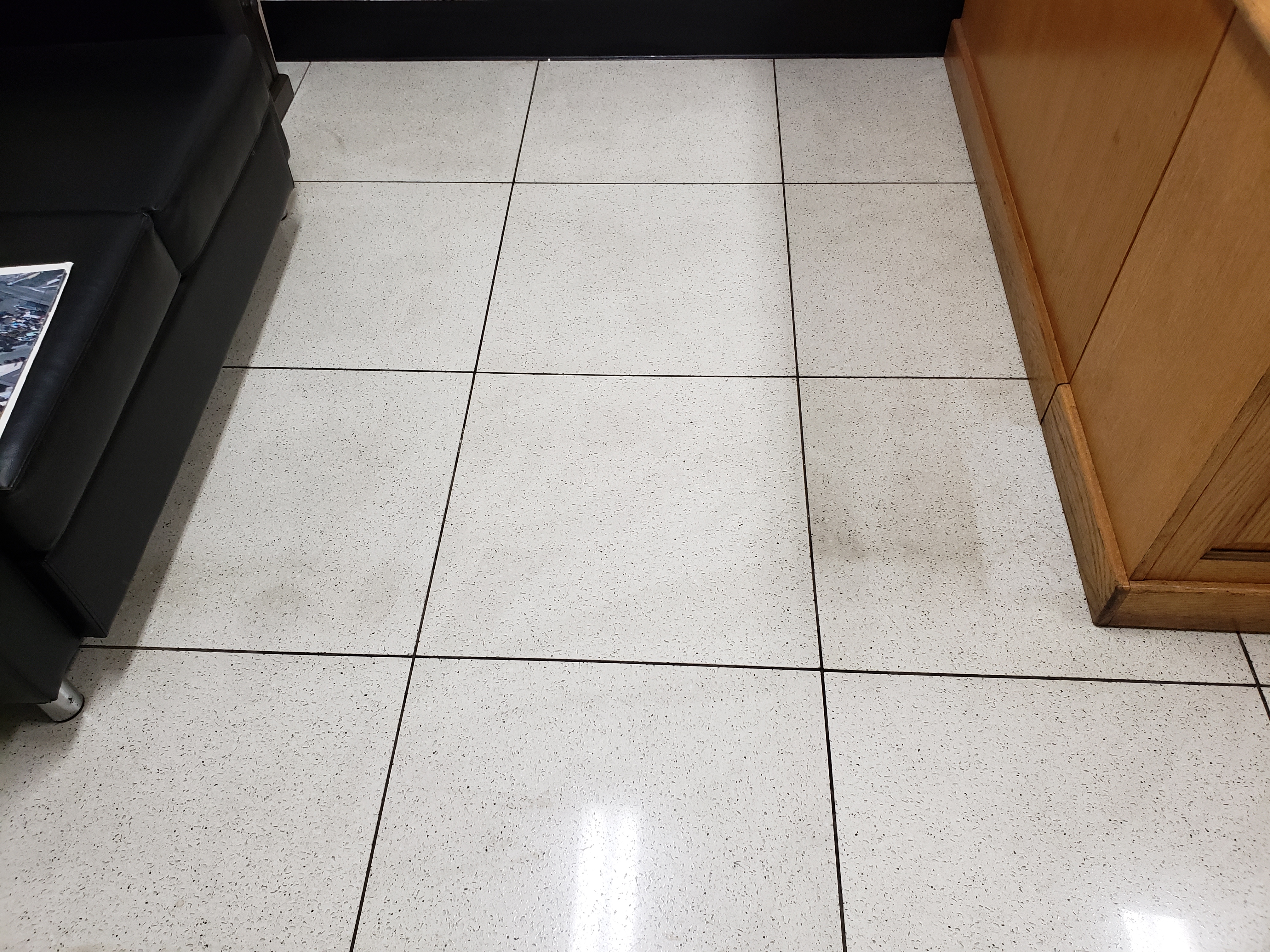

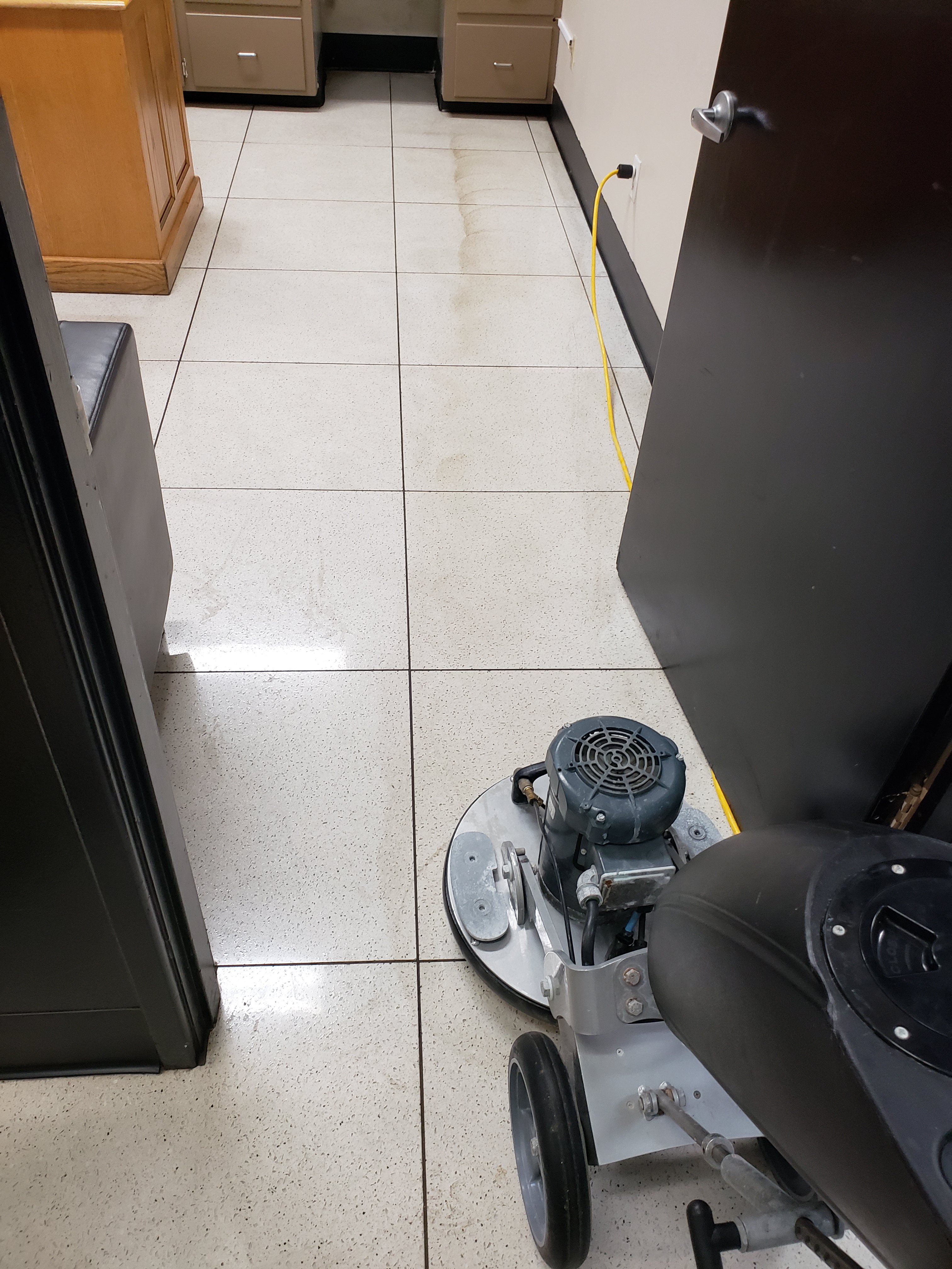

I have a janitorial account with a really strange floor. It's a chain tire store that tried this fancy new floor which claimed low maintenance costs and all that stuff... here is the link to their website. Some trendy(pub intended) "eco friendly" floor that costs way more than it's worth. Anyways it has been impossible to keep looking clean. Its "non porous" and you cant use anything abrasive to clean it, but it seems to absorb stuff and stain. So it's useless. But anyways it's like 2500sq ft so i didnt want to flood the place with acetone or bleach like they suggest for a deep clean. I had a melamine pad from my orbot vibe package. They call it the ultra lift pad or something. I tried a small spot and it didnt take any shine off, so i went for it today in an office. Worked amazing. Pictures dont do it justice, sorry. The pictures are all after mopping, so the dirt just usually doesn't come off. This helped a ton.

I didnt do the whole place. I did the one office to give them a sample. I'll charge about .40 sq foot if they want the rest done. The pad didnt really show much wear from what I did. The pads are $25 each or so, but worth it in this case. If you have one from that orbot promo try it. You will be surprised.

I just mopped really quick first to get what dirt I could, then used the vibe while it was still wet. If you want to test I tiny area first you can use a mr clean eraser sponge. Same thing as far as I can tell.

I think keeping the pad wet is important, because if it dries out it will destroy itself. I was using g the orbot vibe skills I was going to use the onboarding sprayer to mist water In front of it as needed.
