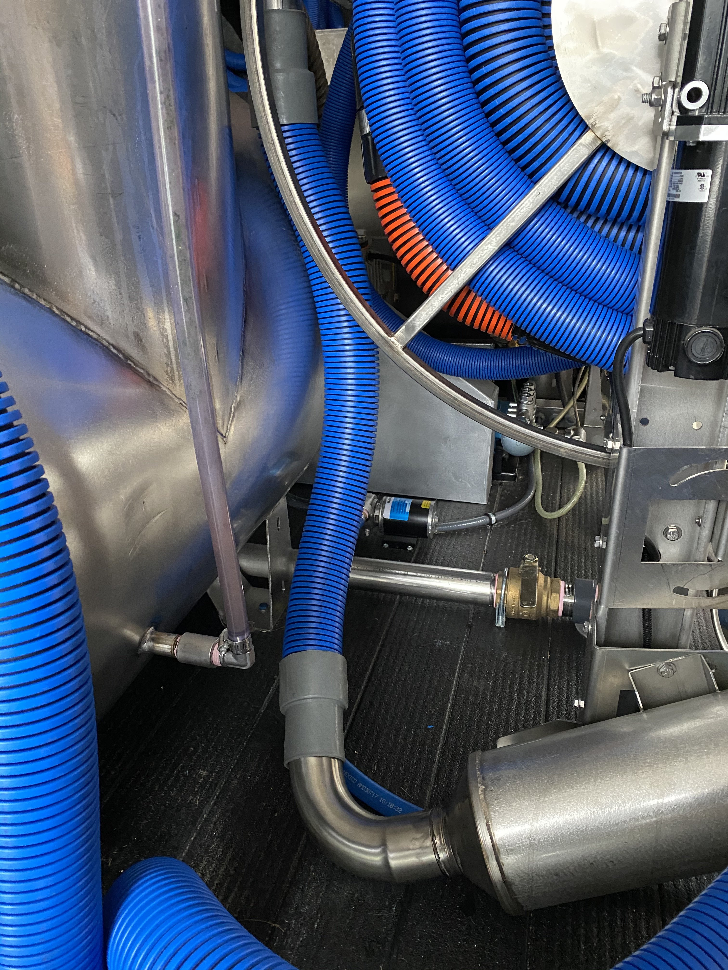

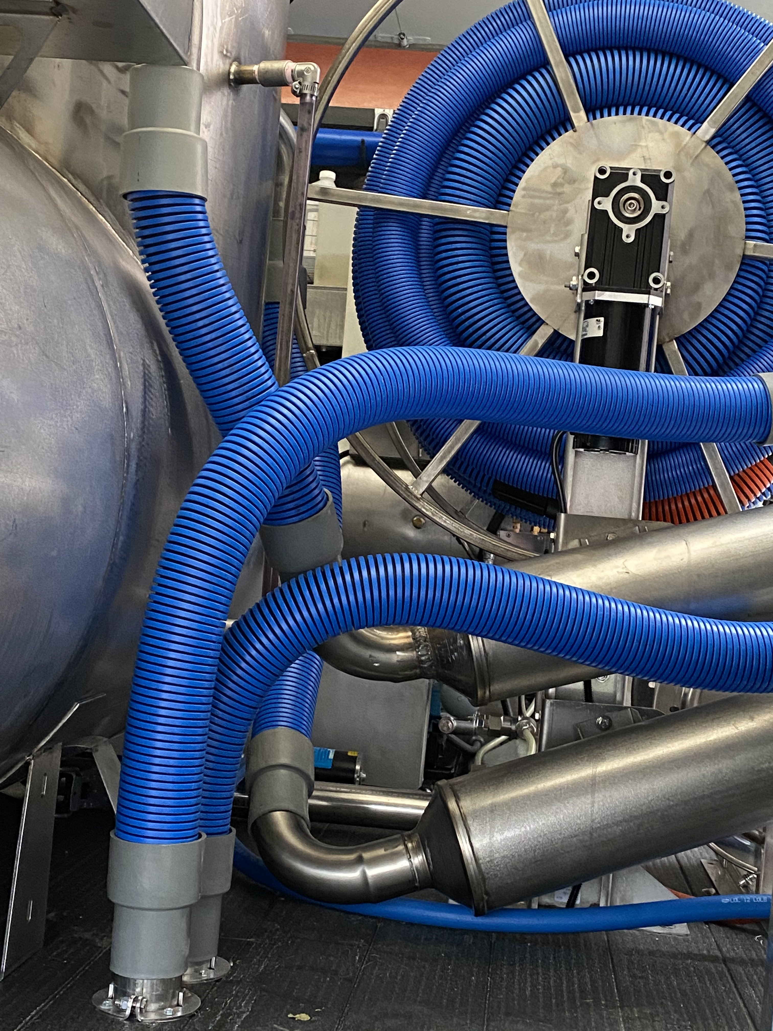

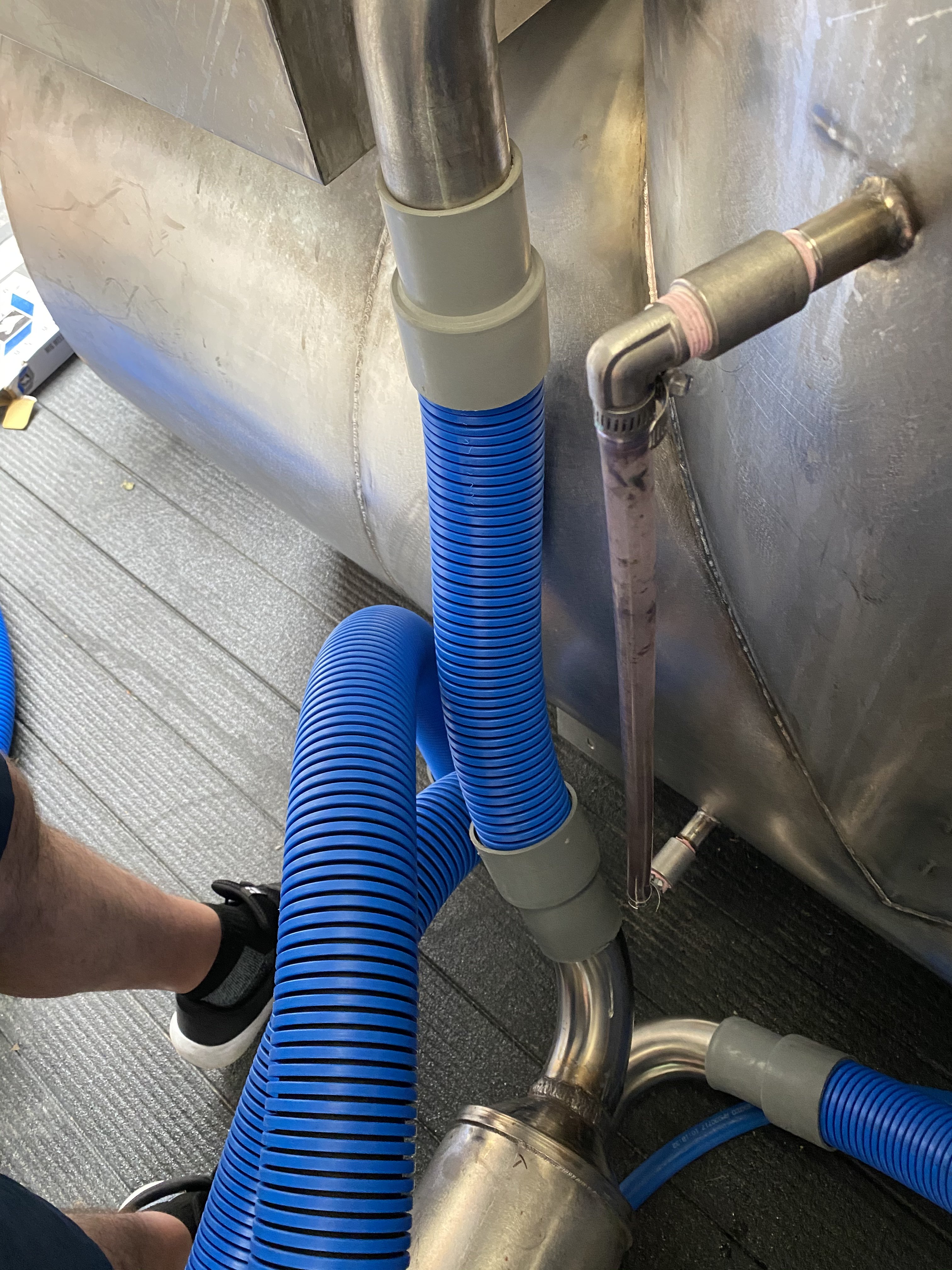

Aerotech had 8feet of 2 1/2" hose from the waste tank to the filters. I ordered a couple sweep elbows and made it 3 feet. no more kinks:)
