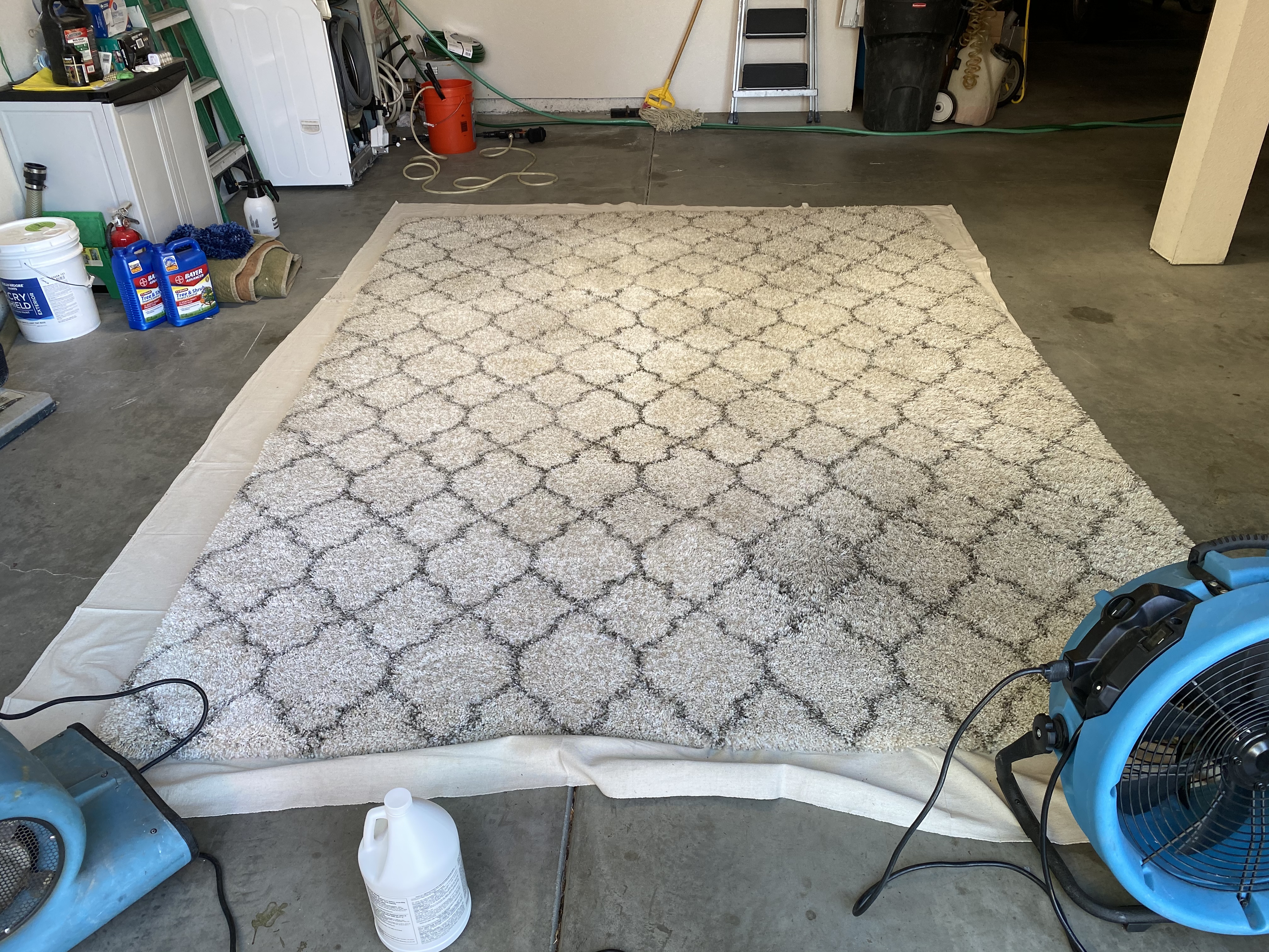

Well my crappy rug browning went away. But the dark areas are wear. These poly rugs really are shit.

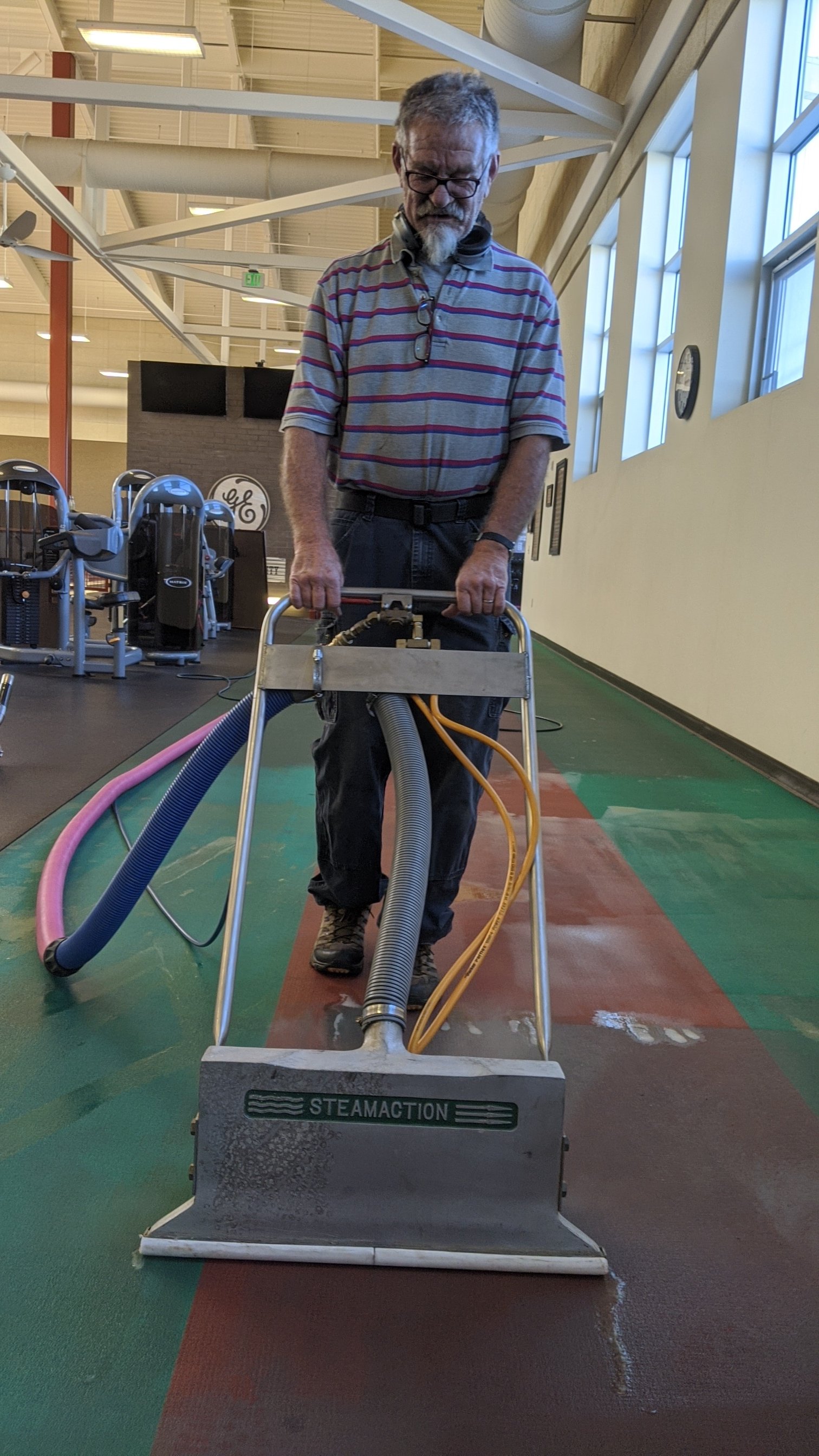

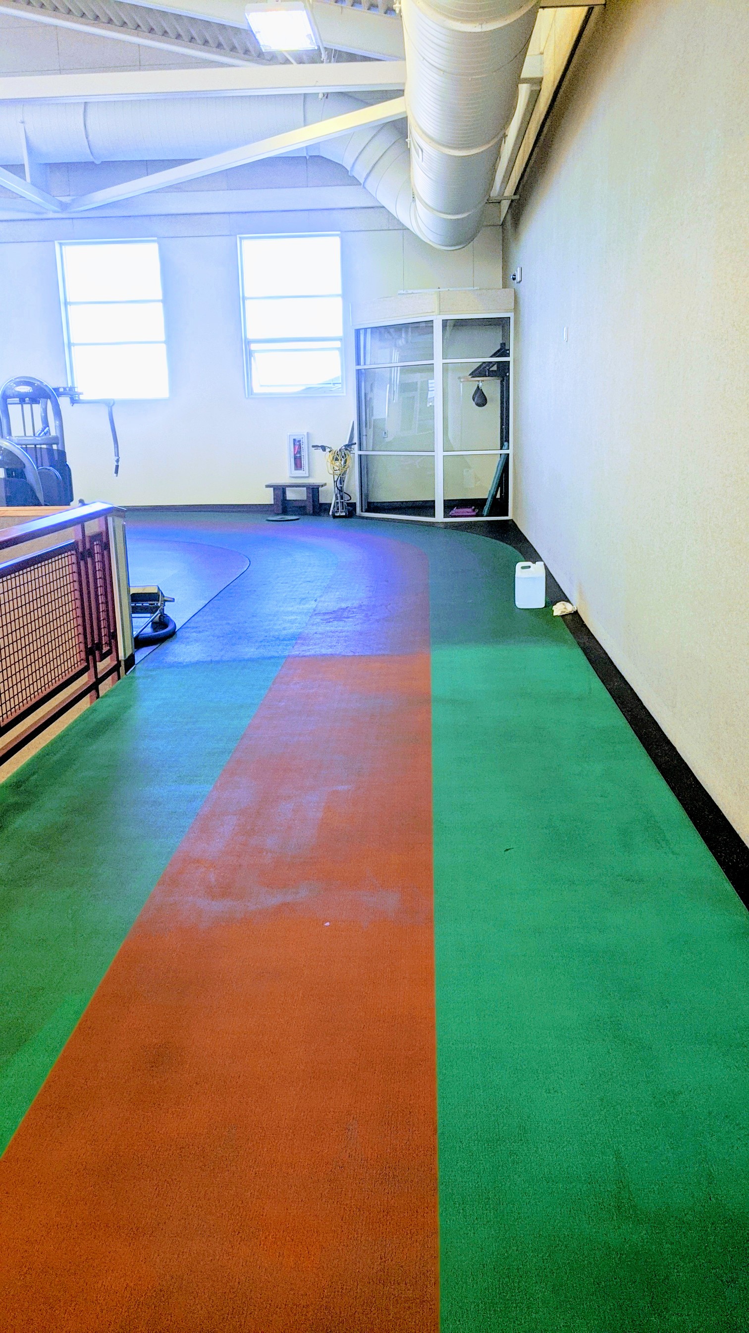

Who knew rubber could wick so bad, or rather it's foam core..
Today we tested the following:
mega strong Tsunami.
MST with a stripper boost.
Just stripper.
SPP pad.
Groves cut into a Green pad.
360i BH.
Drag wand to speed up rinsing.
All for naught.
The winning formula is a high pH encap with a d'limo boost and rinsing every 75 to 100 feet before it starts to dry
Than a post o'Pad w/ ammonia follow up the next day to remove the wicking
