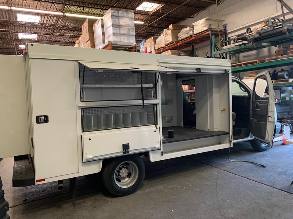

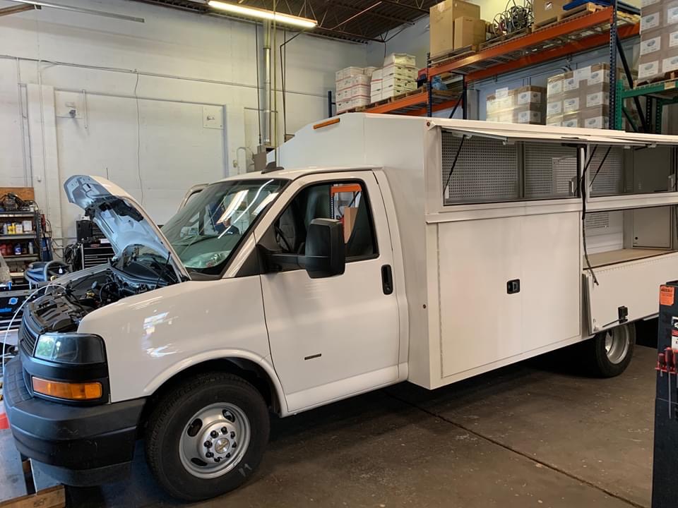

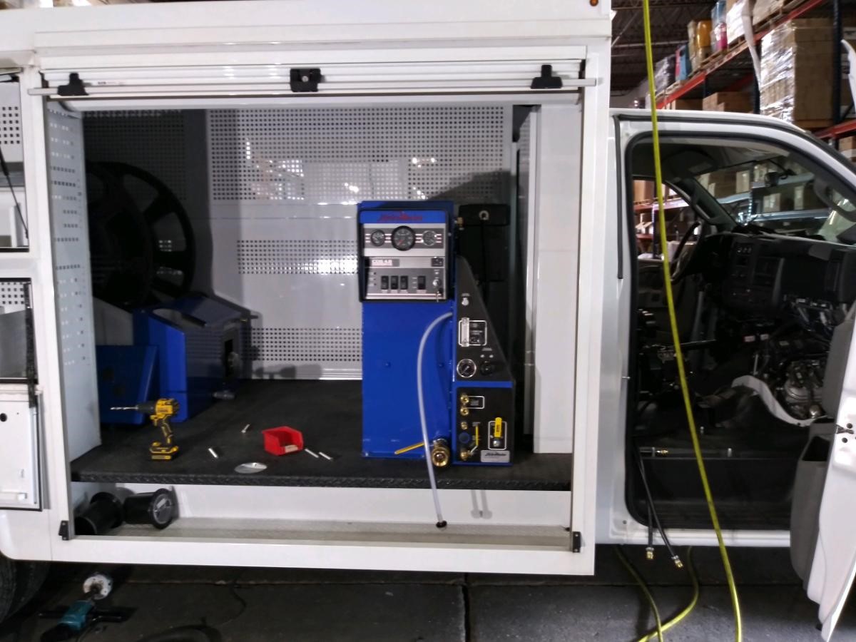

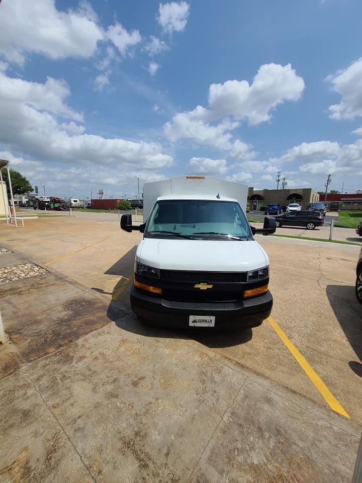

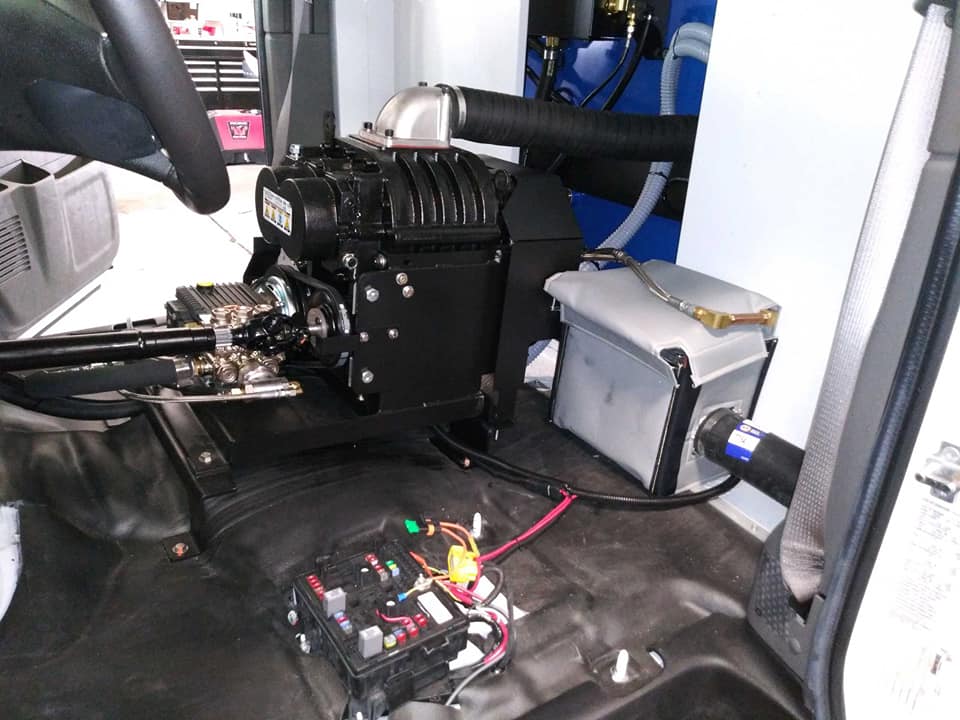

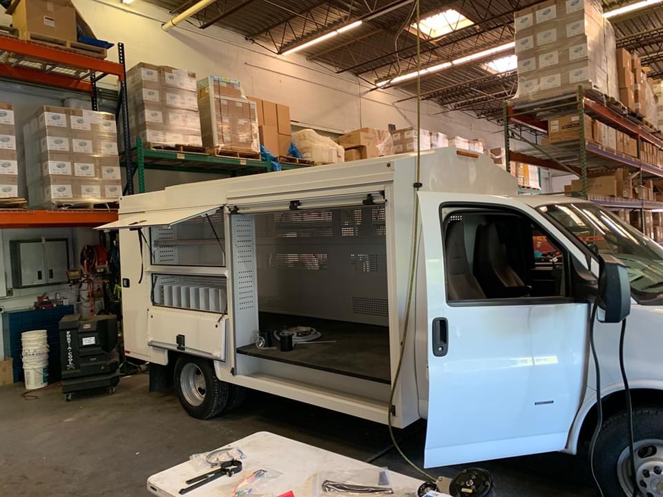

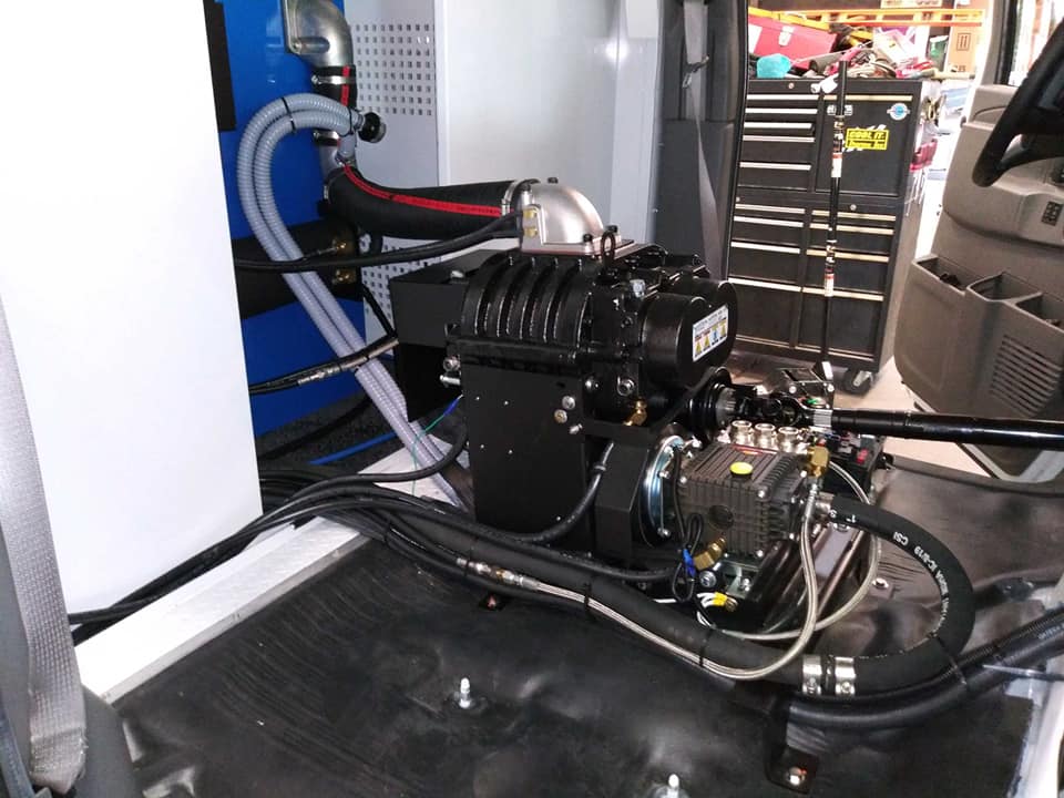

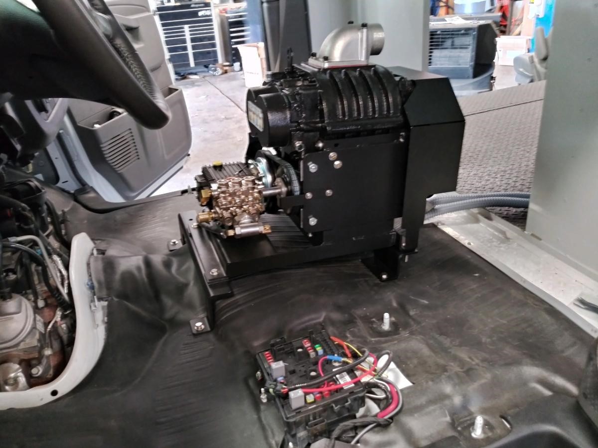

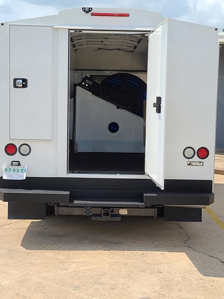

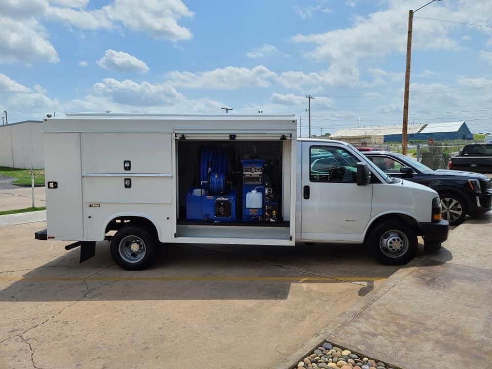

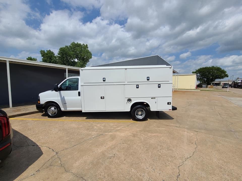

Hey guys,
I’m in the process of getting my new truck set up. Wanted to post the process on here. I’m always up for suggestions on different tweaks and ways to improve it. Thanks guys

Those Gorilla units are so sweet. I would love to have one but I don't think it would work well in the cold climate?

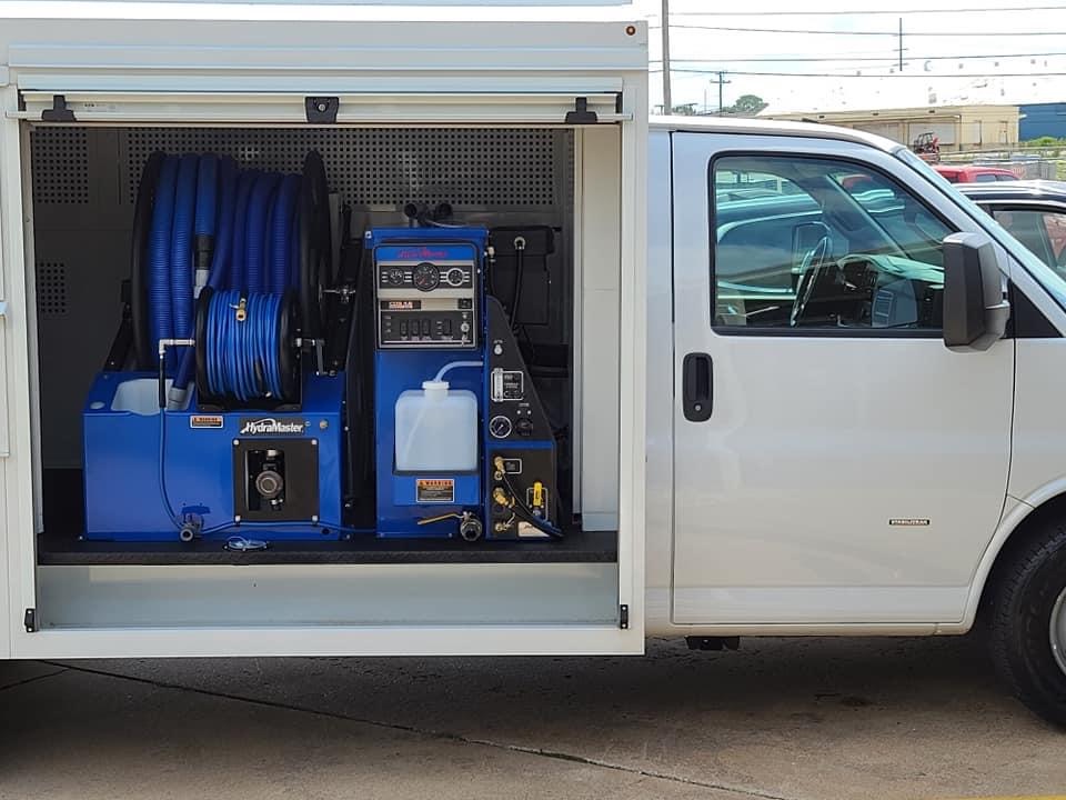

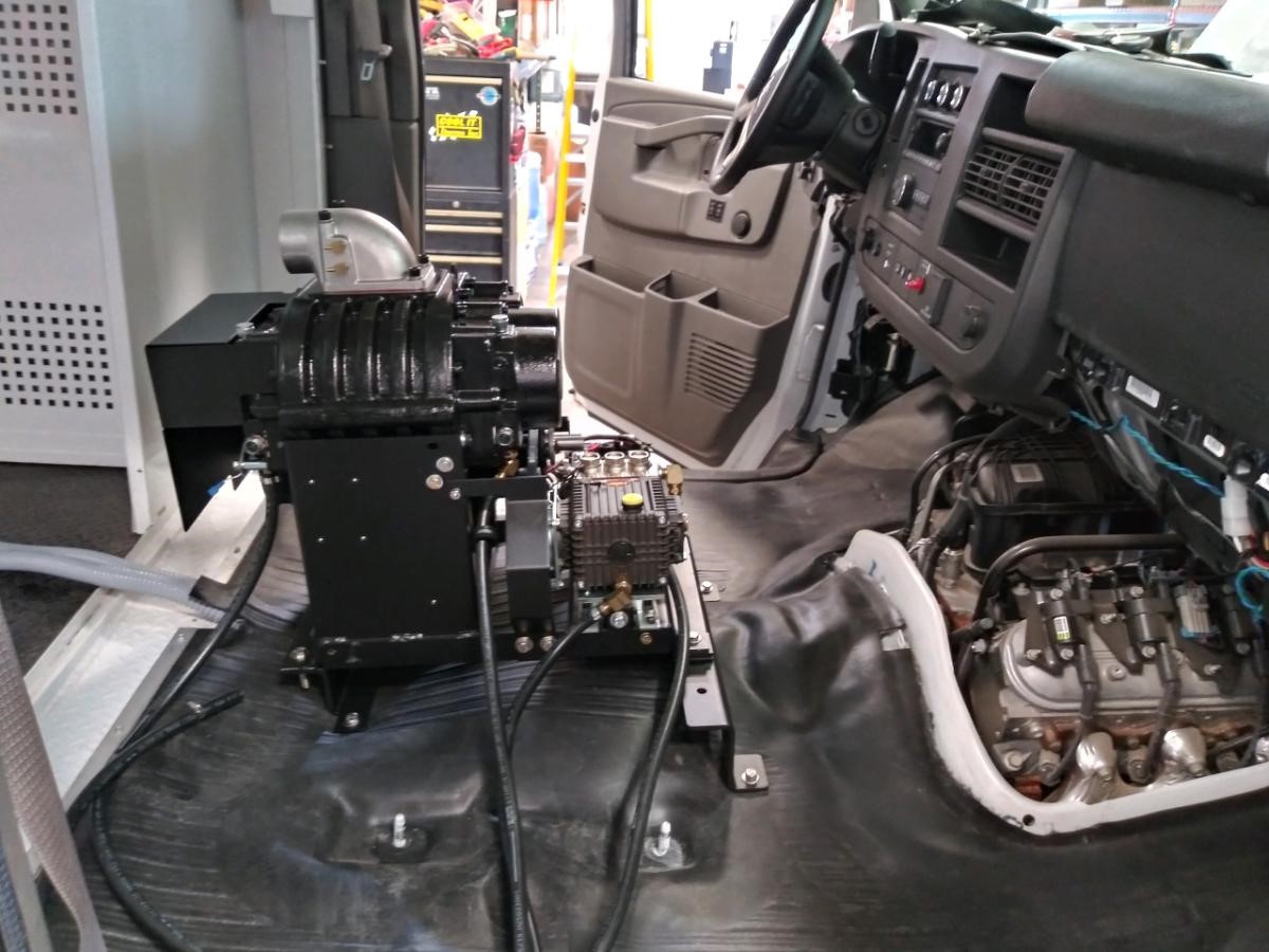

Remember: Form follows Function. Don't let the box dictate the layout.
The things you need to touch most often should be within easy reach of the place you need to use them. I see many HORRIBLE truck layouts that defy ergonomics.
Lee Stockwell
FOJL
Cleaning Professional
18,851
Lee Stockwell

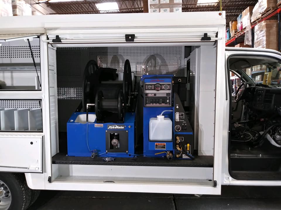

As an example of a great layout, a recent picture of a Stanley truck. First thing you notice: "where's the machine", that thing most put front and center dominating most layouts? Everything is thoughtfully positioned for seamless operation by a 2 person crew.

Man that will be a great truck.

I would put job to job used stuff on passenger side. Ya know so you can get quick glance of unit.
Less used up behind driver's side.
But you know your client base on how you park the most.
Just don't jump in there in a hurry and put it together.
Machine will go where it has to go.
I had a payotee sandwich and stared at my empty Promaster for hours before drilling holes.
I think the remote control panel helps with that a lot... I’m not sure how many units on the market have that ability. I though most of the time, the controls are on the unit themselves.

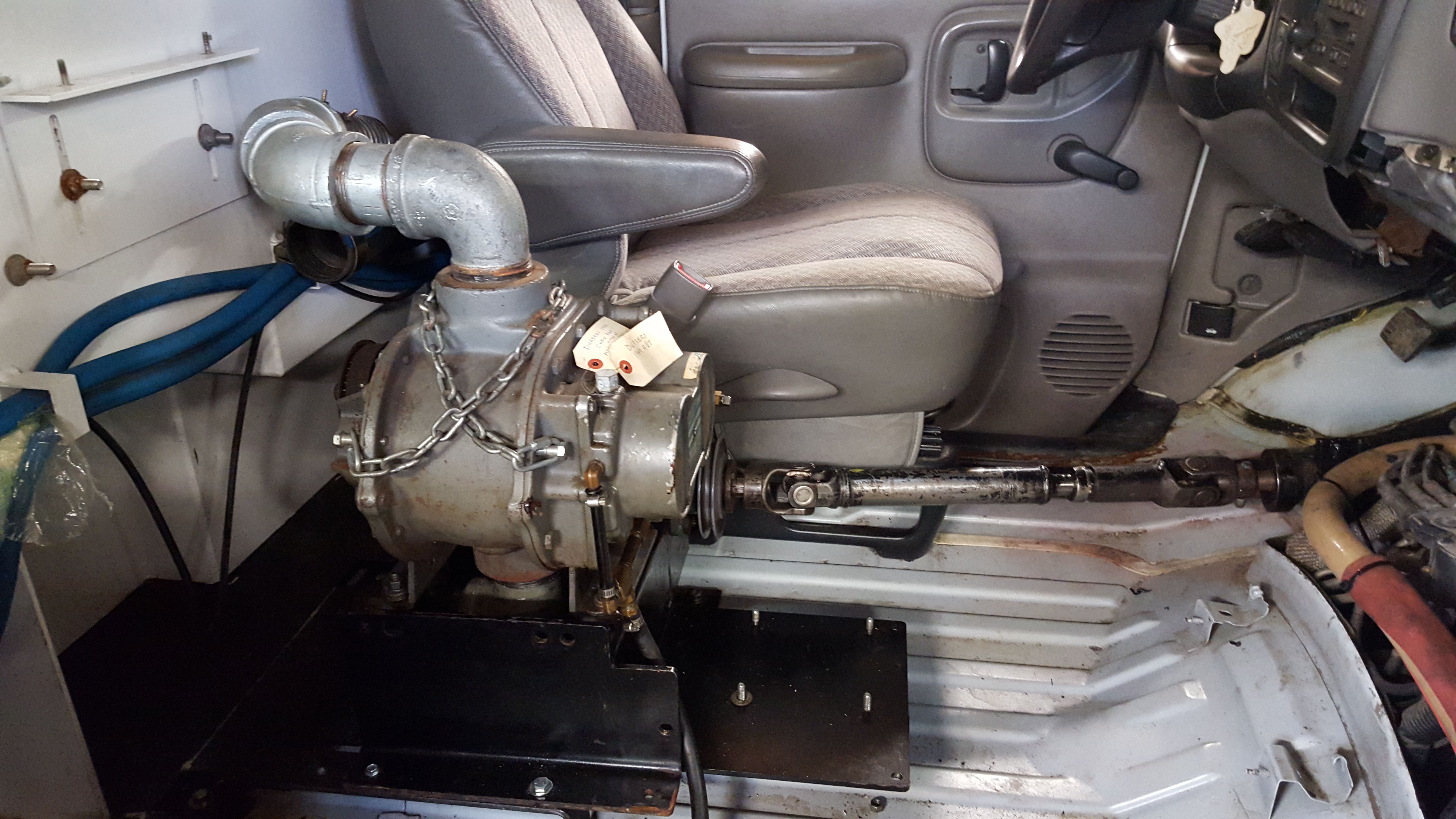

That's a great layout for the blower/pump combo. Looks like a one piece driveshaft? I would have asked about eliminating the front flooring to minimize rust prone areas under the drivers and passengers feet.
That is the same positioning as my AquaTech Spacesaver vans.

I would be concerned about enough heat getting to the box to prevent freezing in cold climates when driving from job to job. I have seen in vans where they have installed a rear heater running off the vehicles cooling system. I wonder if that would be practical for that one?
