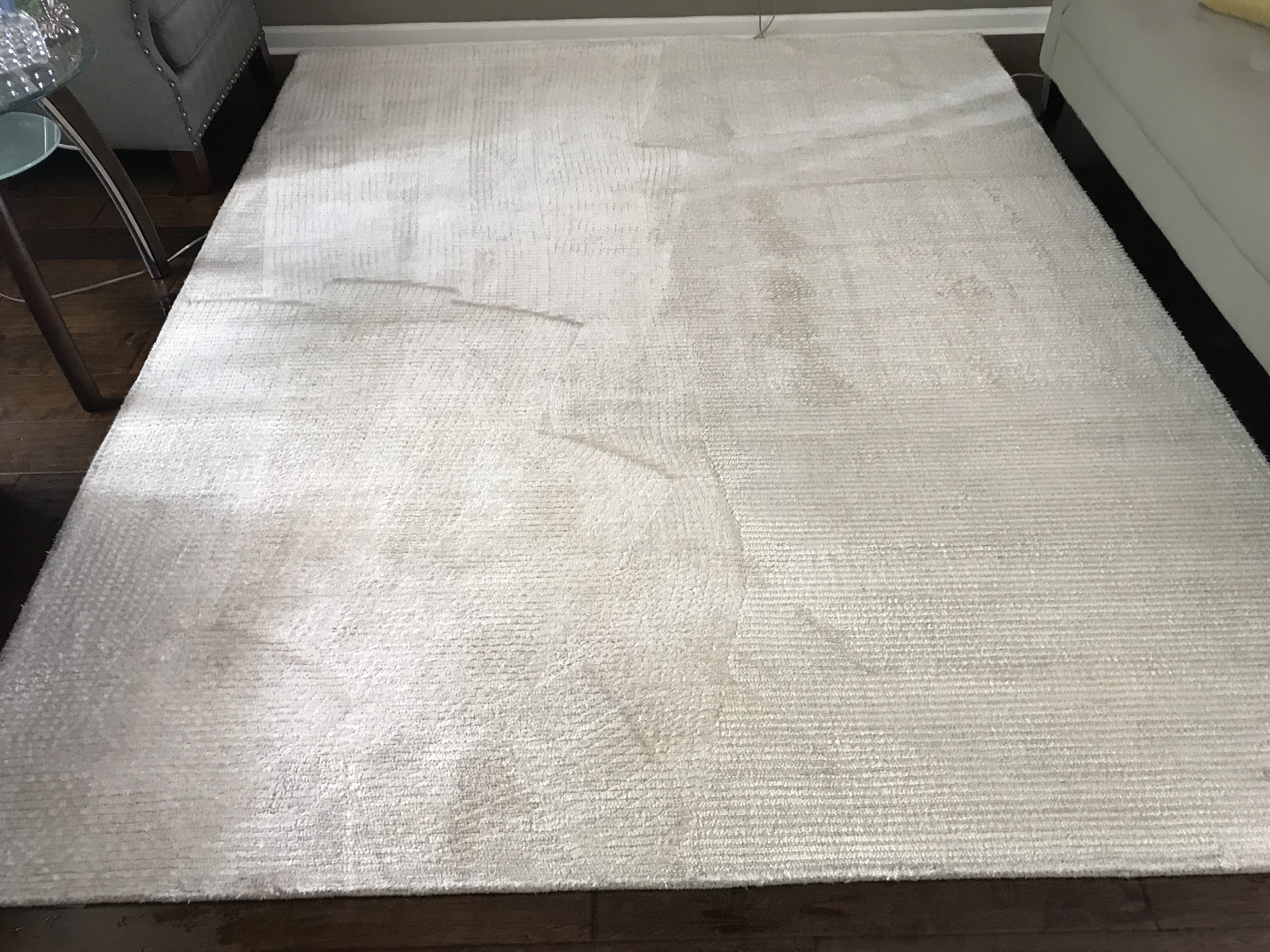

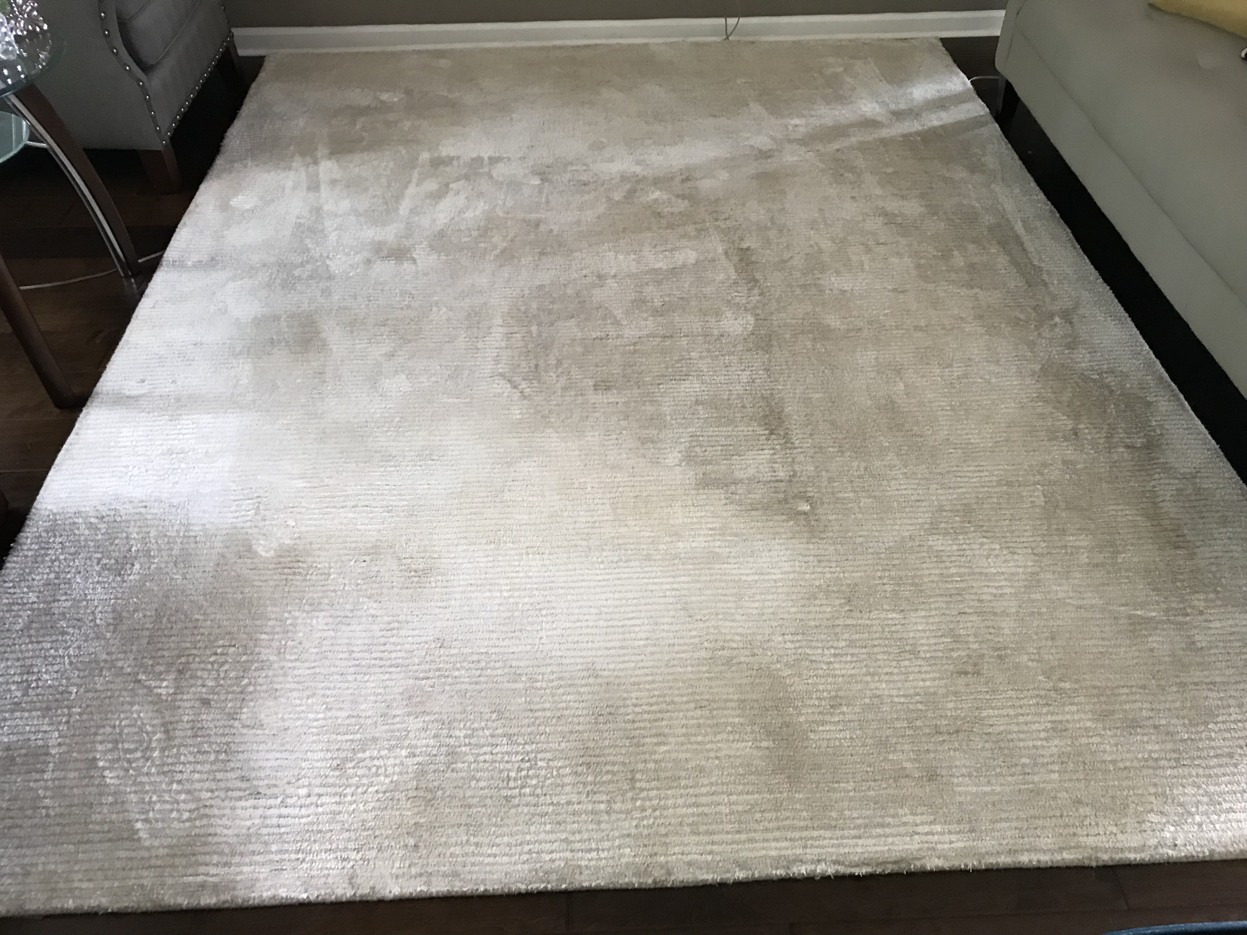

Some of you guys do take it to serious.
Viscose rug today. Code red and Deep Blue. 220 degree water.
