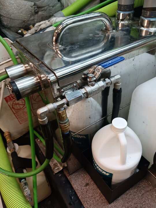

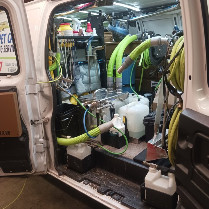

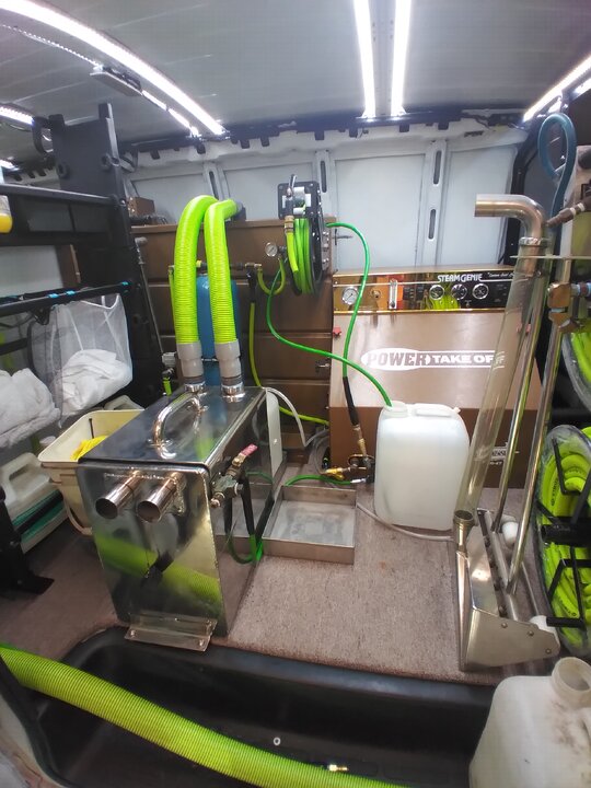

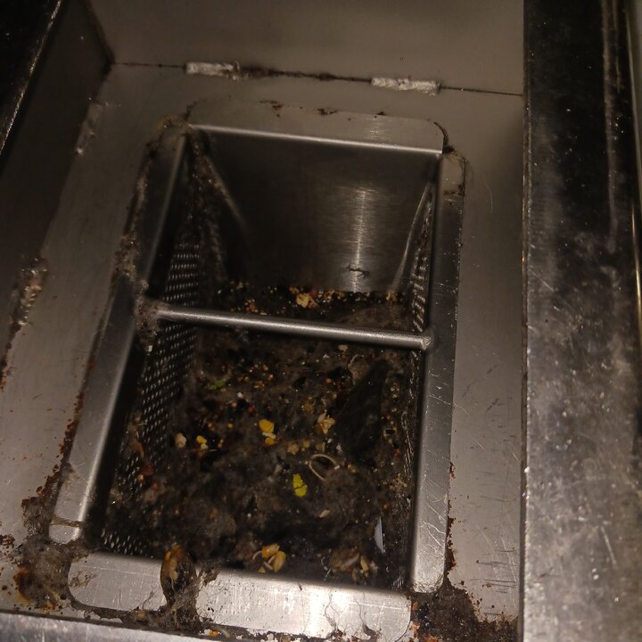

I use a custom stainless version of the old prochem filter box i had fabed up. The prochem version had a single 3" hose coming from the wastetank to the back of the filter box. My wastetank is setup with 2-2" in so when i had these built i set um up for 2-2" in & out they (i had 3 built) designed to use a standard prochem filter basket to save money ( it would have doubled the price if i had to make the baskets) when all was said and done i think i spent about 50.00 less to build these htan buying off the shelf prochem units . I had originally bought a prochem unit and modified it but because it was made of aluminum it had seriously been eaten up from the chemicals. The units i have now are 20 or so years old and still look and function like new. Only downside is that it does consume floor space
View attachment 131507 View attachment 131508 View attachment 131509 View attachment 131510 View attachment 131511 View attachment 131512 View attachment 131513
Thanks for the pics and info. Nice setup!

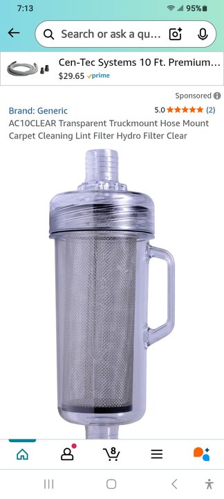

You're welcome. Heres a thought. Before i bought the original prochem filter i used these inexpensive inline filters and had really good luck with them way way way back then they had a hindged lid with a spring loaded latch instead of what appear to be a screw on end the spring latch and plastic hinges were the units weak points. They don't hold alot but they're inexpensive, light, don't take up much space and do a great job of filtering Amazon has um for 170.00
View attachment 131516 View attachment 131517
Those work great for filtering my water when I drain the recovery tank.
