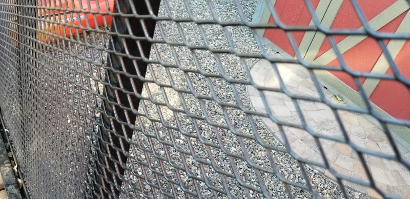

Ok, what would you do? My marine carpet idea, or Mikey's metal idea and cuss him out if you bust your ass
Cut out the old diamond plate and weld in the grated stuff so you don't raise the step any higher and it will be a cleaner look.
