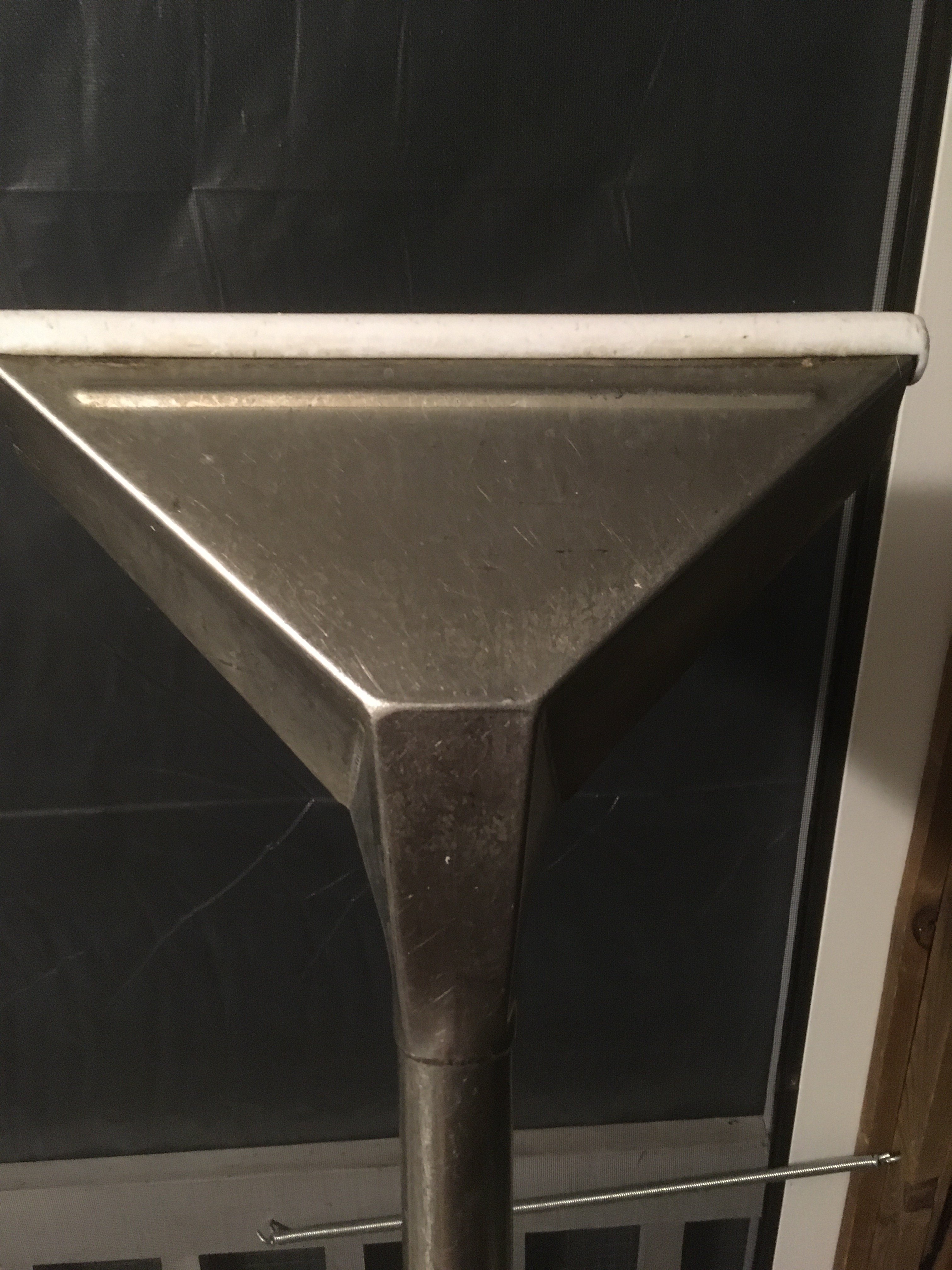

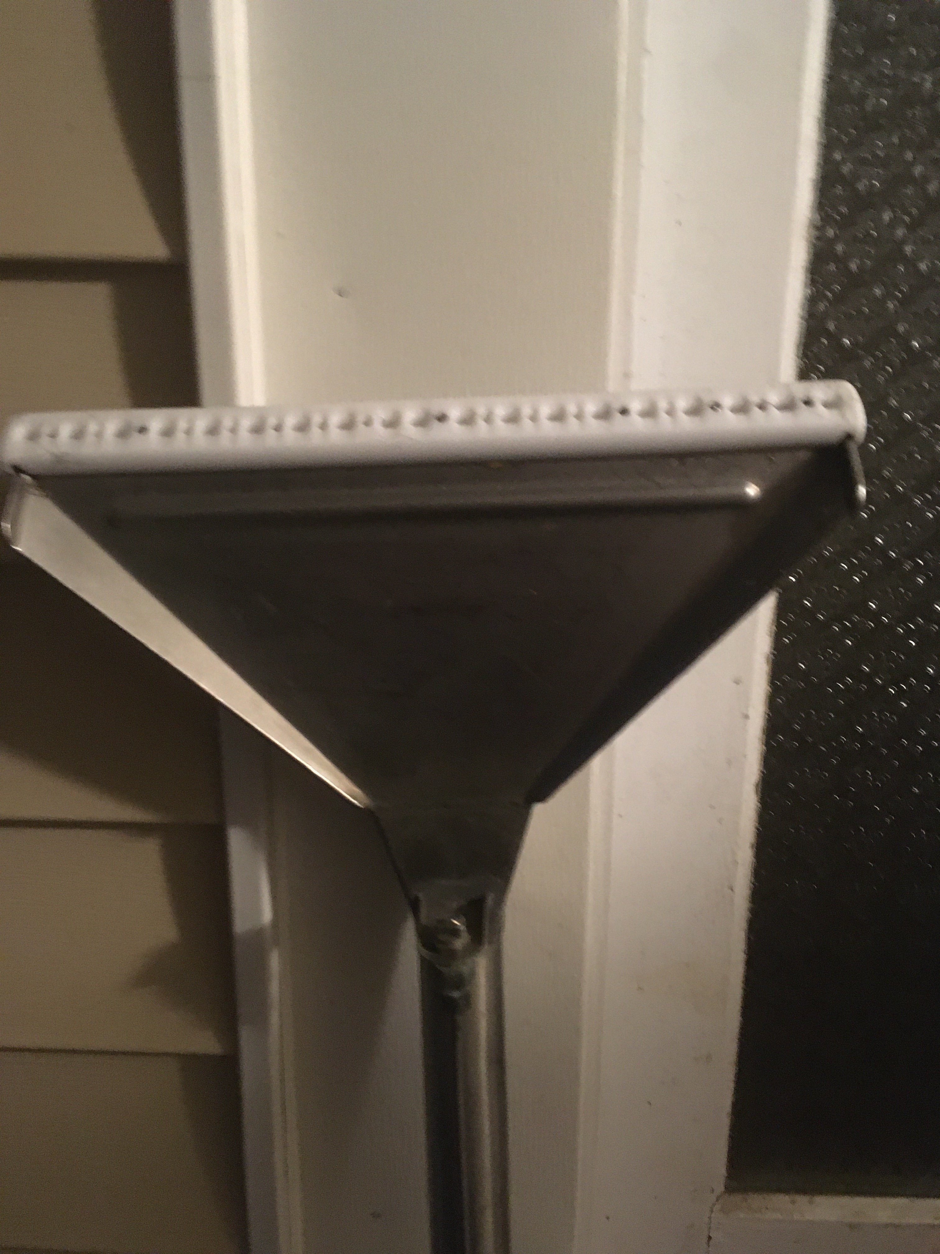

I do. I've been ordering Greenglides for 18 years from Lisa. This is actually what they call the "look a like" Hydrahoe made by PMF. The external is a perfect fit. I've never tried the internal one but I would be glad to give it a try.View attachment 113611View attachment 113612
The PMF wand is still in production and is actually the exact same wand.
Hydromaster discontinued it a while back in favor of their Evolution line.
I sell mostly internals as they help keep the older HM wands from pinching shut, the PMF version has a support pin in the middle which does the same thing.
