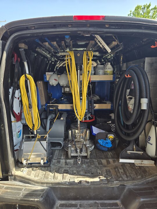

I'm glad I have the CDS with the Hydracradle, otherwise I have no idea how I'd fit all my stuff in the van. I don't know how to clean carpets and furniture well without a million things. I have a big commercial job today so we brought the 175, otherwise that normally stays at home.
I think I need to purchase every small tool, gadget, and doo-dad so I don't have to transfer everything from my van to my trailer and vice versa when one setup goes down. So much stuff.. I don't mind transfering big stuff like air movers, vacuum, wands, etc... but all the chemistry and small stuff is too much!

You need to bring just what you need for the job or the day. I see a lot of carpet cleaners with their vans full of tools that they never use because it's too hard to get at them. I often find myself coming back to the shop to dump a tool and pick up a new one. Easier than cramming it all in.

What about add-ons? Or unexpectedly tough to clean situations? Most of my jobs are 45 minutes round trip or more to drop off or pickup any tools from my home...

I usually bring a vacuum and a CRB. I have my main prespray already made up in a couple of on-line sprayers. I have a few different chemical options on the shelf in the van as well as a pump up sprayer. 2 wands and upholstery tools, that's about all I need.

Hose management comes with experience. I never put my pressure hose on a reel. My main hose is 125 feet and I coil it and hang it in the van. On the job, I take that coil along with the in-line sprayer to the furthest part of the job and lay out the hose back to the truck. Often, that all the hose I need for residential. Vacuum hose is on a reel but I peel off the first section, which is 50 feet of regular 2 inch, with a whip of 2 inch really soft hose, most often followed by a 10 foot whip of 1.5 inch hose. I coil it on the ground, detach it from the rest of the hoses, carry it in and lay it out the same way I did the pressure hose. After I presprayed of course. While your working, take the time to keep your hoses straight and pull them back to the truck as you can. Once you're used to it, it's much easier than a portable.
