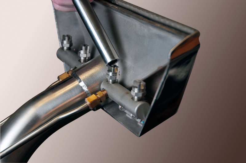

27,889
The new Gekko wand is pretty nice, has a swivel, new manifolds and got rid of the cheesy little connectors and replaced them with proper qc's. Squeegee head for portables/brush head for TM's

14,166
Those jets look like they're hard to access for any service that needs to be done on them. WAs that just a complicated shadow I'm looking at or is it a tight fit for the socket to remove them?

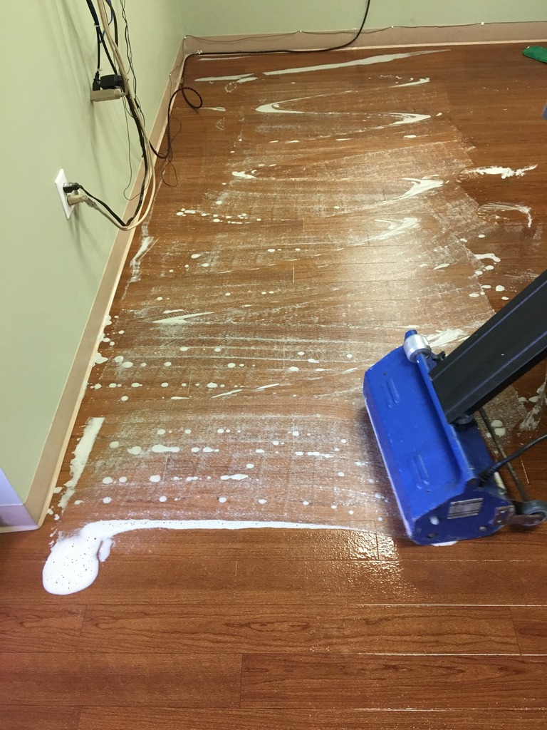

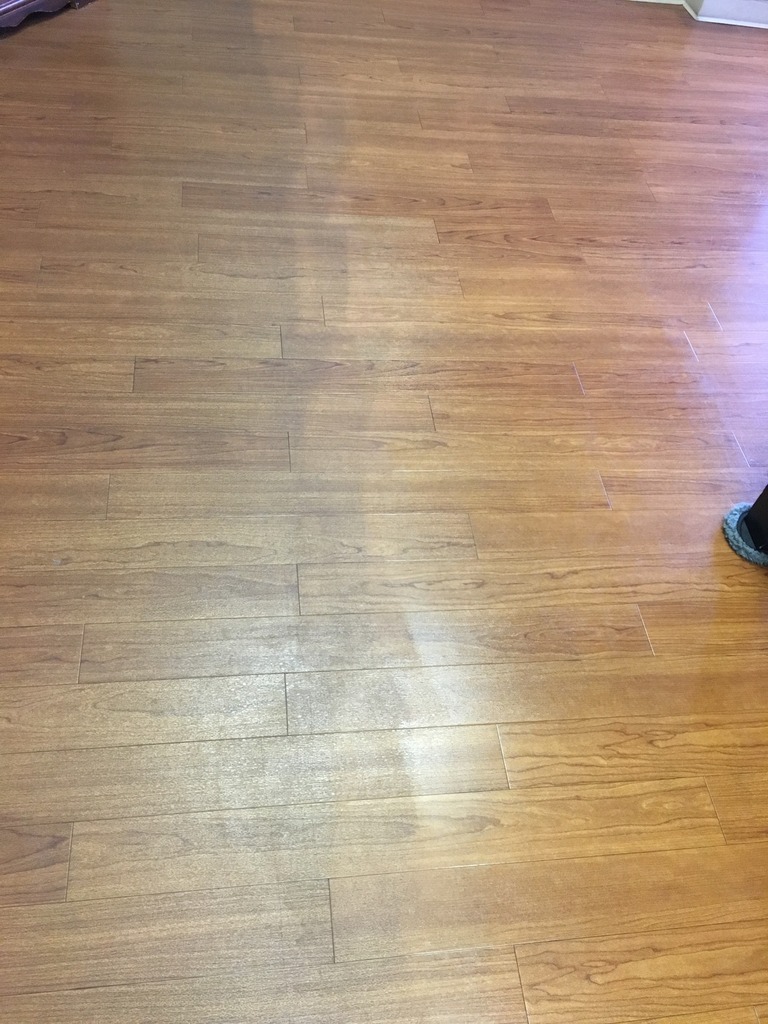

If you have a laminate cleaning procedure, it should work to clean the construction dust.
These photos are from a job where the vinyl had a texture to it. I hope the previous cleanings with a black pad did not ruin it.
We used only flat mops for extraction. A CRB is the right tool for this type of job.
